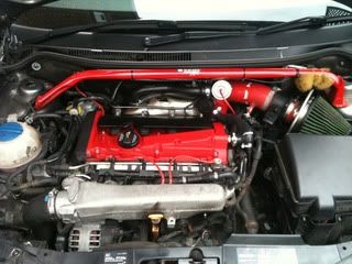

what vacuum pipe do i T into :S very confused... mate said bout one running on top of engine.. bt nt so sure.. what best one for 20v T cheers
bolton
any chance u could post a picture mate?? as long is works i dnt mind lol
I no longer have the car but if you know where ur DV is on ur car (underneath the top right hand side of your engine cover).... u will see a black vac line coming of it....snip it and tee it. simmplesss.
Unless someone else can suggest something else i always found this to be easiest route.

aaa yea i fort that was the DV but mate (mechanic) said was a non return valve.. is it well obv on top of engine coming of induction pipe? sz am bit of a novis lol

well its technical name is diverter valve...but yeah thats the one thats pluged into your turbo intake pipe.
Dont worry so was i when i bought my 1st 20vt....still am to be honest but months of searching on here and u will soon make sense of it all :)

donee cheers for help, have just wedged it in ash tray area atm ordered single din plate of ebay, all working running at 9/10psi.. 007p diverter next week thn want a remap asap!!
