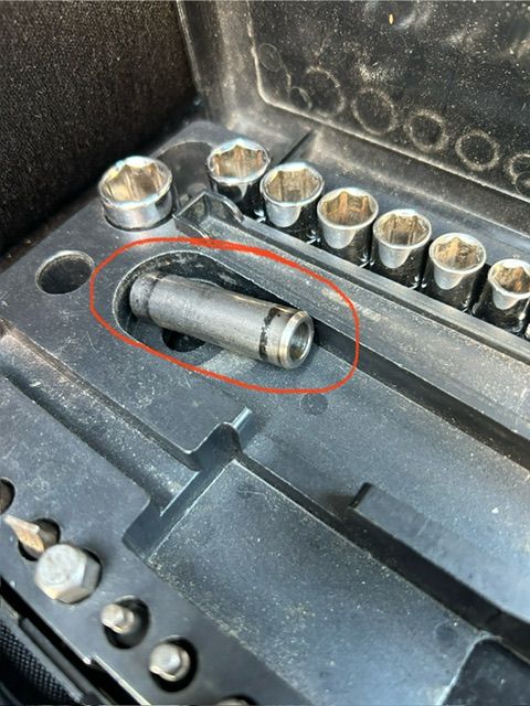

I’m putting the lower dash back and just discovered this in the tool box!! It should have gone back into the pedal before installation. But Everything feels ok now. Not sure I can be bothered to fit it. 🙈
I wonder whether it would be an issue??!?
Oh ****! That's the bushing, needs to be fitted really or pedal is going to slop around and probably wear were the bolt is.

Yeah. I think you’re right. I f**ked up and now I take the punishment. I know what I’m doing now so should be a quicker job. Mk1 life!!

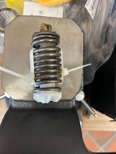

Link is in this thread (to Audi sport forum). It’s a good guide, but I found a couple of snags. As others have stated, I can’t see how you can get the spring back in without compressing it with tie wraps:
And the second issue is getting the pedal, white plastic and push rod all located and aligned. If it had an extra 5mm of clearance it would have been a doddle.
