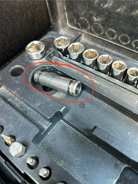

Success! New clutch pedal fitted. It has taken a good couple of hours trying different methods. In the end I went with the method described on the audi sport link above. It just took a lot of manipulation. I went with the tie wraps on the spring - that worked a treat. Absolute PITA job and I hope to never repeat it, though I expect I could do it in half the time next time.
And now for the sickener….
I’m putting the lower dash back and just discovered this in the tool box!! It should have gone back into the pedal before installation. But Everything feels ok now. Not sure I can be bothered to fit it. ?
I wonder whether it would be an issue??!?
