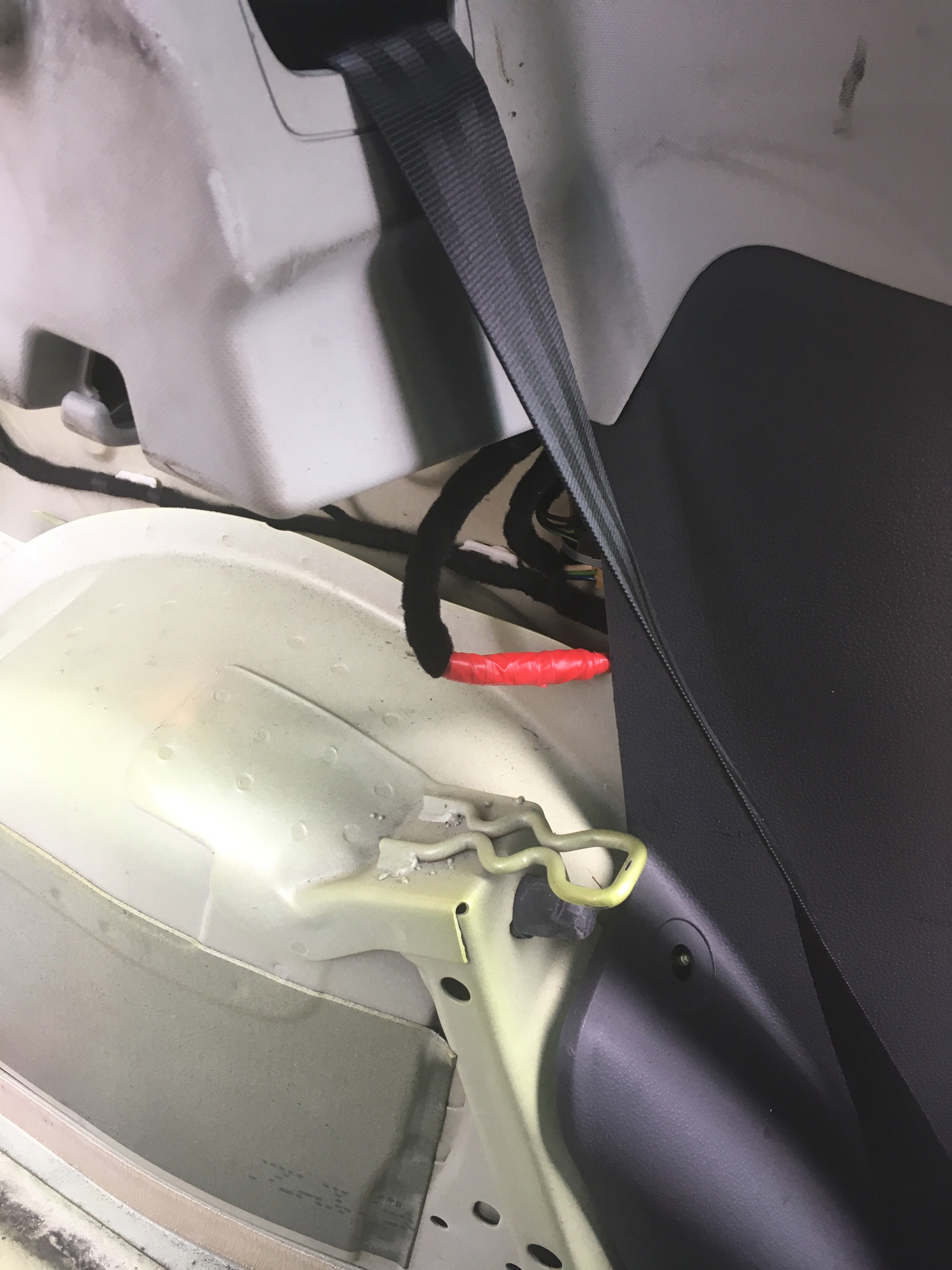

davidlesley
May 20, 2017
7
Just fixed rear washer.
Rear nearside wheel arch. Pop off the trim inside the boot.
Pipe had disconnected- water not reaching the rear screen- just running into rear wheel arch and dripping/running onto road.
