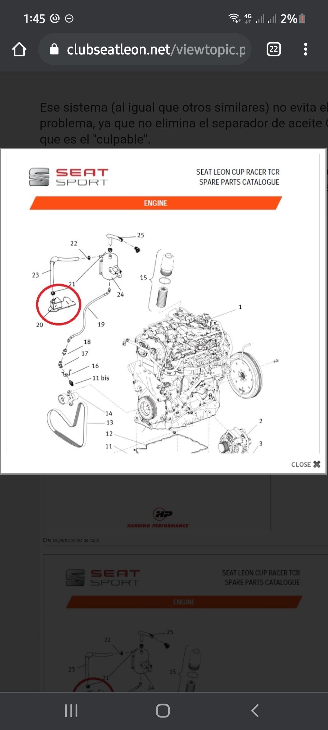

Fer16v
Feb 2, 2020
65
18
Spain
Ok guys. So most of pros and no issues known by the moment. Cool. So just ordered! Seat Sport has a kit that sell through their own sport department, but as far as i know is sooo simillar to VWR and quite pricey.
