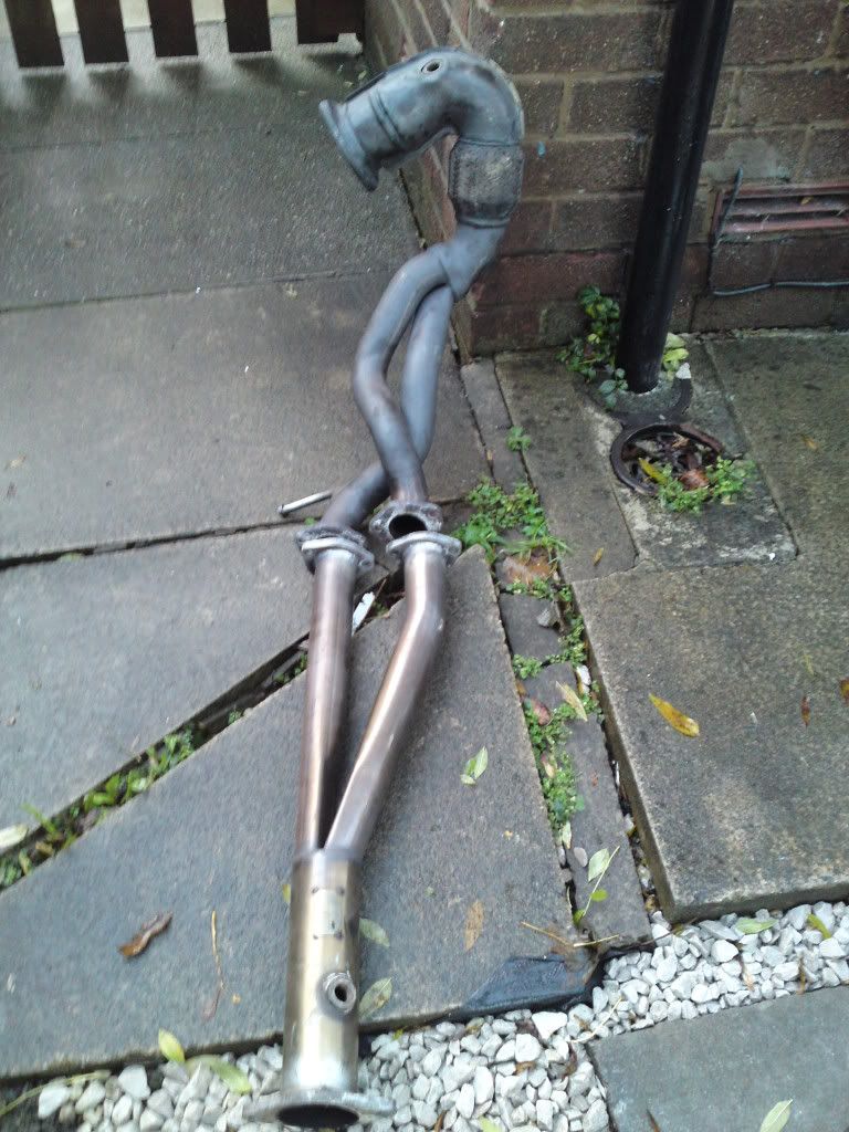

This is my old OEM dp And Scorpion De-cat setup theres a massive difference in the 2...
Same downpipe and decat section of the exhaust that I have, can't wait to get my 3" downpipe and decat, should make a nice difference :)

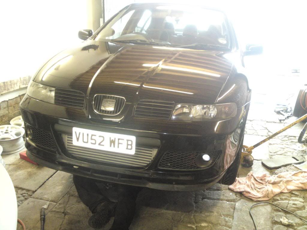

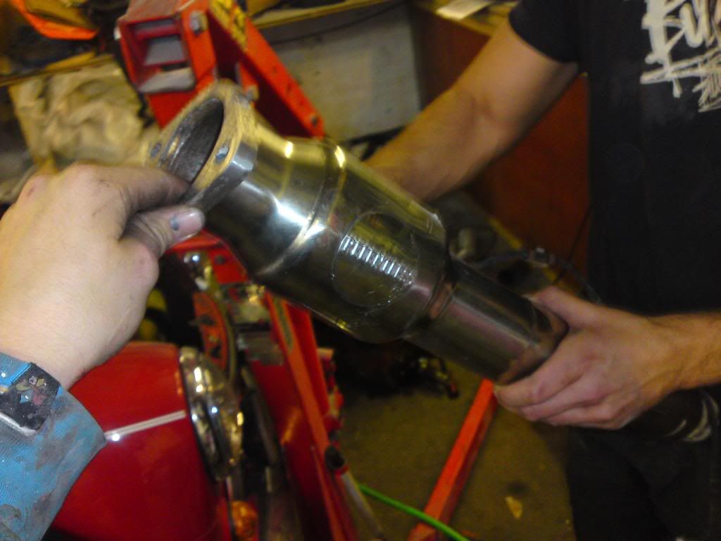

After id done the gardening lol i was bored so popped over to my mates unit to have my Tyre checked anyway 4hrs past and the result was this..
It feels even more better now but i can feel that all mods are making it slower....But the noise is immense from it i mean pops & Spits on so little rev i love it....I also got £44 For the cat insides lol..

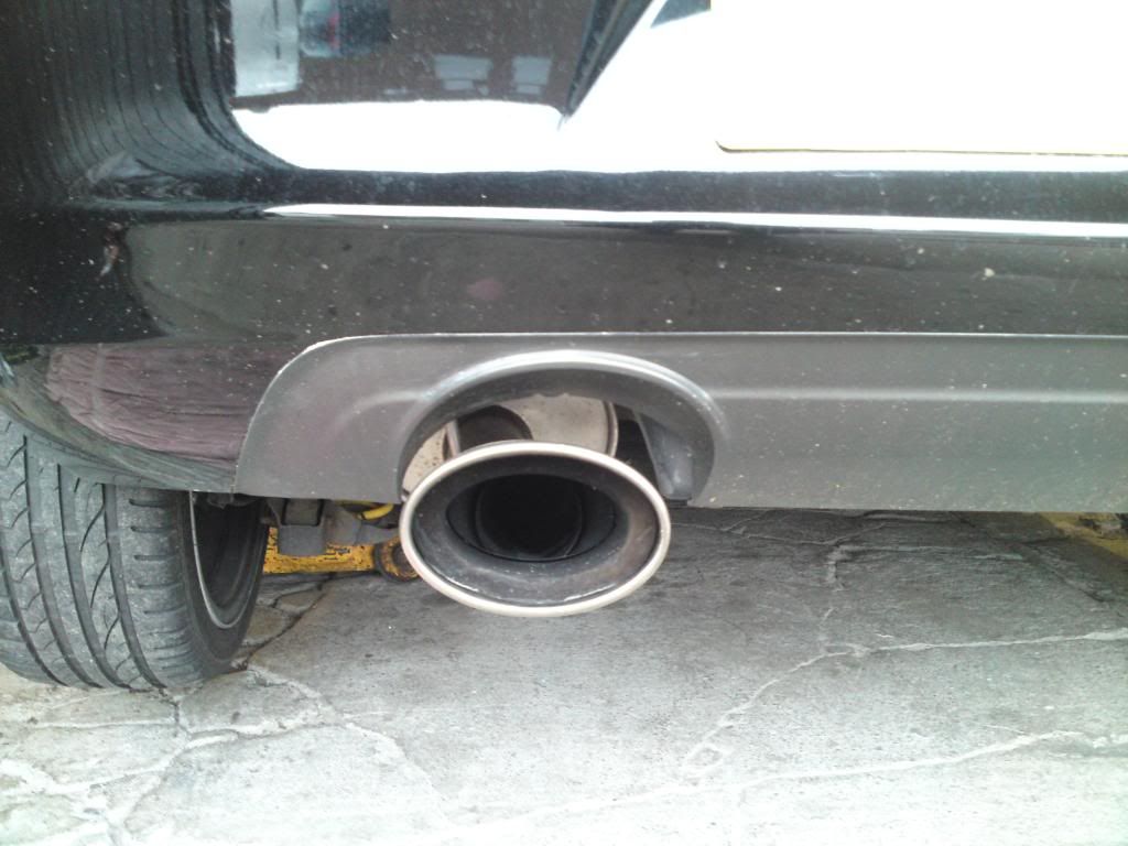

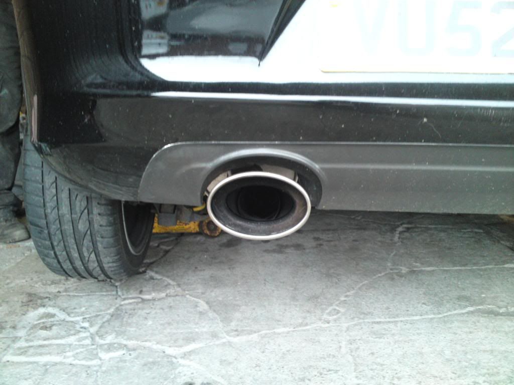

And we sorted the tail pipe out along with re-fitting my rear spacers...
Before:
Aftere:
Its getting there slowly..

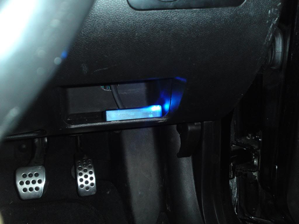

Wot box Is all wired up And Working I just need a new Clutch Sensor which as the signal is too weak for the box to pick up...but everything is done...
My W.O.T Box Kill time shift is set @ 175ms And my 2-step launch control is set @ 3000rpm With 10psi Build of the line...
Also this is the reason why you put it out of the way the LED is way to bright..
there 6 wires in total 3 in the engine bay and 3 in the cabin took around 1hr to wirer them all up but we'd had done it before ...
There no need for the switch tbh as were the cubby hole is you can just press the button to just simply turn it off..
