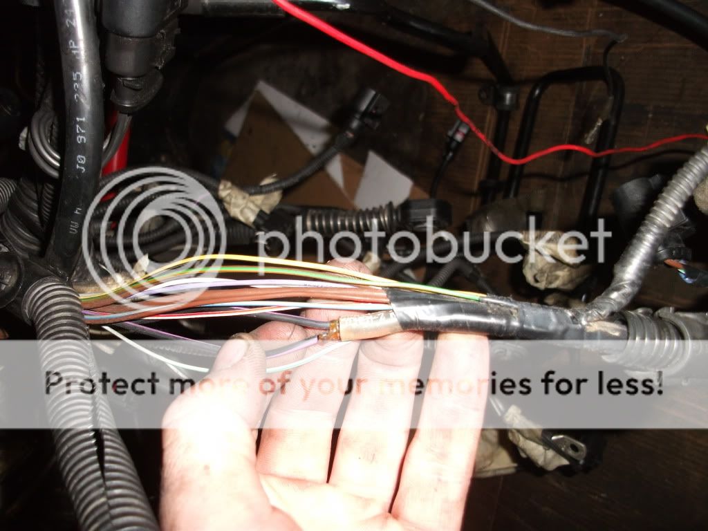

is it the wire i have my thumb on mate, ?? was going to call earlier but signals crap in the workshop :(

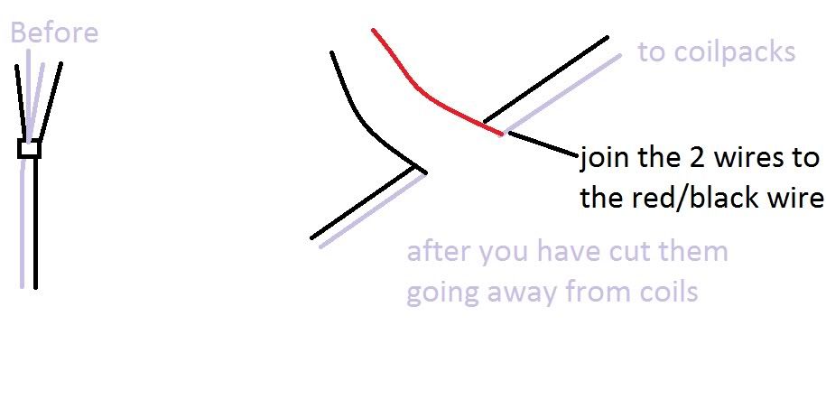

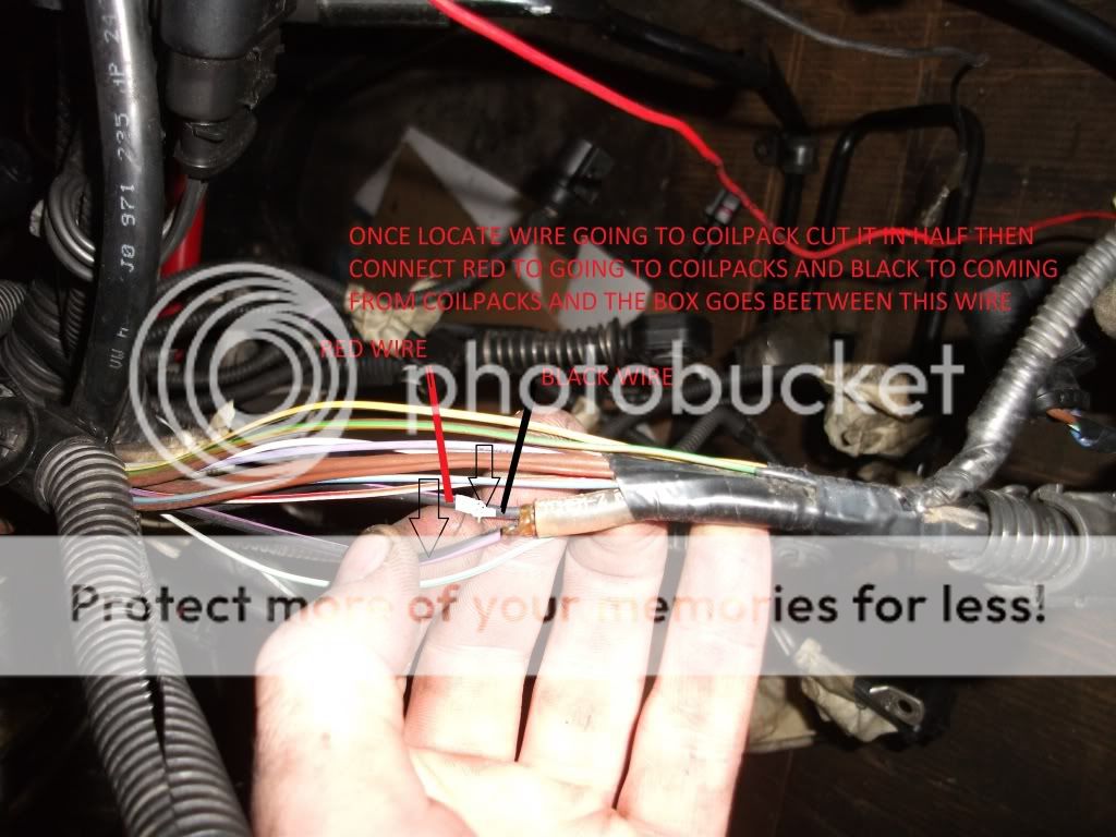

On the instruction it will say which colour wire goes to & from the coilpacks...basically it means wen u cut the 2 wires which are both violet and black which then intale in to 4 wires...the ones going to the coilpacks are joined up to the red/black wires and the ones going away from the coilpacks basically going down in the loom/engine bay you match the wires to like this..
I did a **** drawing.
ok mate cheers will have another go lol, so that wire i cut i dont reconnect and in theory the box goes beetween the 2 wires.
the red goes to the 2 wires i cut closest to coil pack and the black goes to the other side of the wires i cut
the violet / black wire doesnt get reconected? the red and black make the circuit??
thank i got it lol,
NNNNOOOOOO LMFAO
wen u cut the 2 black/voilet wires they then turn in to 4 wires dont they.....u put 2 on the black one and then 2 on the red one...
and what it means of going to and from the coilpacks is wen u cut the wires in half u have a left and a right one dont u...
the right one....GOING to the coilpacks is the red/black one and the other side eg LEFT which is going away from the coilpacks as u have just cut them,,,,,goes to the black or red....
