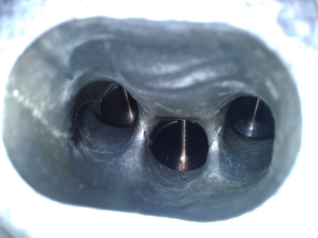

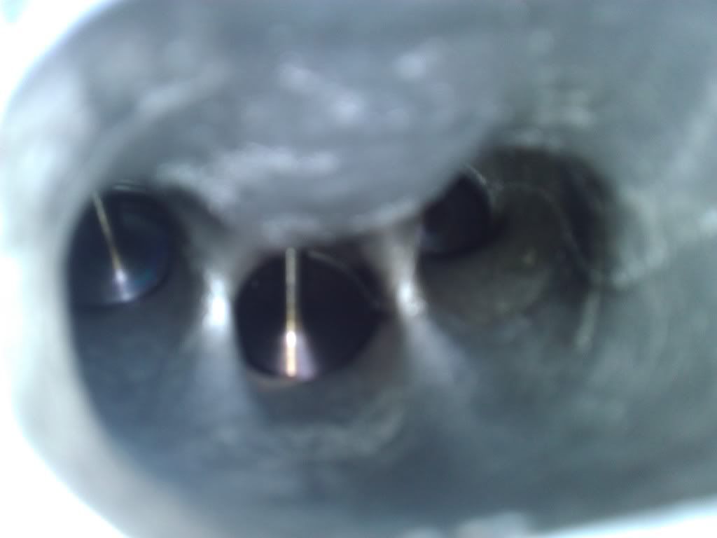

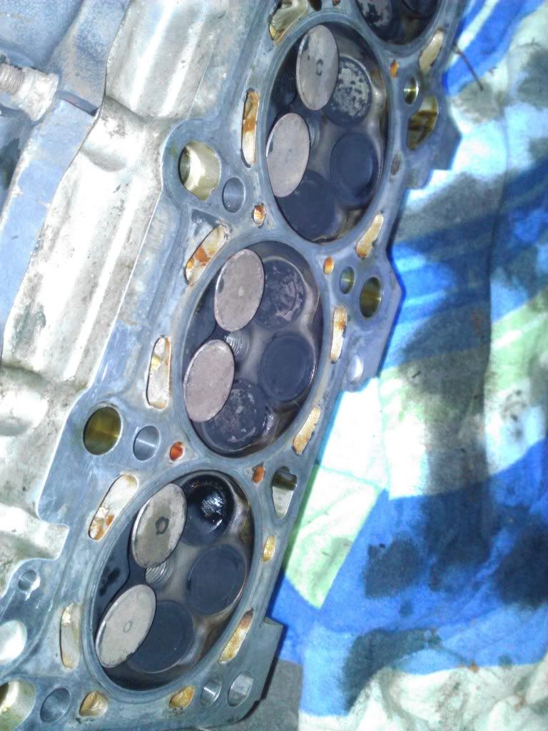

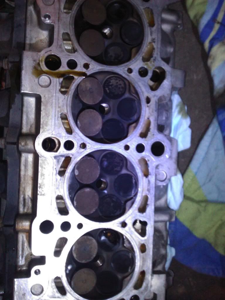

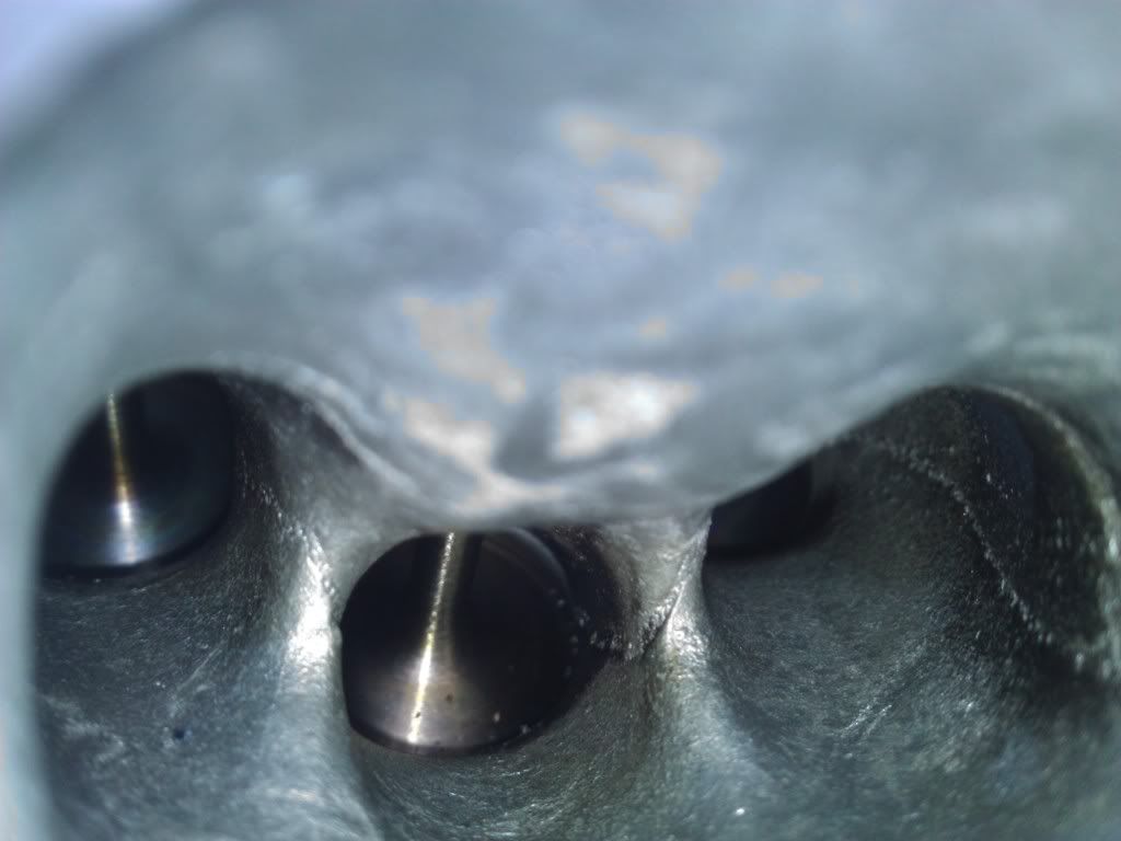

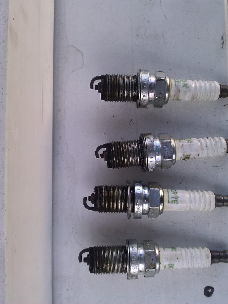

I took the inlet manifold off to give it some powdercoating and the same with the alternator and Rocker cover to freshen a few things up...So while looking down the inlet ports all 12 valves are straight and In tacked From Looking outside at it...So thats abit of good luck plus i wipped the Plugs out to see if they been smashed to ****ing peices and nope still good as new as when i put them in 7months ago...
Strange to say the least just the 8 exhaust valves to look at but things do seem promising as i think i havent dropped a valve...

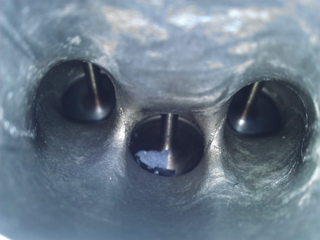

Dont want to sound like a merchant of doom but the middle valve in the first pic looks like theres a bit missing ?
Its ok thats abit of my flaked Paint of the inlet....

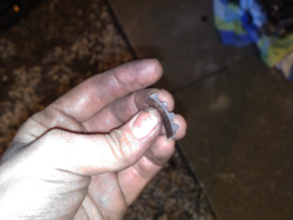

As promised took head off and timing belt and found a 8" long snap-on Allen key wedged between block and bottom timing belt crank pulley which has took the teeth of in chunks....
I'm pissed to say the least.....o and 1 bent inlet valve on cylinder one...pictures to follow .

Start to finish took around 25-30mins also my coated ina manifold is as new as when I got it 1,250 miles in.......
I'm going to strip the pulley off and inspect any more damage around the crank bolt I'm guessing hopefully none..but there seems to be abit of metal down there from the pulley jolt...

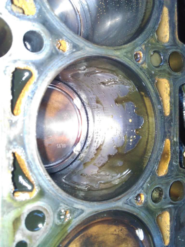

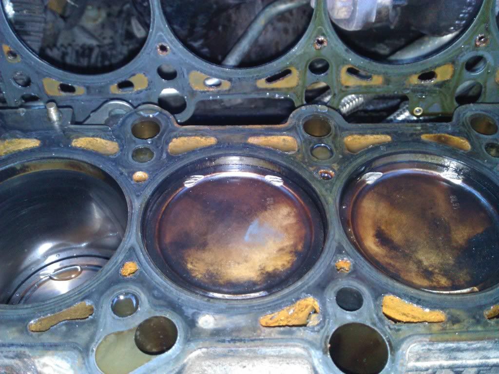

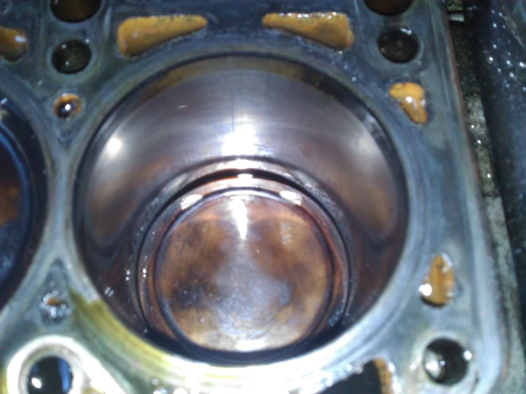

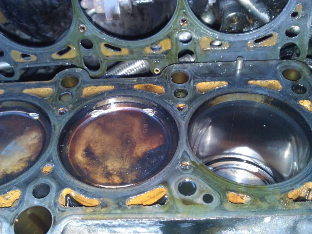

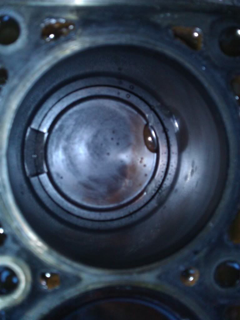

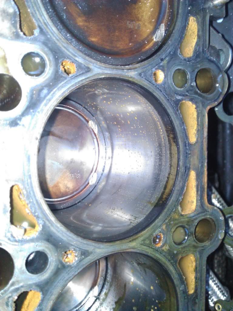

The Bottoms Moves and feels fine and the top decks are still even...Bores are as they should be and the piston have some very small light marks on top...Which John said should be fine...

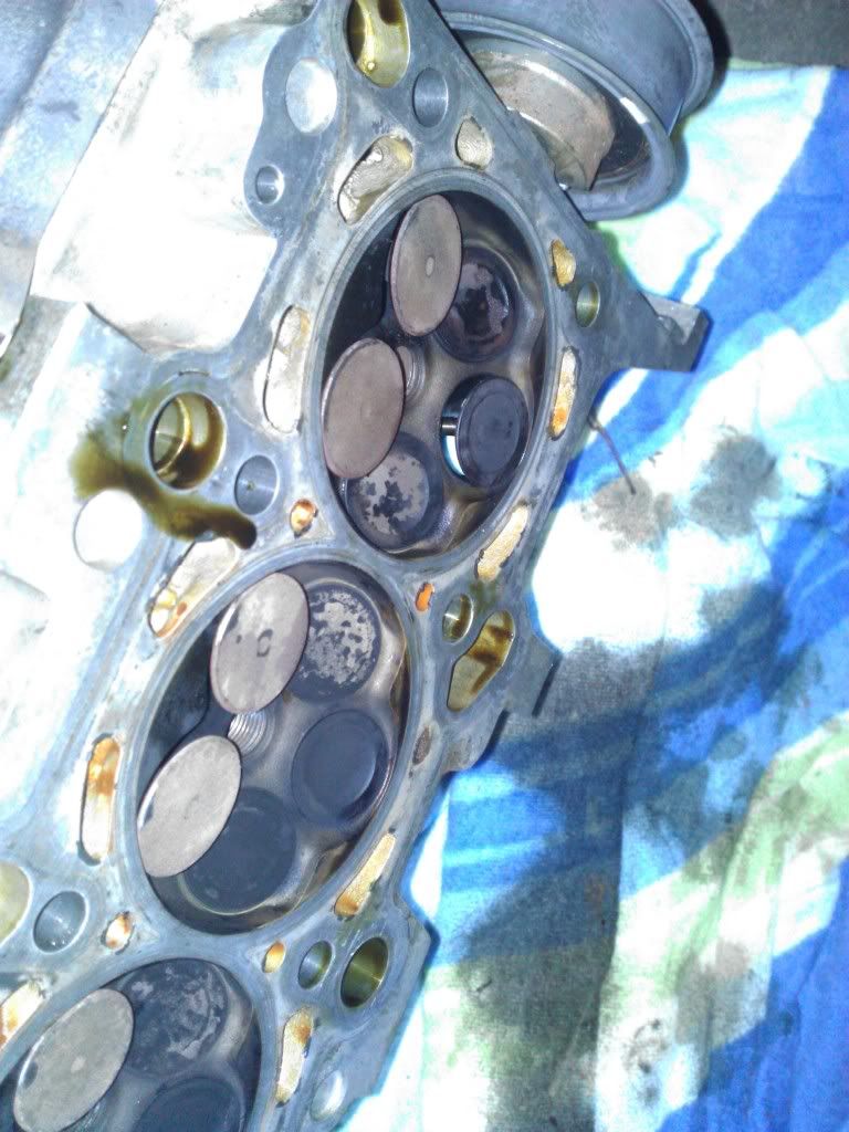

Some pictures of the head and abit of what i think is the bottom end Crank pulley No?
So just seems i need a new Crank bolt and to rebuild the head No?
