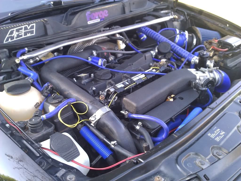

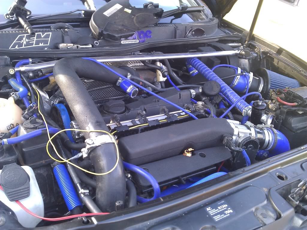

Engines all in now and all together ive given it a clean but it still looks messy lol:
