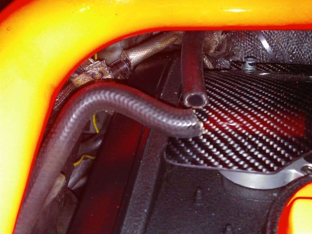

Ive fitted my Coolant lines and both turbo and engine but i dont have anything to join them with...They look like 10mm ID piping..
Is there anything at all i can use to join them that i can pick up And not order of the internet...otherwise il have to weight till next week todo anything....
Hose in the question

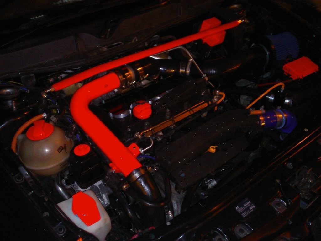

Engine Done just to align charge pipe up and some other bits:
Just a hosetail connector to join the two, probably pick them up from DIY places or definitely anywhere that sells compressed air fittings

Spoke to my Father-In law a moment ago as hes still at work @ stax trade centre....They close at 9pm and i had 5 minutes to get throught to him,
explained to him what i need 1/2'' barbed fitting and he got me a brass one for 26p Inc Vat LOL.!!!
SORTED

Well Nice and earlier this morning i had something todo on the car (water pipe) and the one my father in law got was too big to fit on the pipe...
So jumped in the work van and took a drive to my local carparts place...i paid through the Nose for it £2.99 LOL. but that didnt bother me as i had one...

Anway checked it all again and said a Brief prayer and Started Here up...First Turn of the Key and she fired up and my Exhaust Is well loud!!!!
Brief walk around the engine bay checking bits and looking under the car she was idling Fine...but with a Brief Hump in the Revs but i havent fitted some pipes Like N75 charge Pipe and no actuator fitted Yet plus my Tip is missing a Jublie clip...But my first concern was to get her running...
No Lumpy Running idle like before nothing...had the usal Smoke (light) from the manifold which was burning off...But after 5 mins of idling as the heat cycle started...I checked underneath again and seen oil Dripping from gearbox side but not in massive amounts so ive narrowed it down to be around the VVT head bit as it seems No other oil pipes Are around there...
How i left her Running :D
Im am over the moon about it...:D Im going to look more around the gearbox side and see what can be leaking and were From...But when we rebuilt the head we didnt change the VVT Gasket and VVT Moon gasket think...(didnt ORDER it)
