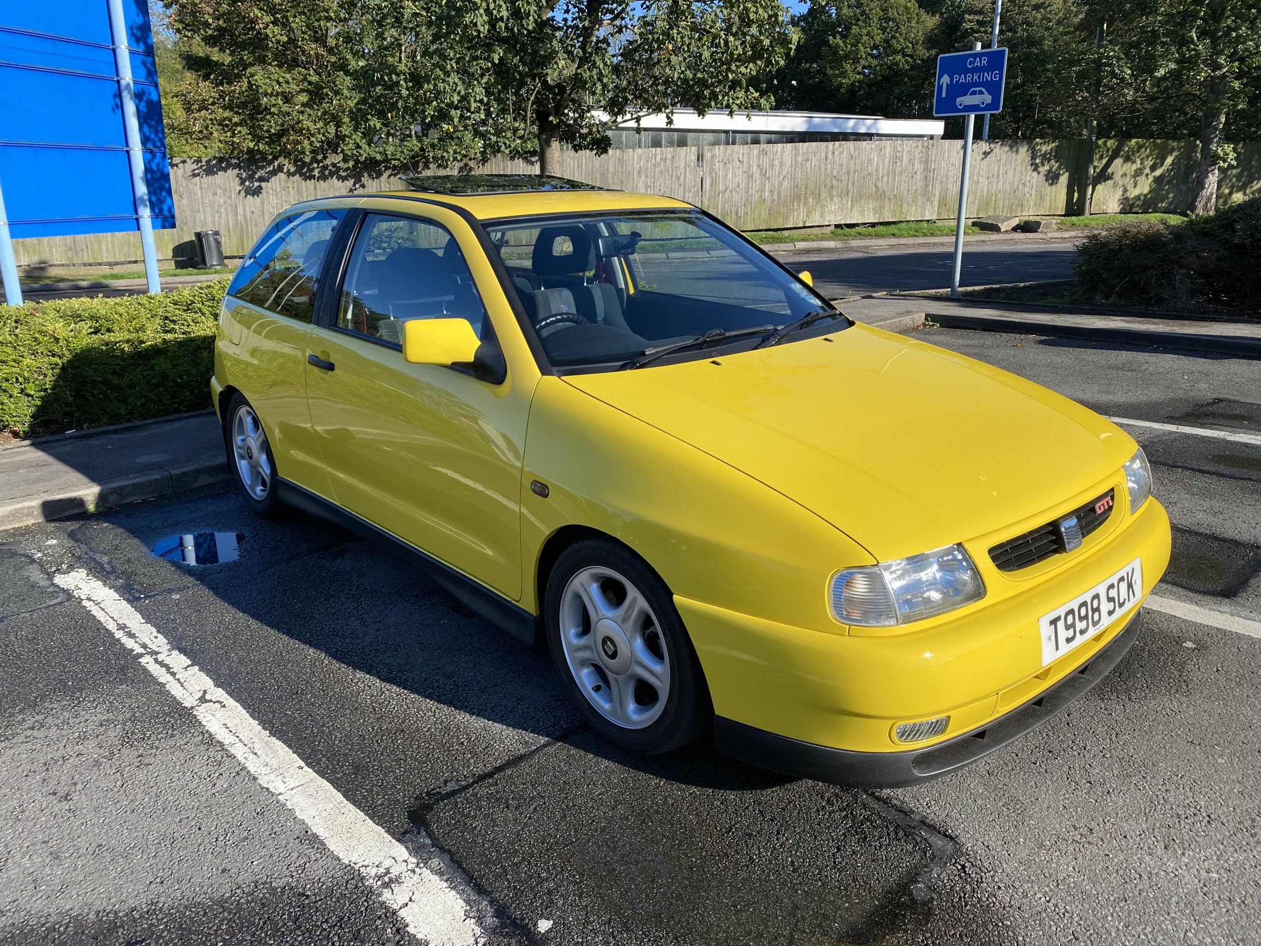

Still going strong as my daily driver!
Just passed its MOT yesterday with the only advisories being slight play in the rear wheel bearings - which I failed to re-adjust after replacing.
As a second car I have been less precious/obsessed about cleaning and use which whilst to the slight detriment of the car has meant I have REALLY enjoyed driving it - free of worry!
My other car is a Mk1 TT Quattro Sport which feels uber safe and secure - but I love the edgy instability of the Ibiza - keeps you engaged!
I will need to sort a couple of paint issues soon to keep up appearances.
