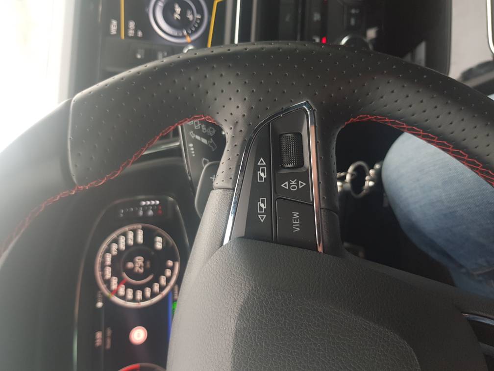

What do you exactly need to do then and what is exactly needed chap?

Yes I do.
You need:
5F0920790A - Virtual Cockpit unit
5F0857053 1QB - the plastic trim/bezel around it
Most Fiber Optic cable for connection between Nav unit in glovebox and VC.
After that it should be coded by dealer or remotely by somebody. You have to bring both of the keys to the dealer, so they can adapt them to the new dash.
Also when you do it, bring the car to the dealer with full tank of fuel, so they can calibrate easily.
Send those part numbers to your dealer and ask them for prices and fitting.
