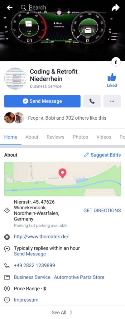

Yup. There is one guy in Germany - www.thomatek.de.
If his website doesn't work, go on Facebook and find the following page: "Coding & retrofit Niederrhein" he responds to messages and has more contacts over there. Really cool guy.
