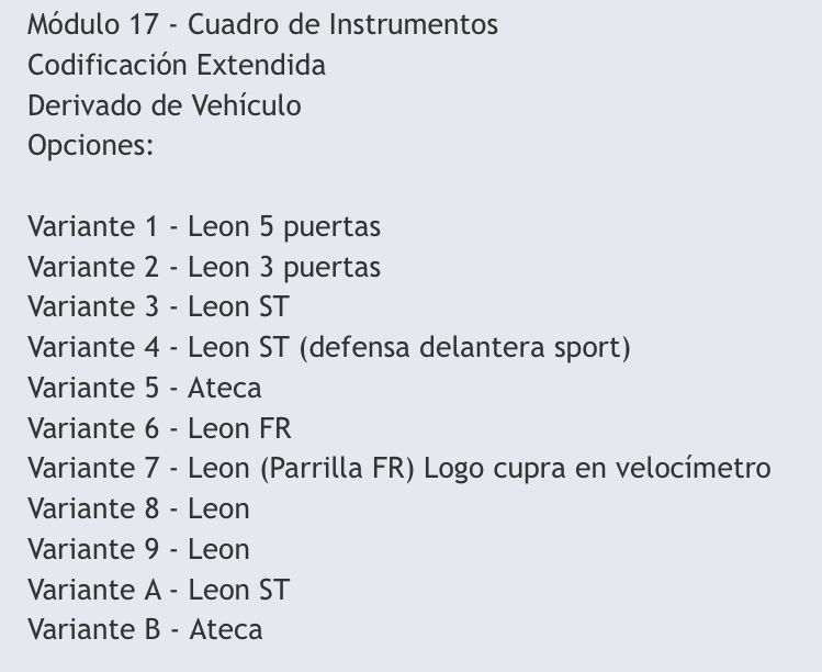

Hello! I want to ask you guys about my virtuel cockpit , I bought it from a junkyard and it comes from a seat ateca,
I have removed cp with odis and many hours with vcds coding to get every error and so , it’s all fine but can you change the “startup” picture? It’s now displaying a ateca and not a Leon that I’m driving :)
Copy/paste from a Spanish forum, but pretty self-explanatory:
Reactions: Aceturbo

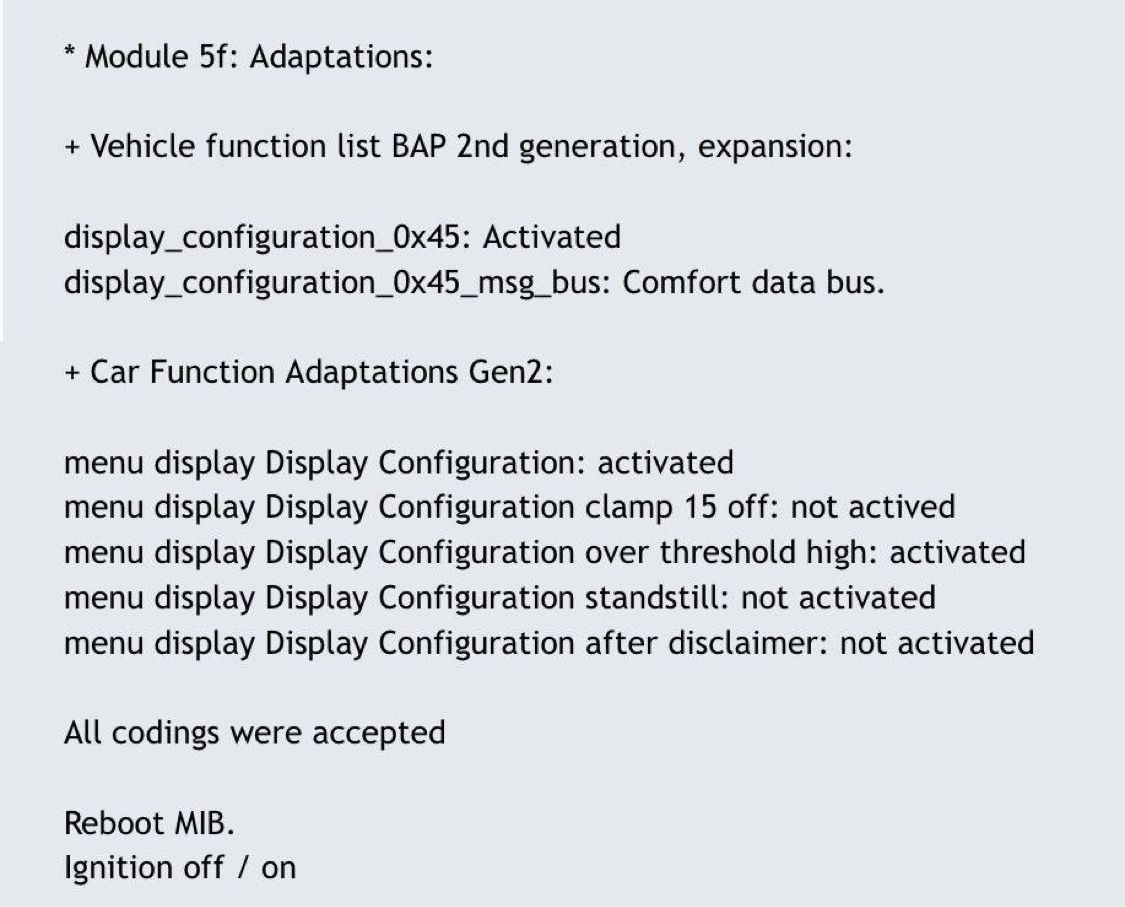

If anyone knows how to enable the 'Automatic' option in the instrument cluster view panel, please let me know. Mine just displays Classic, View 1, View 2, View 3. Also, any idea how I can switch between these views without using the touchscreen? Cheers.
Did't realise there was an 'automatic' option. Wonder if that's just for the high unit as don't remember having it on mine.
@East Yorkshire Retrofits maybe able to answer.
Cheers for the reply. Fairly sure the automatic view option was there on the standard MIB 2 unit cars I've seen. It's mentioned in the handbooks of all years of Leon handbooks where the digital dash was included - see page 71 on this example: https://www.seat.co.uk/datamanual-manual/leon/my20_w28/en-uk/LEON_07_19_EN.pdf
Also, are you able to change the view of the spheres on yours? e.g. change between view 1 - 3. If so, how please? Cheers
I'll try to remember to take a look next time I'm in it.
This is done from the main screen rather than then Virtual Cockpit itself.
Go to the main menu and choose vehicle settings. Then in the top left tap the button (think its labelled view). Choose the option for instrument cluster.
If its not there its not been setup properly when they did the retrofit.
From that screen you swipe up and down for the different options on the left and right. Once you have a setup you like that you want to save hold your finger down on the view you want to set it to for about 5-10 seconds.

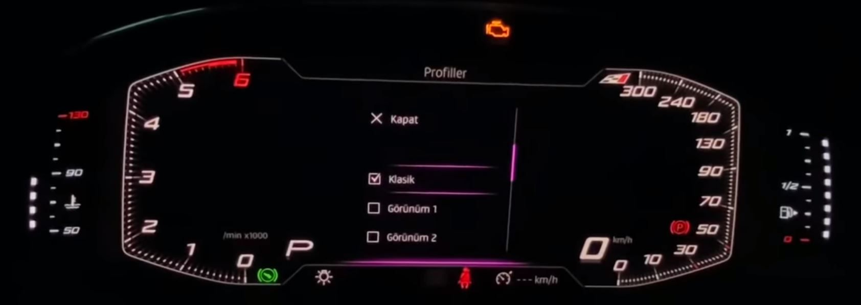

Thanks for the reply. I came a video clip of someone swapping the profile using the cockpit (its in Turkish, but shows switching between classic, view 1 and view 2), oddly no view 3 though. Screenshot below:
Thanks for the instrument cluster menu bit - I've got that menu. There just seemed the potential to easily swap sphere views like above. Not the end of the world though. Cheers.
Hold "view" to do that. Some of them do only have 2 views
View 3 may just be off screen and to scroll down further maybe.
