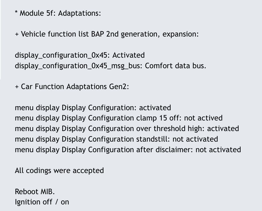

Anyone know how to enable the instrument cluster menu in the car - view menu when the virtual display is retro fitted ?
Jorre
Feb 21, 2017
41
7
Hi all
Here you go:

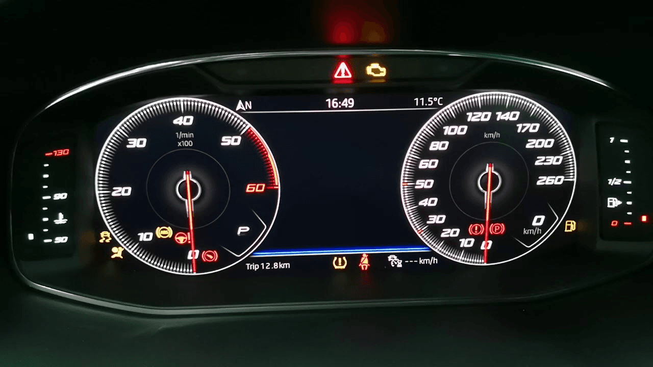

There are 3 versions.
Version 1 Part Number - 5F0920790
3 views - What I used to have:
View 1:

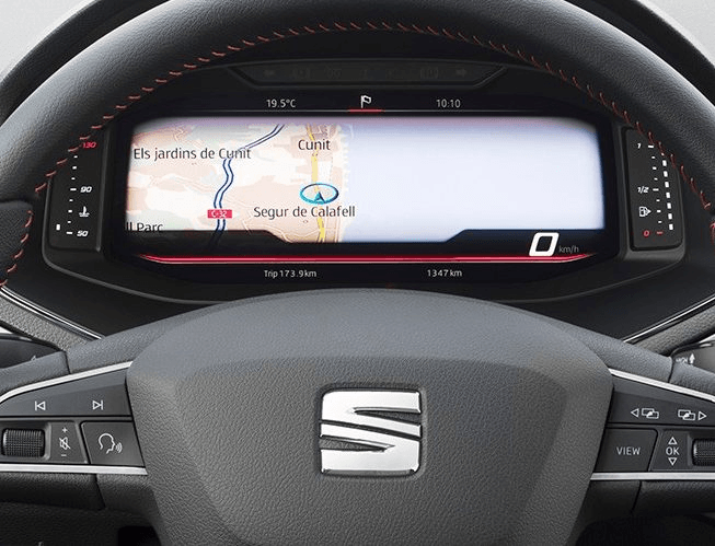

View 2:
View 3

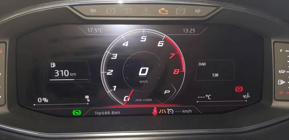

Sadly I don't have a picture, but its like view 2, but with info left and right of the map.

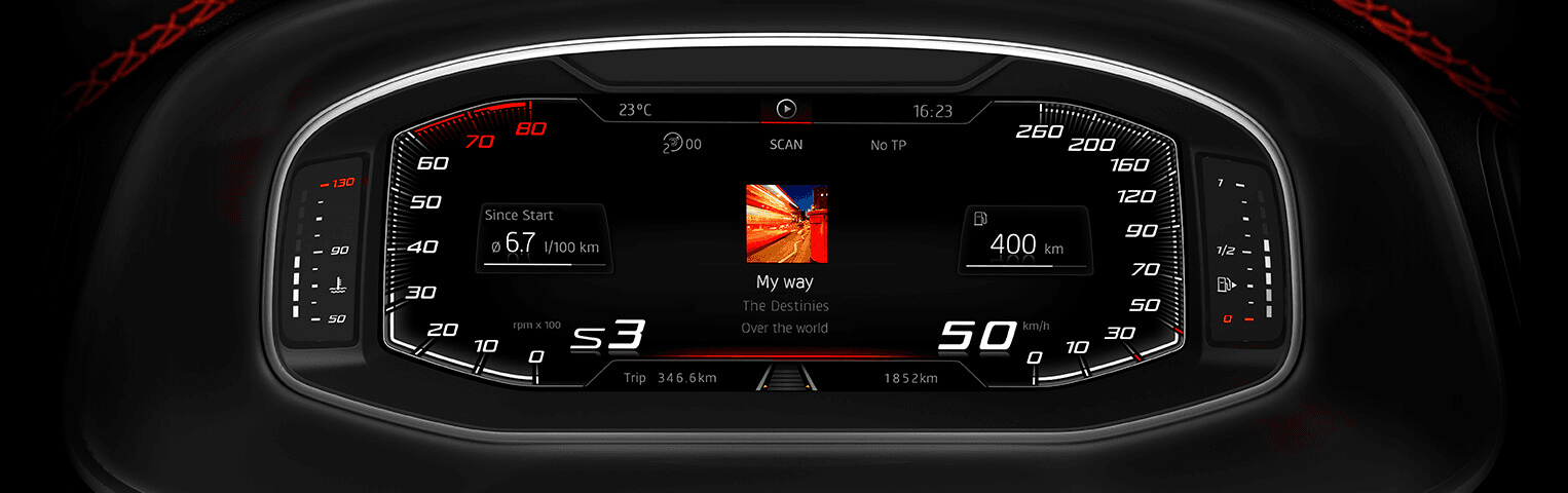

Version 2 Part Number - 5F0920790 A
4 views - What I have now (including sports display)
View 1:
View 2:
New version of View 3 that replaced the above view 3, this now has the speedo and rev counter around the edge:
New View 4 (Sports display)
