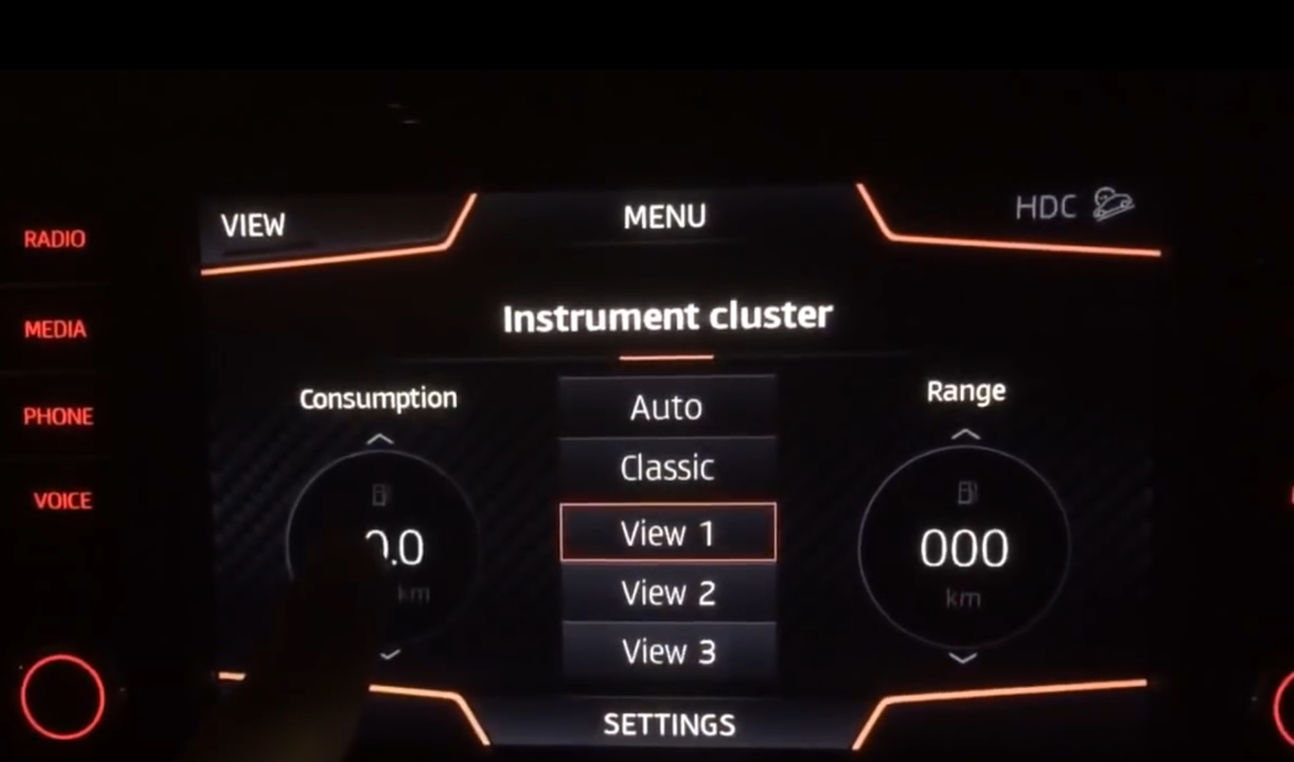

Those are all the views.Hello i would like to know if its possible to look the différents views virtual cockpit without fibre optic ?
My system is a MIB STD2 ZR NAV.
Im sorry i dont speak english correctly.
