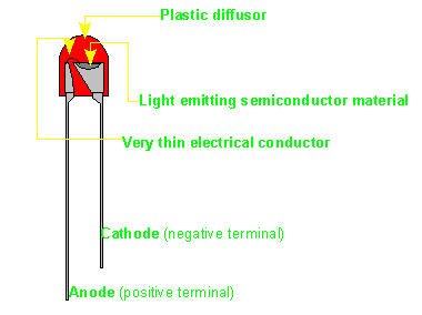

daft question but both the wires to the door led are grey which is which as i want to change it for blue ?
chris
chris
ibiza_95 said:Just test it.
It doesnt matter if you put the led on the wrong way, it just wont work. if it doesnt work then you know it goes on the other way...
simple as
