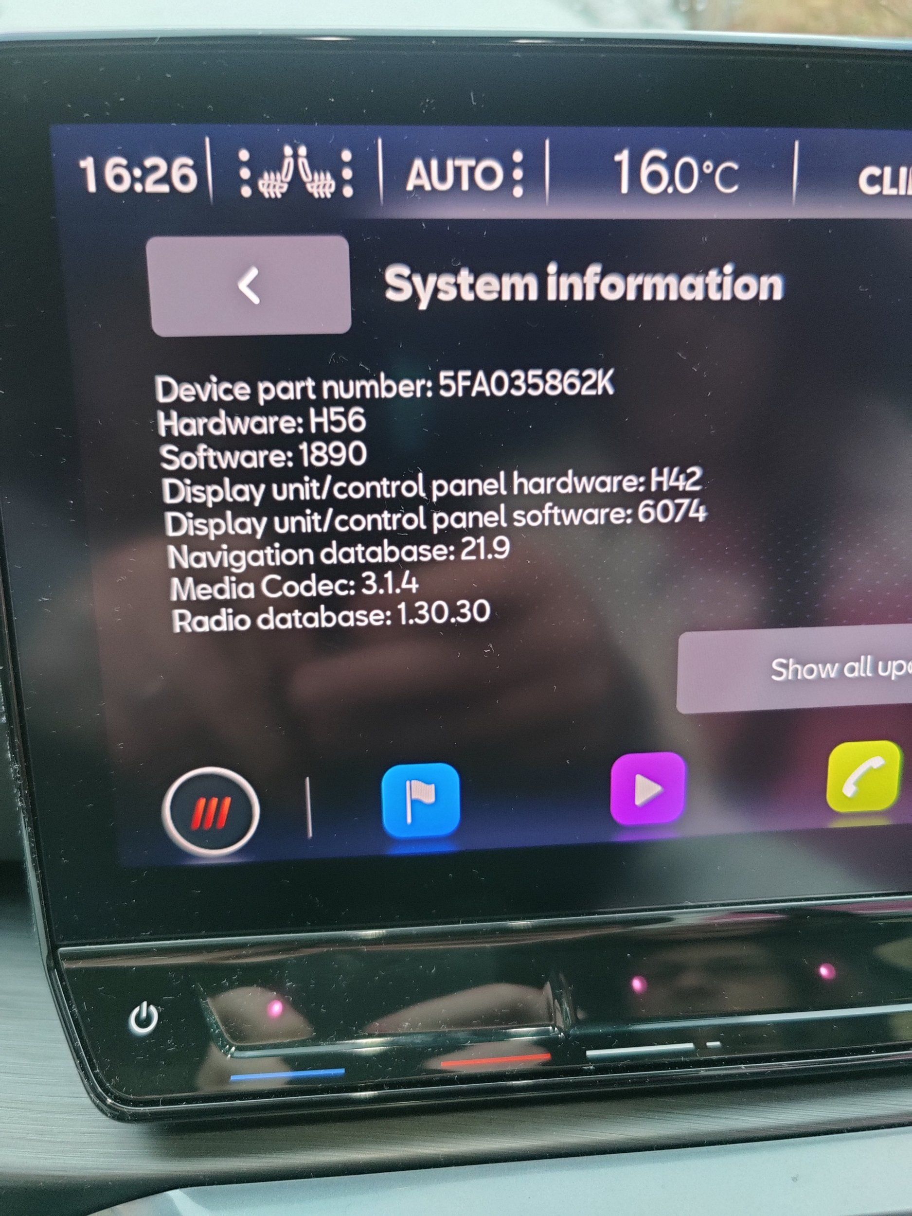

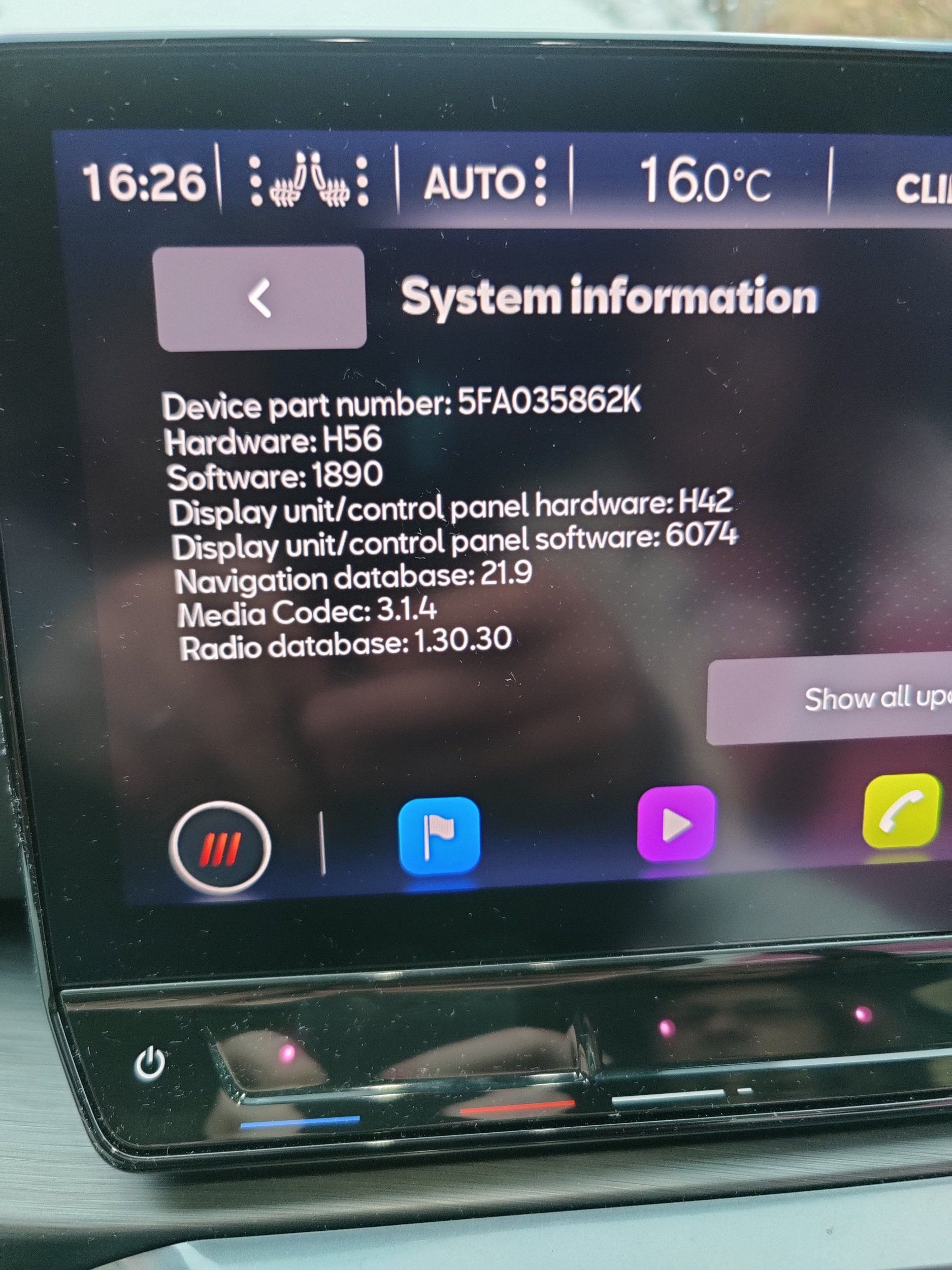

Picked my V2 150 up today after dropping it in for repeat screen freezing issues on the 1803 software and it came back with the 1890:
Not had chance to test it yet but it didn't freeze on the 20min drive home so that's a good start!
Reactions: Splosho

And the screen freeze is back. Hoped software v1890 might fix it but nope. Ugh, this is easily the most frustrating car I've ever owned.
