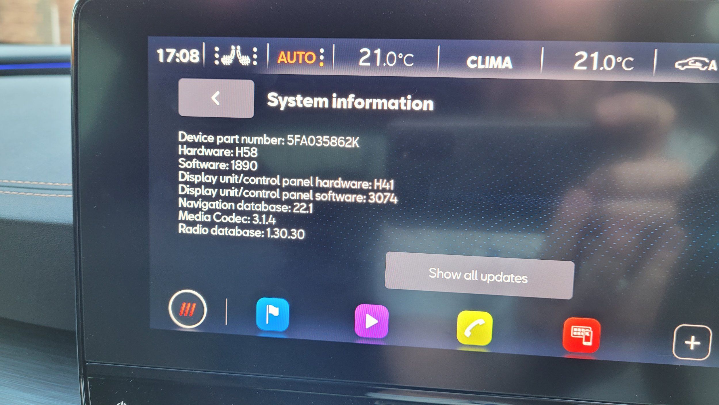

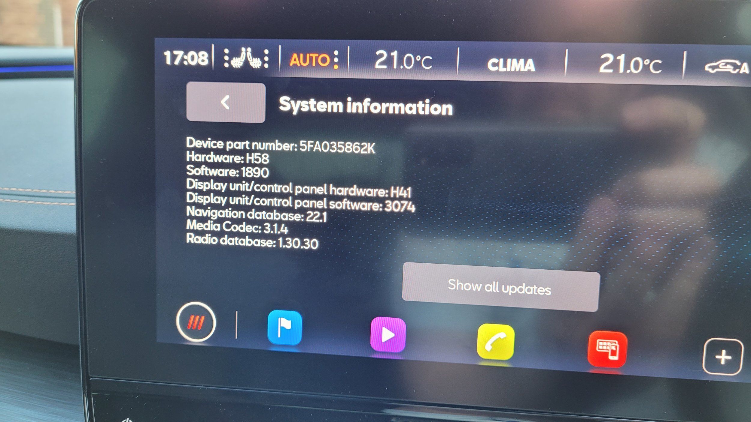

Mar 8, 2022
My V2 came into port two and half weeks ago, picked up yesterday and seems to be running the latest 1890 so assume all new cars will be updated to it?
Reactions: Splosho
Glad to see mate, mine arrived at the port around 2 and a half week ago as well. Also noticed the hardware on your is now H58 rather than H56 in previous Formentors. I wonder if this means they also have the new Samsung chips within them. Getting mine delivered next Tuesday
Mar 8, 2022
Maybe it does, have to say there is little to no lag on the system, everything seems very quick. Also the wireless android auto is amazing!
Good luck for next Tuesday, hopefully all is well
