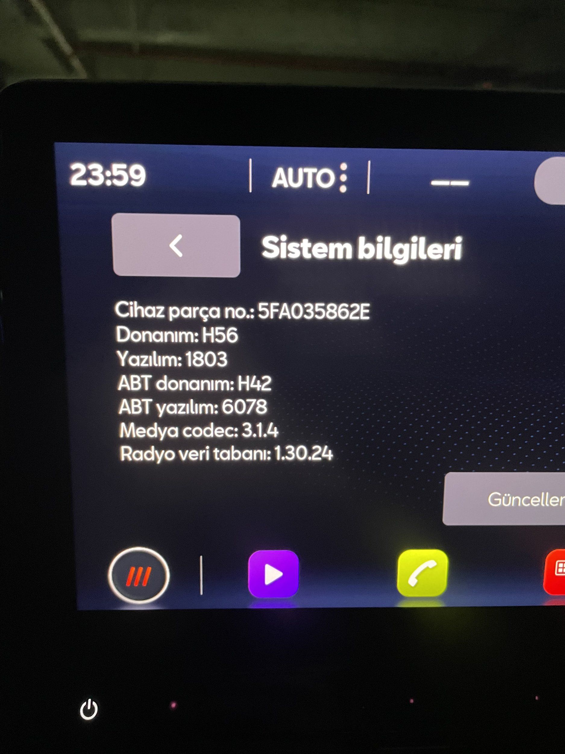

Hi all . I bought my car about 2 weeks ago .
But my car is 2nd hand just 2000km.
I can't see the navigation menu in my car
Is it updated or is it not supported by my vehicle?
And I can't connect to the internet in any way.
Thank your for your help
