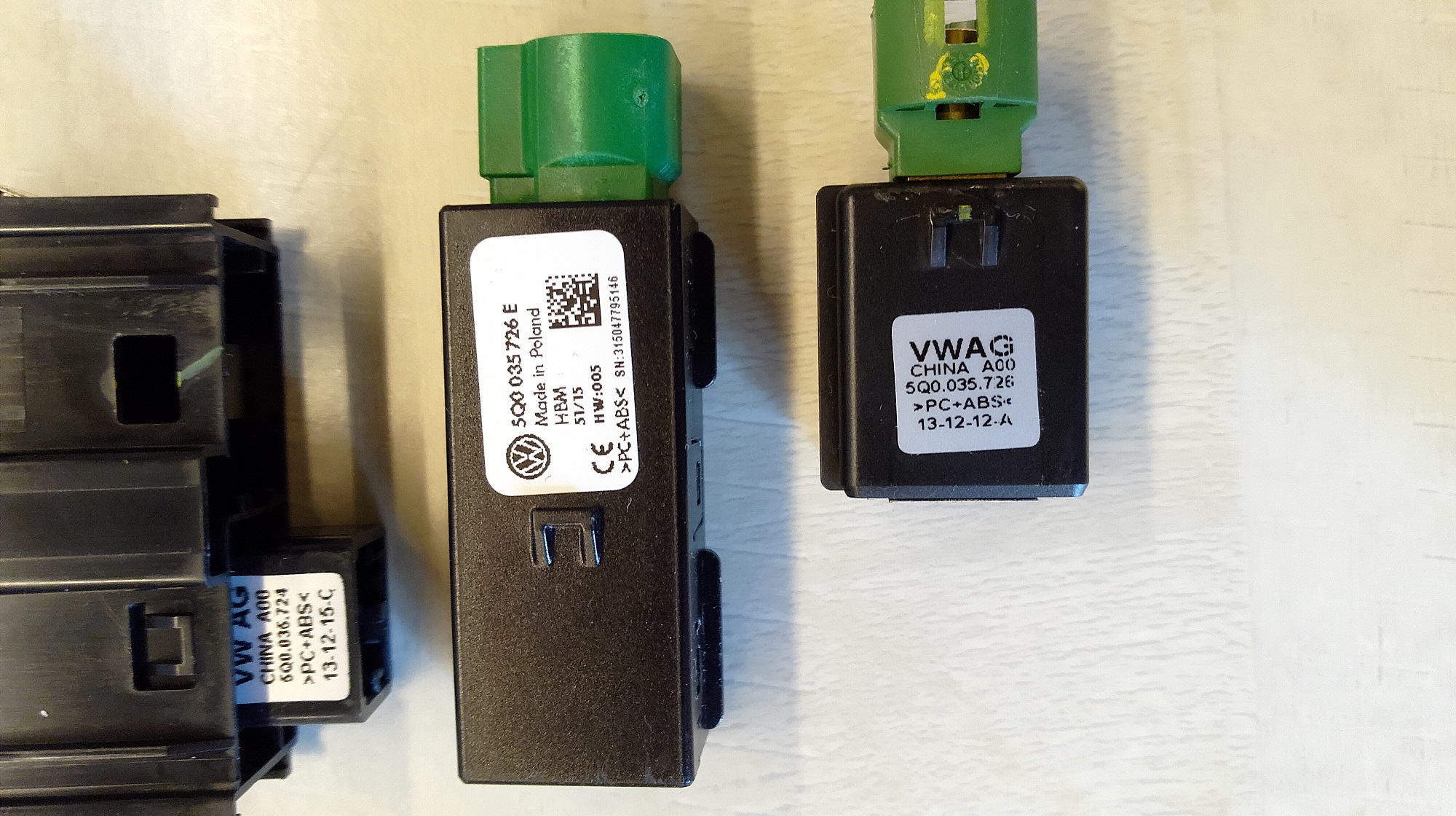

Changing the USB port with the new E rev. ( 5Q0 035 726 E) is needed if you are iPhone user. Android Auto and mirrorlink is running and with the old USB port but if you want to use apple Car Play you have to change it. All VAG use the same ports, mine is from Octavia MK3 - second hand.
Any idea what the difference is? Curious as to why this is needed and why it doesn’t come by default.
I guess the old USB port is just connection and the new have inside some ic scheme.
I suspect that cars built with the ability to have Full Link activated, such as yours, had the incorrect or early USB port, whereas cars that had Full Link activated from factory, like mine (2016 MY), had the later USB port which works fine with Car Play and Android Auto.

I have a 2015 ST and it turned out that the USB port didn’t support Full Link. I think it was a low speed port (maybe usb1.1) and they had to swap it for a high speed port (presumably usb 2.0). It was the first time the dealer had encountered that issue so they supplied and fitted the new port free of charge.
