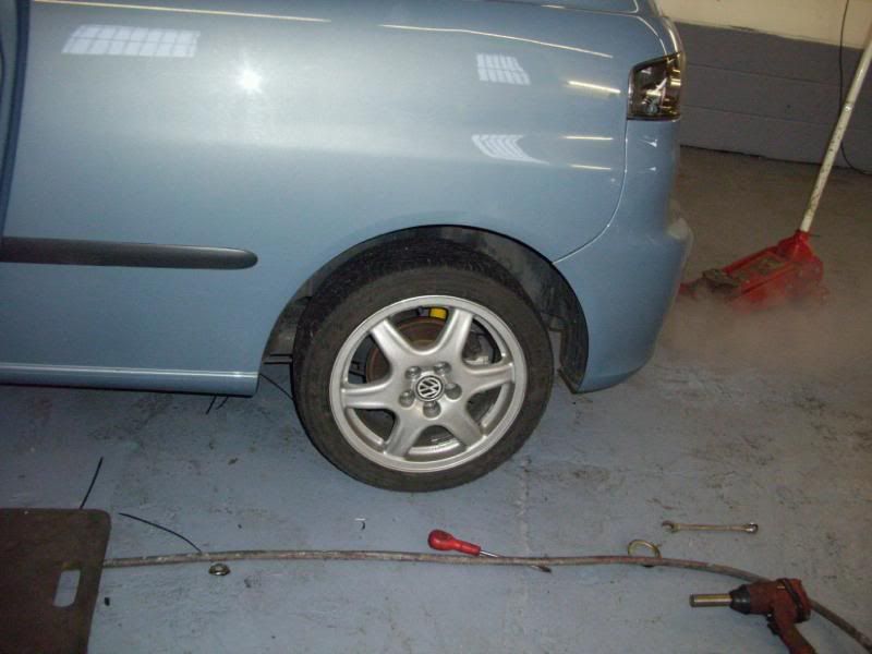

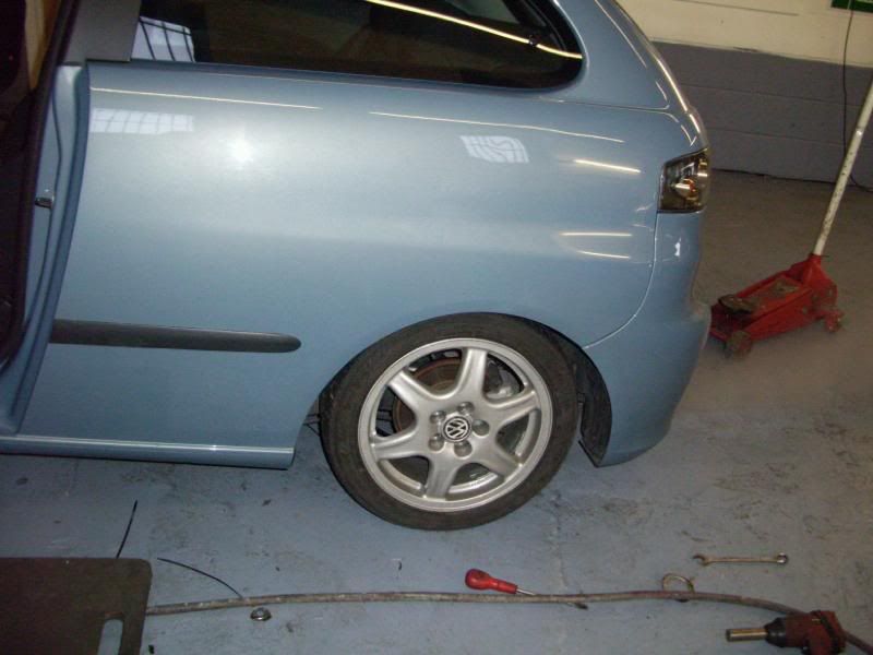

big update as bags are fitted! :drool: :rock:
compressor and tank in wheel well
miles of wires lol
switches wired and taped up
airlines being run
mounting switches/gauges
gauges in centre console above ashtray

rears
ass down on the winters lol
ass up!
fully up!
dropped
cheers for lookin
doesnt look that low in the pics if im honest
tomorrow the bump stops will be halfed in size for a gain of 15mm but ill loose 15mm when fully raised
15s dont help either lol
