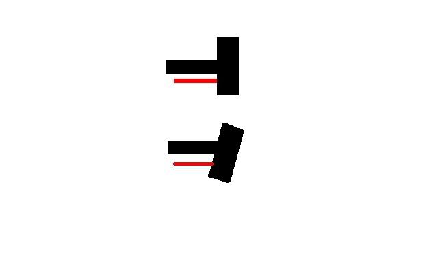

if the rod end screws on alright and fits ok to the hub then i can't see there being a problem, surely being shorter it just means you ain't got as much adjustment?
No the track rod ends are wrong mate if they are shorter then when you put them on, your wheel will
be toeing out far to much and you will wear your tyres out in no time not to mention lack of grip handling to pot car pulling.
Crapy drawing ive done to help you. Its as if you are looking from the sky down at the wheel. the wheel and drive shaft are in black the track rod is in red the right length track rod is at the top the short one at the bottom. Top is correct
OK thanks guys, jus been on the phone to them, they say the part numbers are wrong for my car, wtf!! so annoyed with them plus the idiot who served me , when i returned the rear top mounts he took my old recipt that had all the parts i ordered, the new recipt just had credit invoice of top mounts retruned only. soo pissed with them! as i wanted the car on the road 2morow.
cheers mike for the drawing
