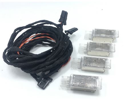

I find wire and lights kit. My problem was how connect it to bcm, but for the end i find the schemas.

I know how, you have to remove the B plug of the BCM and add the new crimped pin to the 45 pin.
I'm waiting for the pins to arrive (i didnt buy the kit)
11 $ for all this :cheeky:

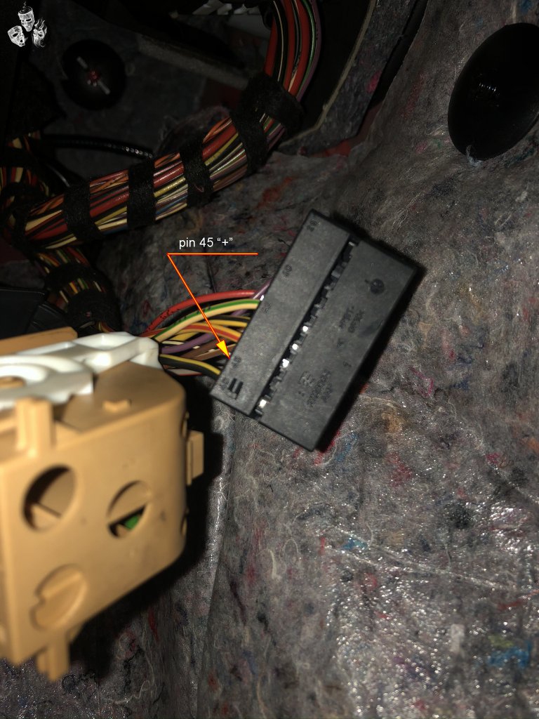

Are you codding with obdeleven?
Also, do you have any pics of the wiring from the BCM module?
When you will open connector you will see number of pin on connector
Yeah, I also have the diagram.

The only thing I don't know for sure is the location of the BCM and the ground screw.
