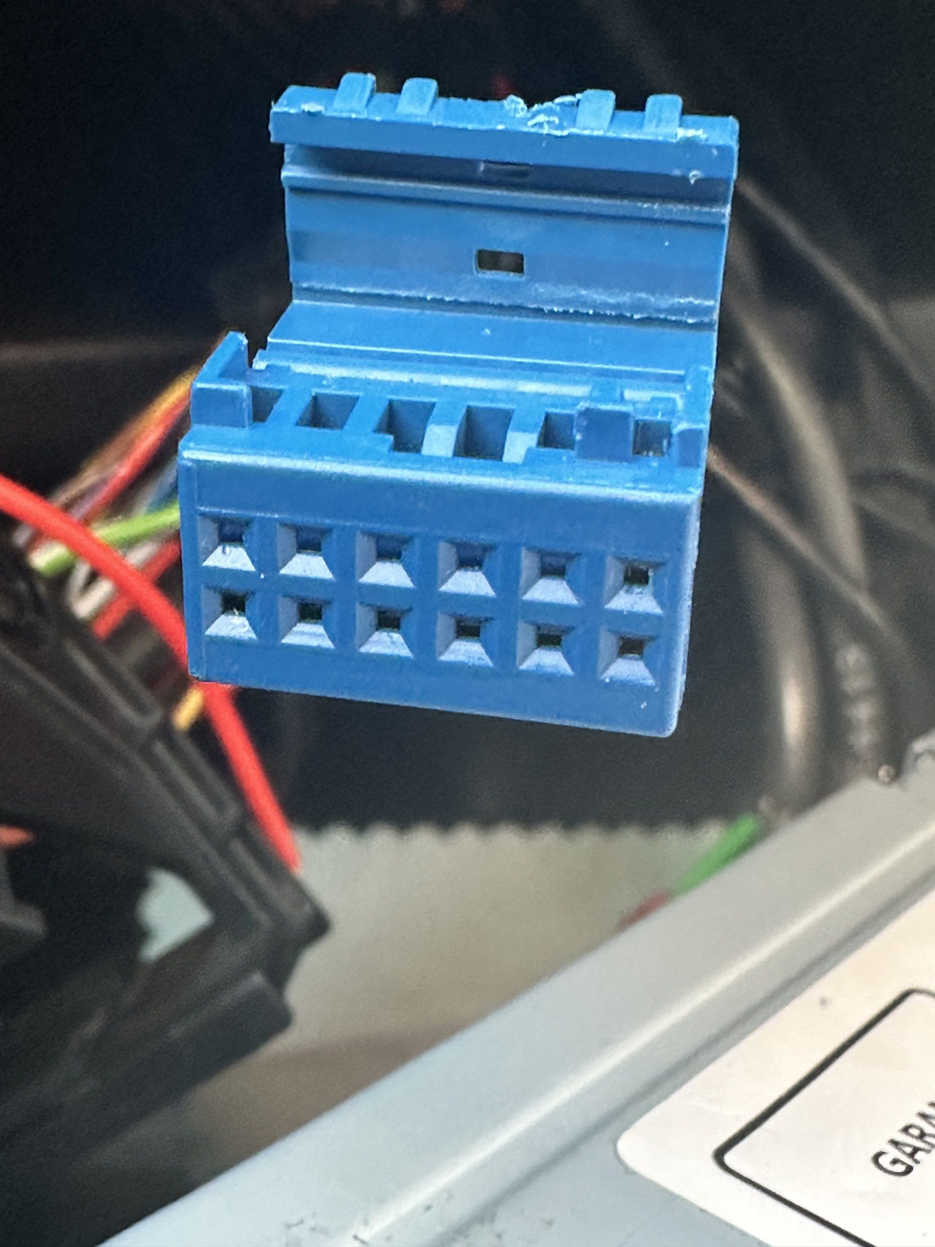

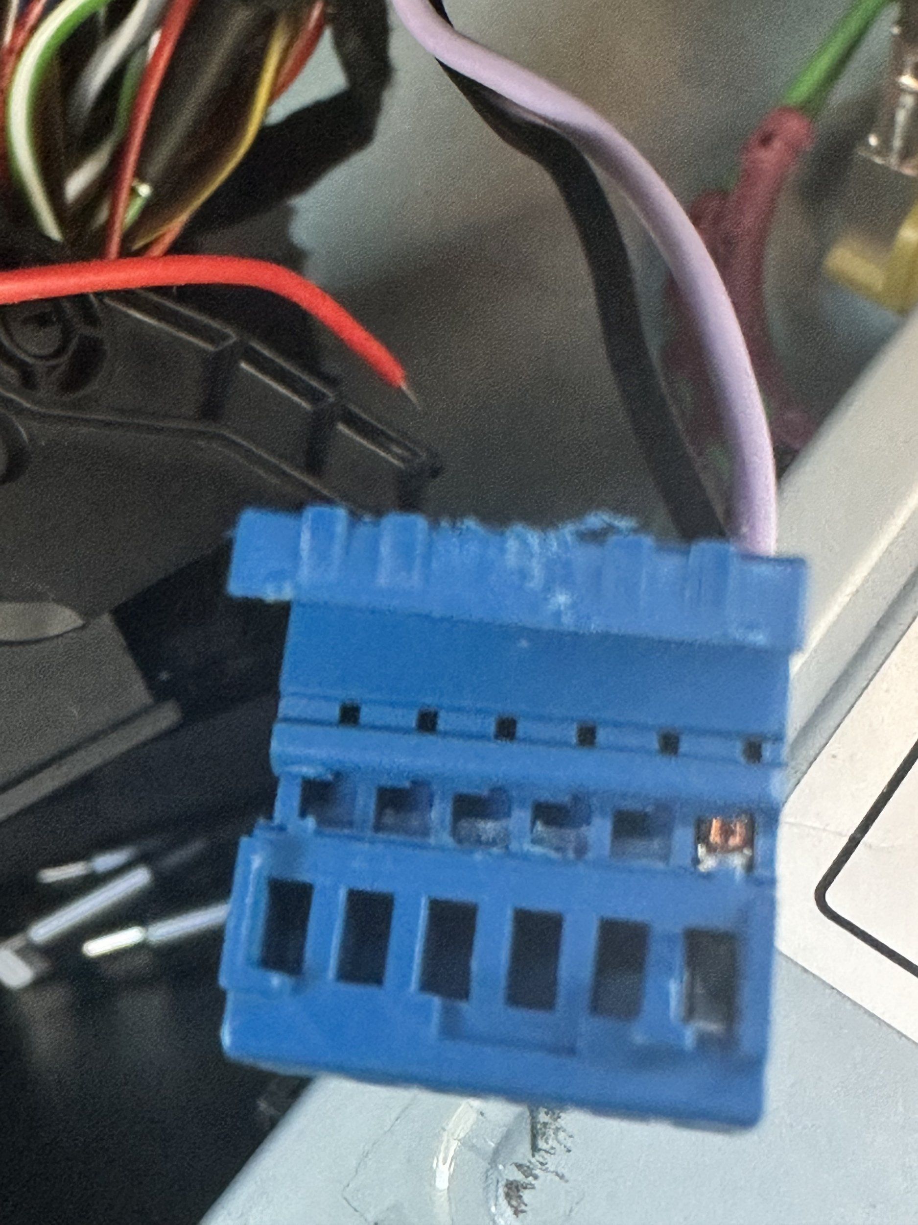

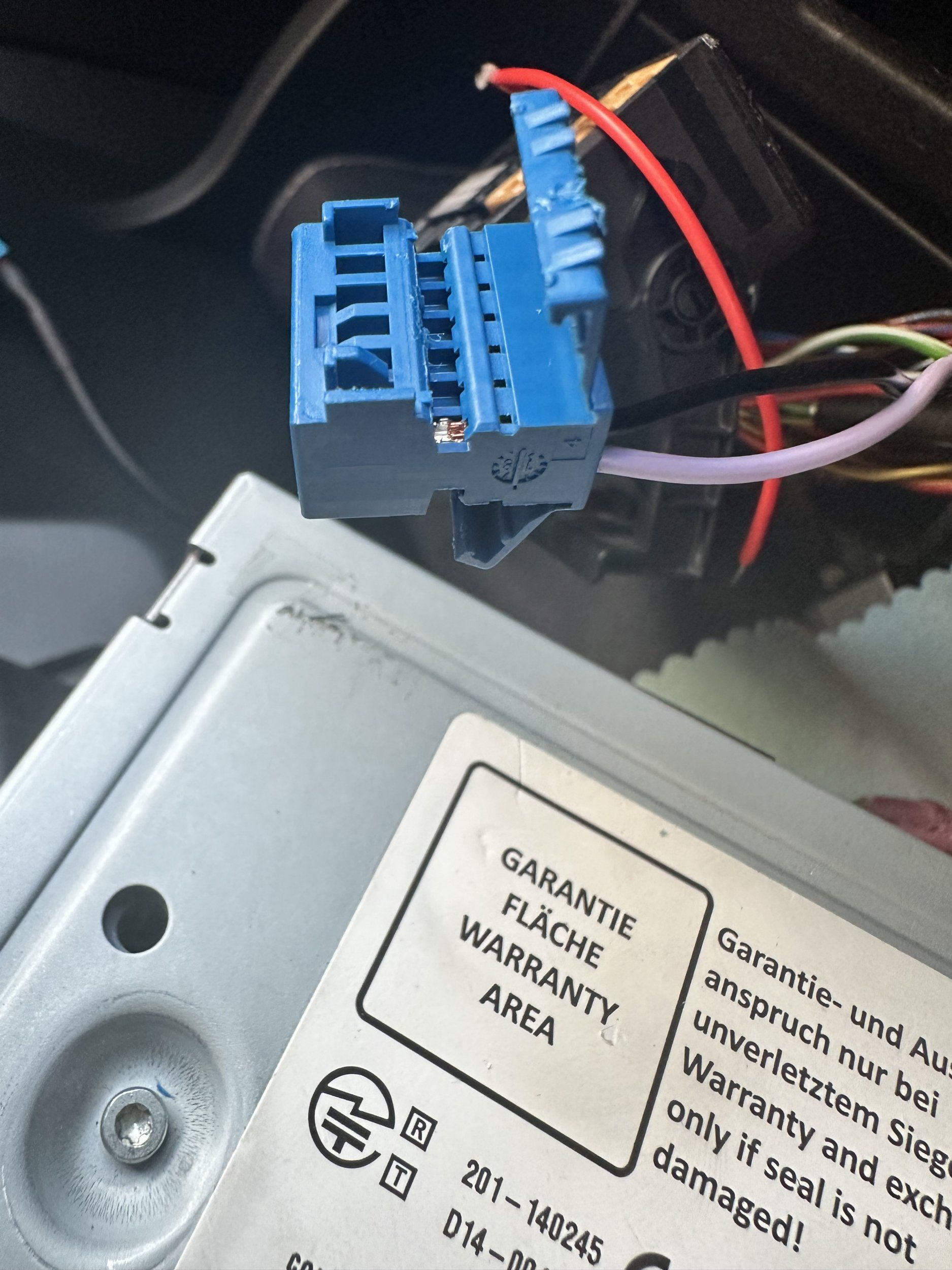

Camera installed and working, thanks to this thread! Only issue I have is relocating the 2 wires from my blue connector block into the blue connector block carrying the RCA signal. I have the terminal removal tools but can't work out which one to use and also how to use it. I have attached some pictures of the block for info.
