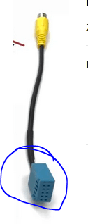

I wonder if it may be the fault of the connection in this blue plug.
Maybe I'll also try, as you say, to provide constant power for a while.
Try to check if the 4 wires in the blu connector are correct installed like the photos in the first pages of this thread and after check well if the power wires from the reverse light of rear right connector are well fit!

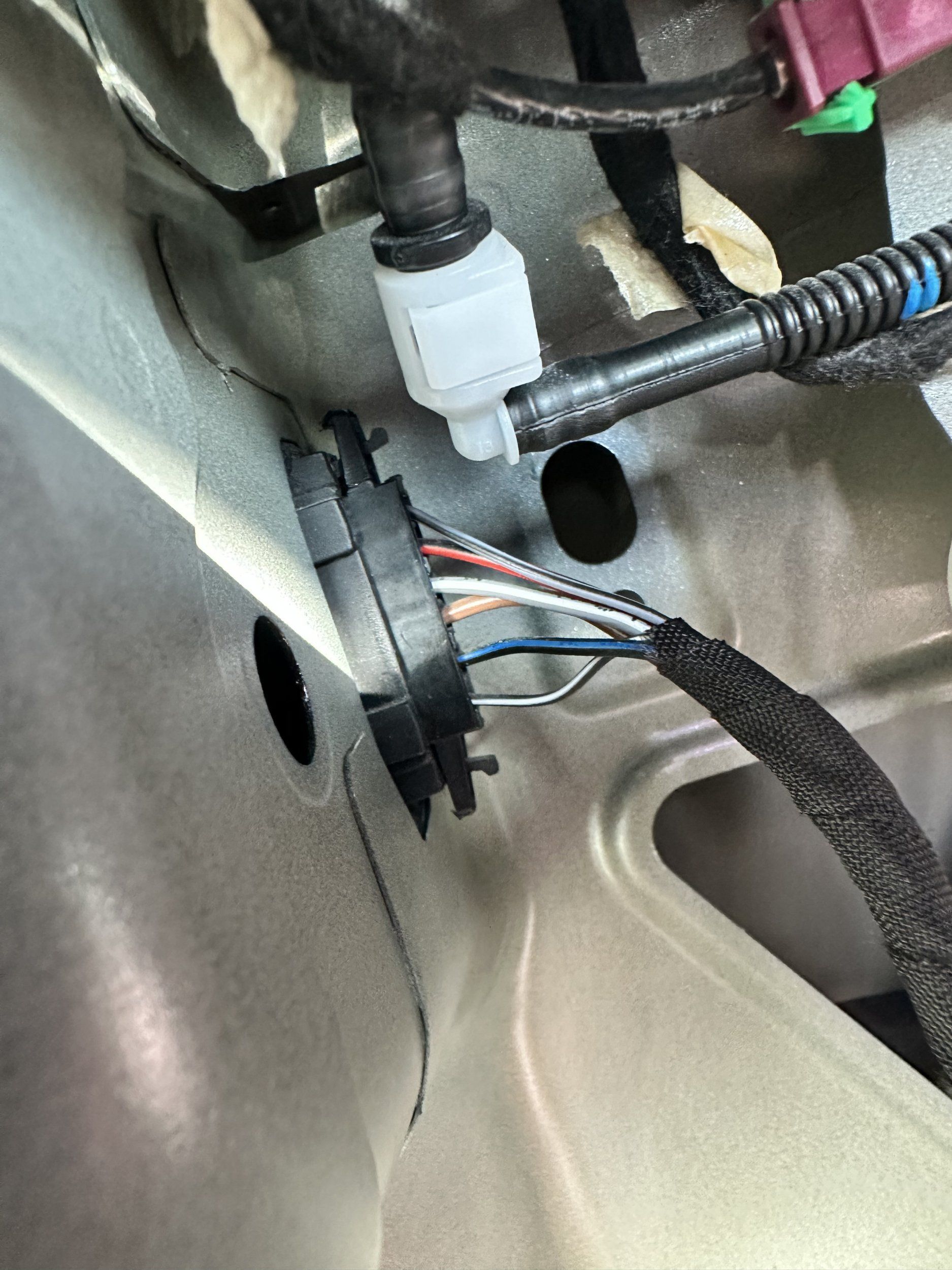

Hi all, just received my camera yesterday and working on it now. I'm confused as to the wiring to tap into for the rear cluster. Bruno had said earlier in the thread the live is black and blue with the ground green and blue. Either I've gone colour blind overnight or my wiring colours are different. Any help identifying what is what is appreciated.
Black/blue is the reverse light and must be connected on the switched live on the RVC. Brown needs to be connected on a chassis ground neve on the rear lights. And normale the RVC does also have a steady 12v+
But measure it and you will now for sure. You need to clos the lock off the trunk when doing this

Ok, next daft question. What size of connector do I need to add the wires from the RCA cable to the quad lock on the MMI?
Okay, I messed up the quad lock connector from the RCA cable so have ordered a new one. How do I connect this to the quad lock as there is already one with 2 wires in the blue section? Thanks
