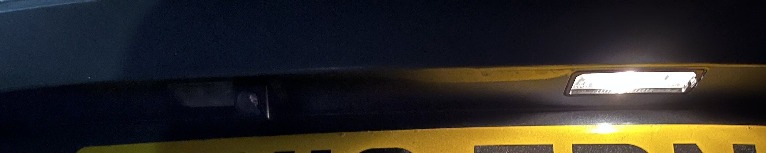

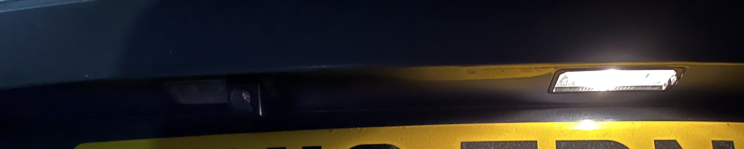

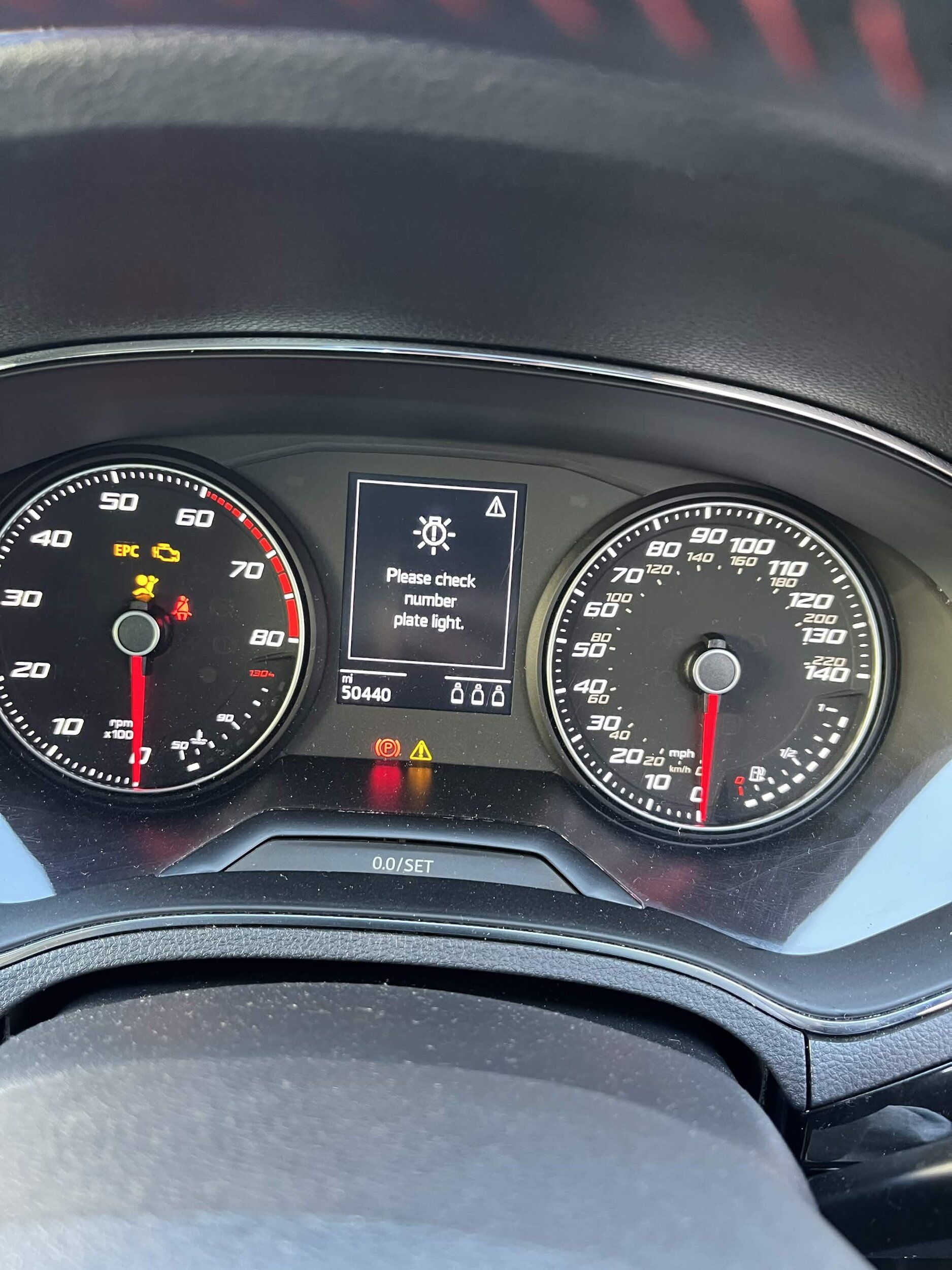

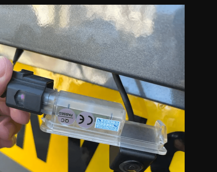

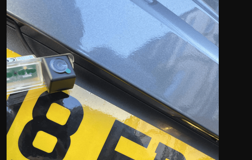

I attached this sinosmart license plate cam from aliexpress and got the camera working but I don't see the light working and I'm getting a number plate light error on dashboard? Wondering if anyone else has had this issue or knows how to fix?
Hello, there is three options for you :
1. Unscrew the camera from the plug, drill a hole on the center of your bumper make the cable go here and glue/screw your camera and for the light, put back the old one.
2. Plug back the old light on the initial connexion and hide the light on your bumper and put your camera licence plate cam as intended : no error but no light
3.With some coding tool like carscanner and an obd dongle you will be able to code a 5v led light instead of an 12v 5w halogen bulb and the light will work with no errors.

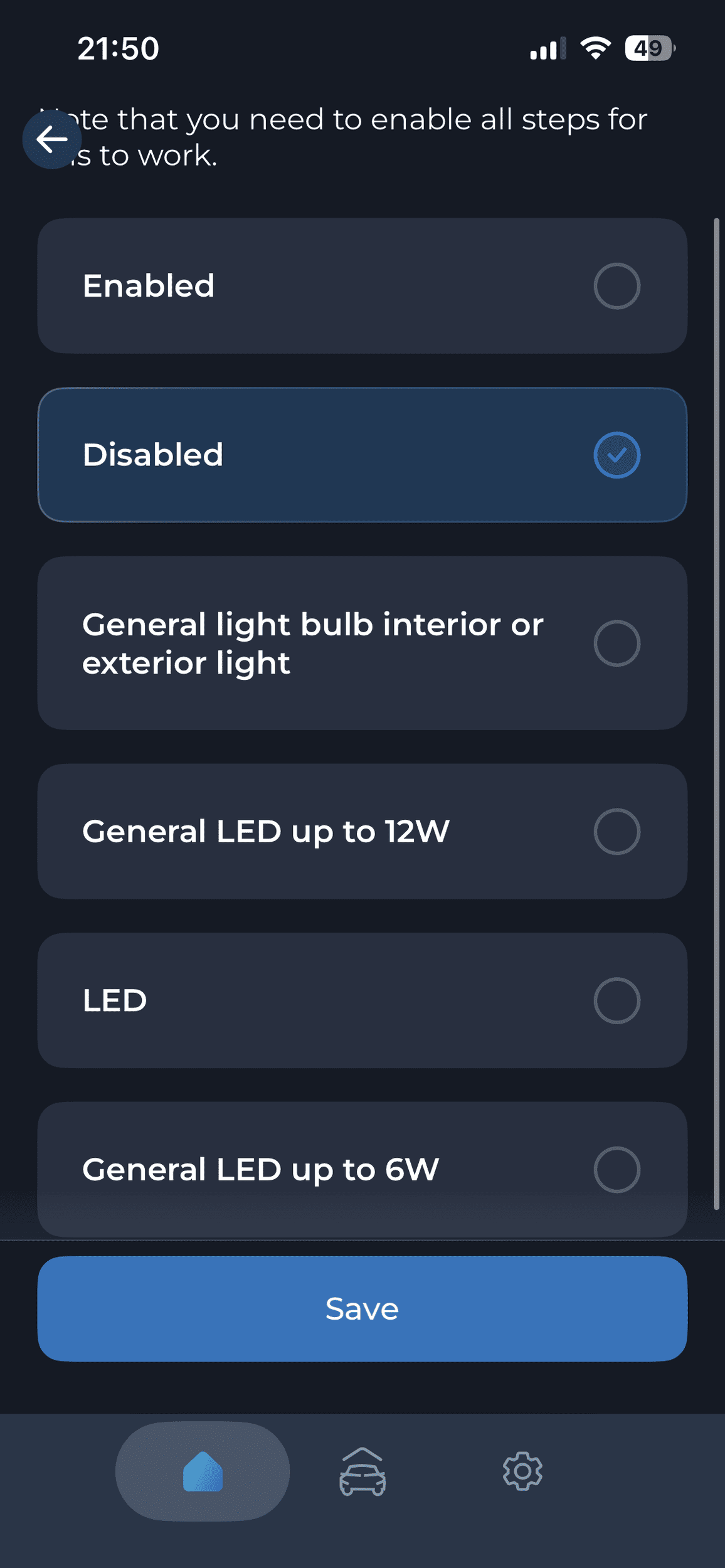

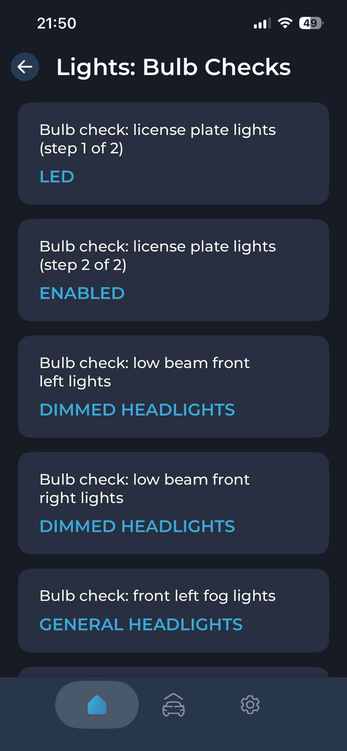

Perfect thanks, I've just ordered a Carista and going to see if I can use that to code the LED light in.

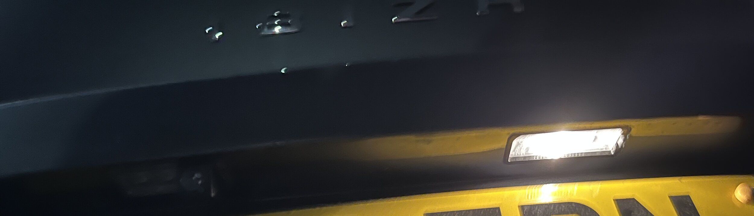

Still can’t get it to work unfortunately. Tried changing it to the LED ones in carista.
