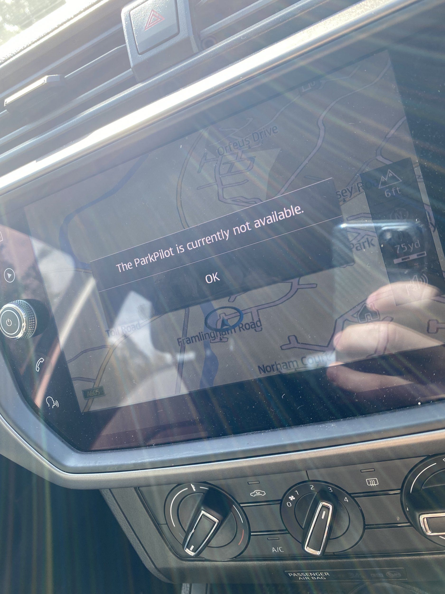

I took the plunge and installed the camera. All works perfectly, except I’m getting the error “ParkPilot not available” after selecting a forward gear after reversing.
Anyone know if there is a change I need to do in VCDS to fix this message on the display? Thanks all!

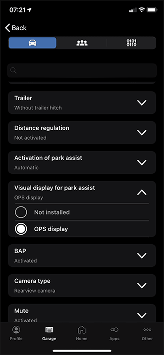

Hi @Bruno Maia, seems in AliExpress new cameras are issued with dynamic trajectory.. Have you tested?
@harrypace, try this codings,
26)
Park Pilot (Optical Parking System) [WORKING]
1. Control Unit 76 (Parking Assistance)
2. Long Coding
3. Visual display for park assist: change the value in "OPS display" [Standard: "not installed"]
Obviously you will try to change not installed...

anyone else had this error after using reverse?

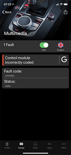

hello
I have the same problem. i already had "display for park assist" to "OPS display". I am still looking for a solution without success. Maybe someone else has a solution?

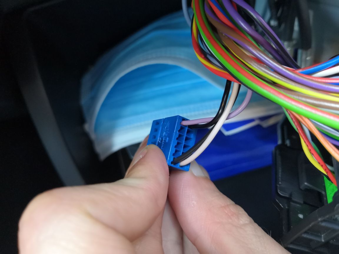

Hello,
Sorry to bring alive this topic again, but I have an issue with the blue connector ...
I received everything, but on my car, there is aleardy something connecting to the blue connector (see in attachment)
Can I connect the 2 camera cable somewhere else on this blue connector ? Or have I to disconnect the 2 cable already present and replace them by the new one ?
Thanks !
