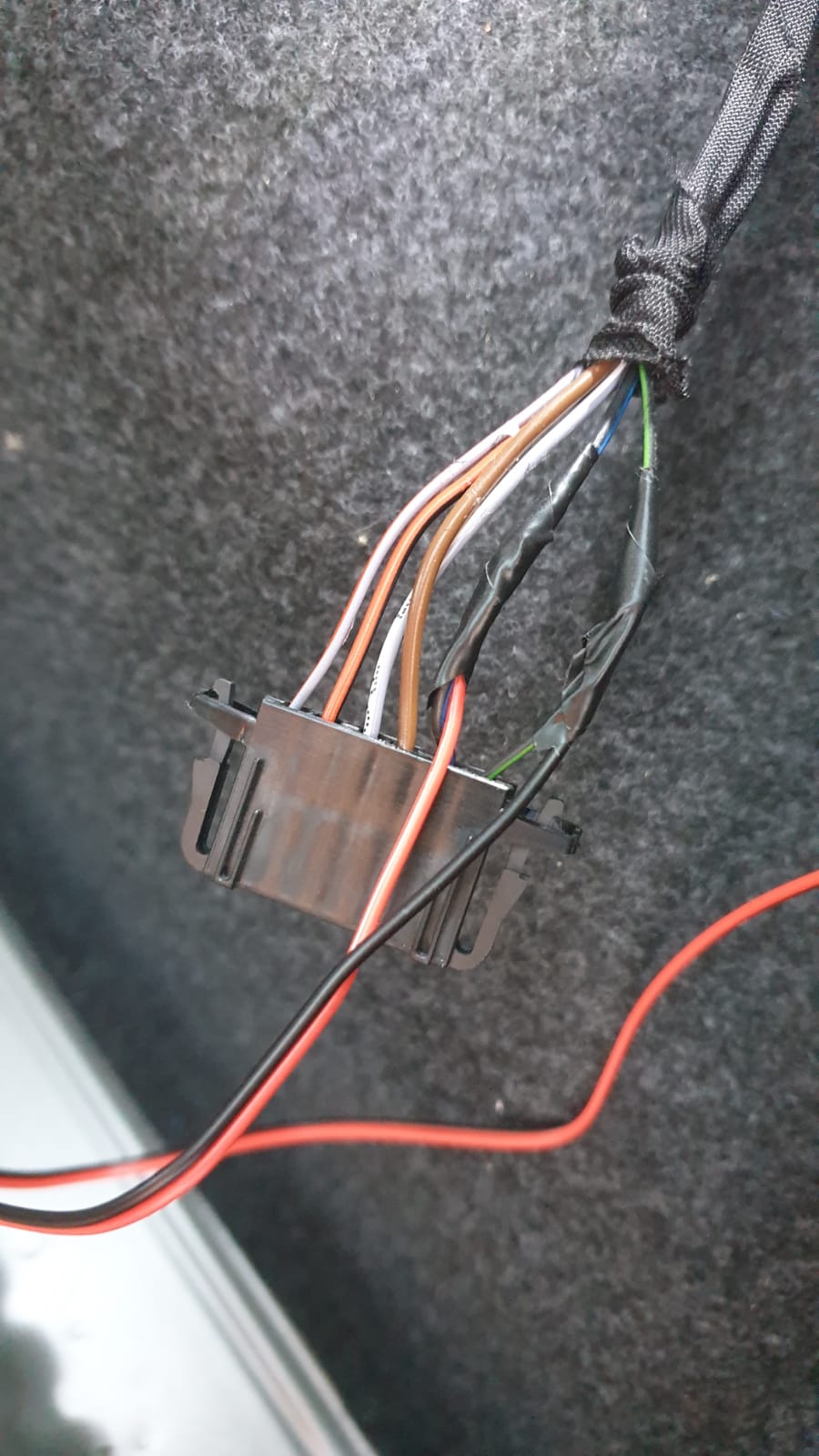

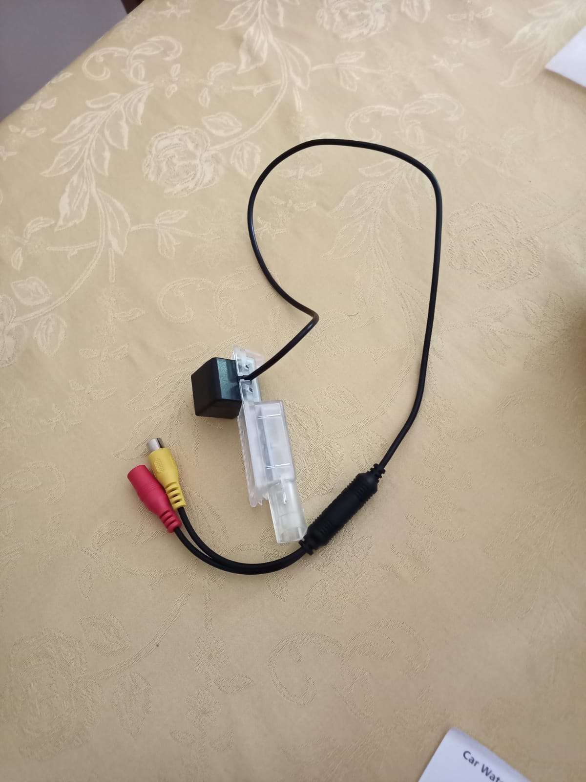

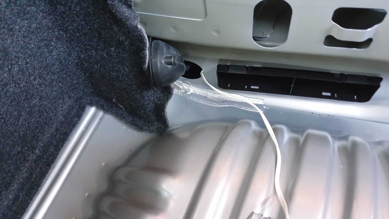

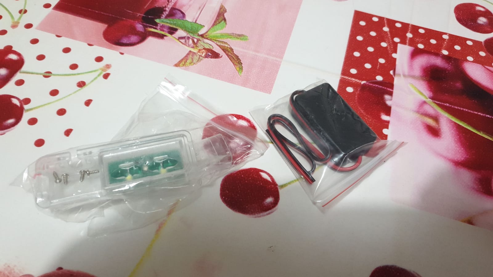

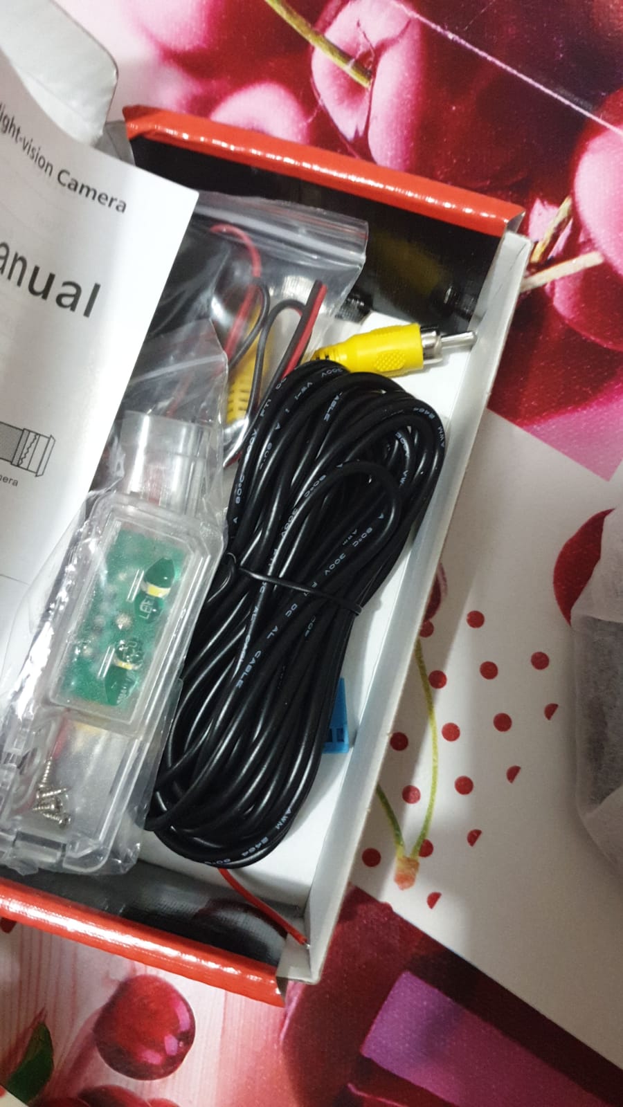

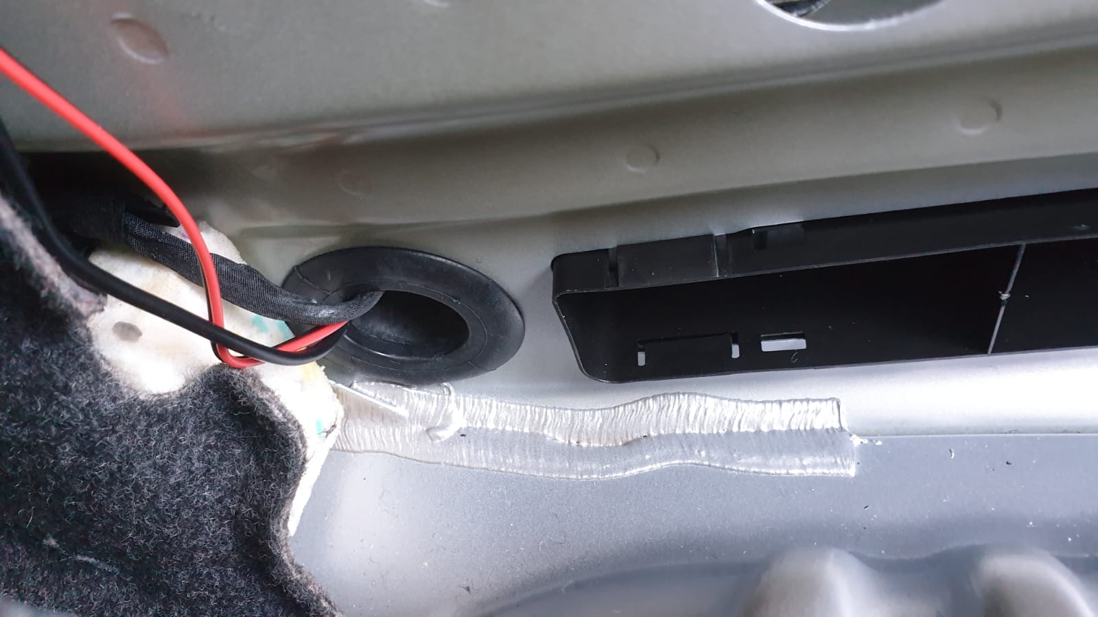

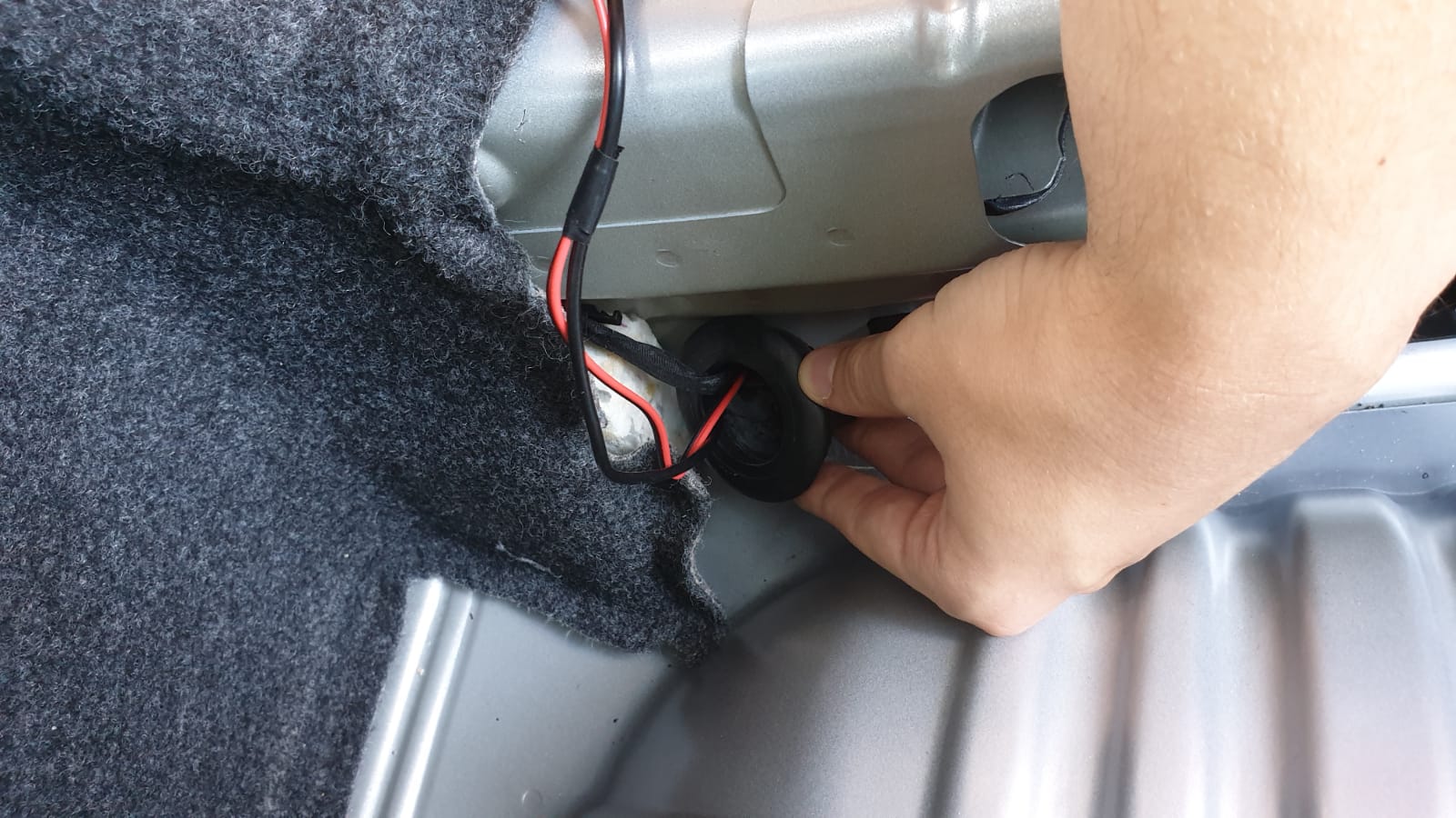

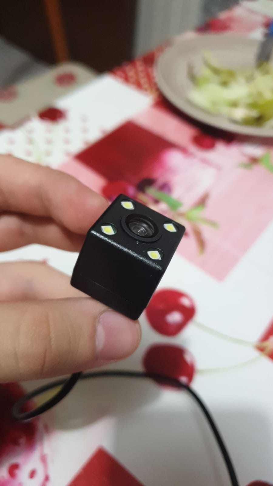

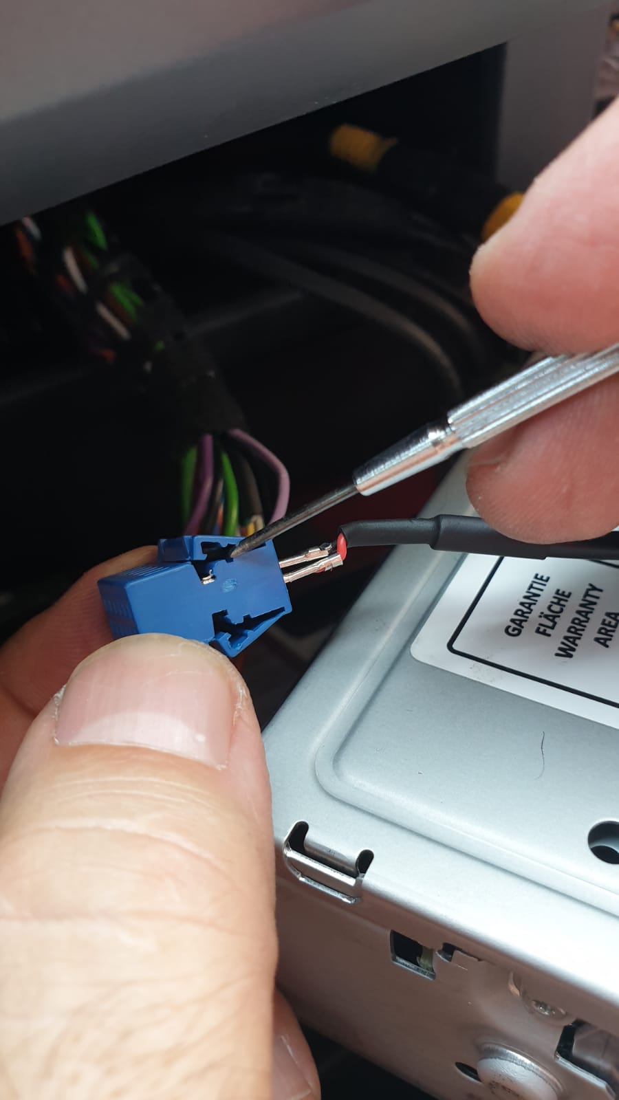

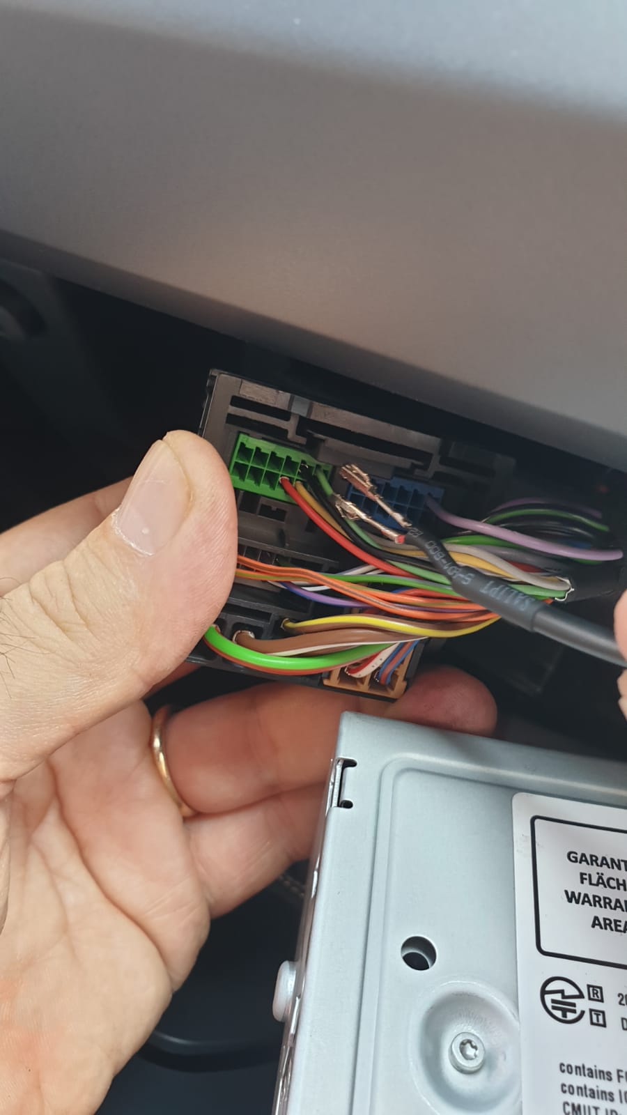

These my wires that i received:
1)
This wire seems too short to bypass from the bumper to arrive near the rear right stop/light...
2)

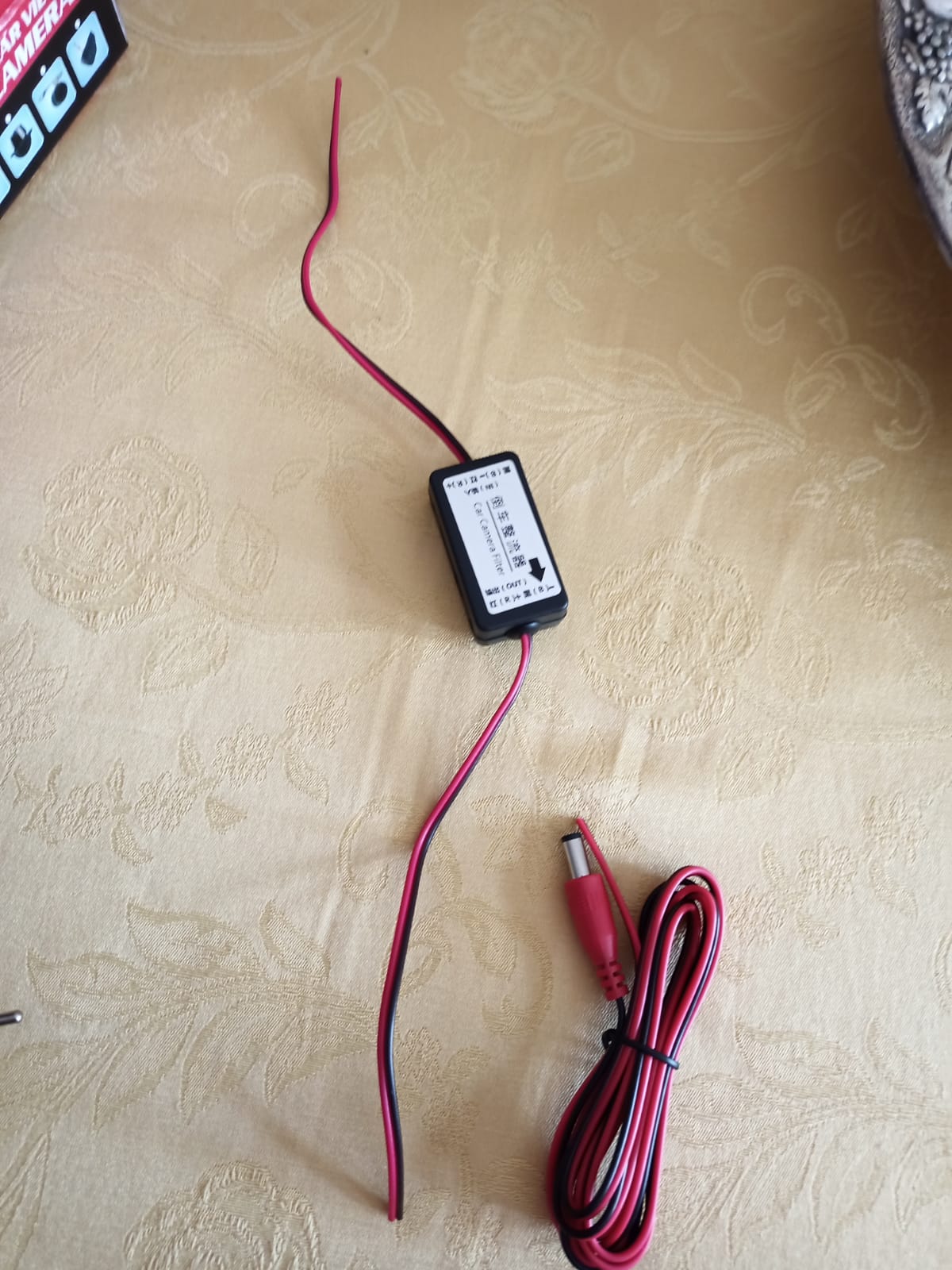

This filter need for what?
Is required or i could connect directly without this filter the two power wires from the rear light in the connector :
wire positive-->black and blue
wire negative -->green and Blue

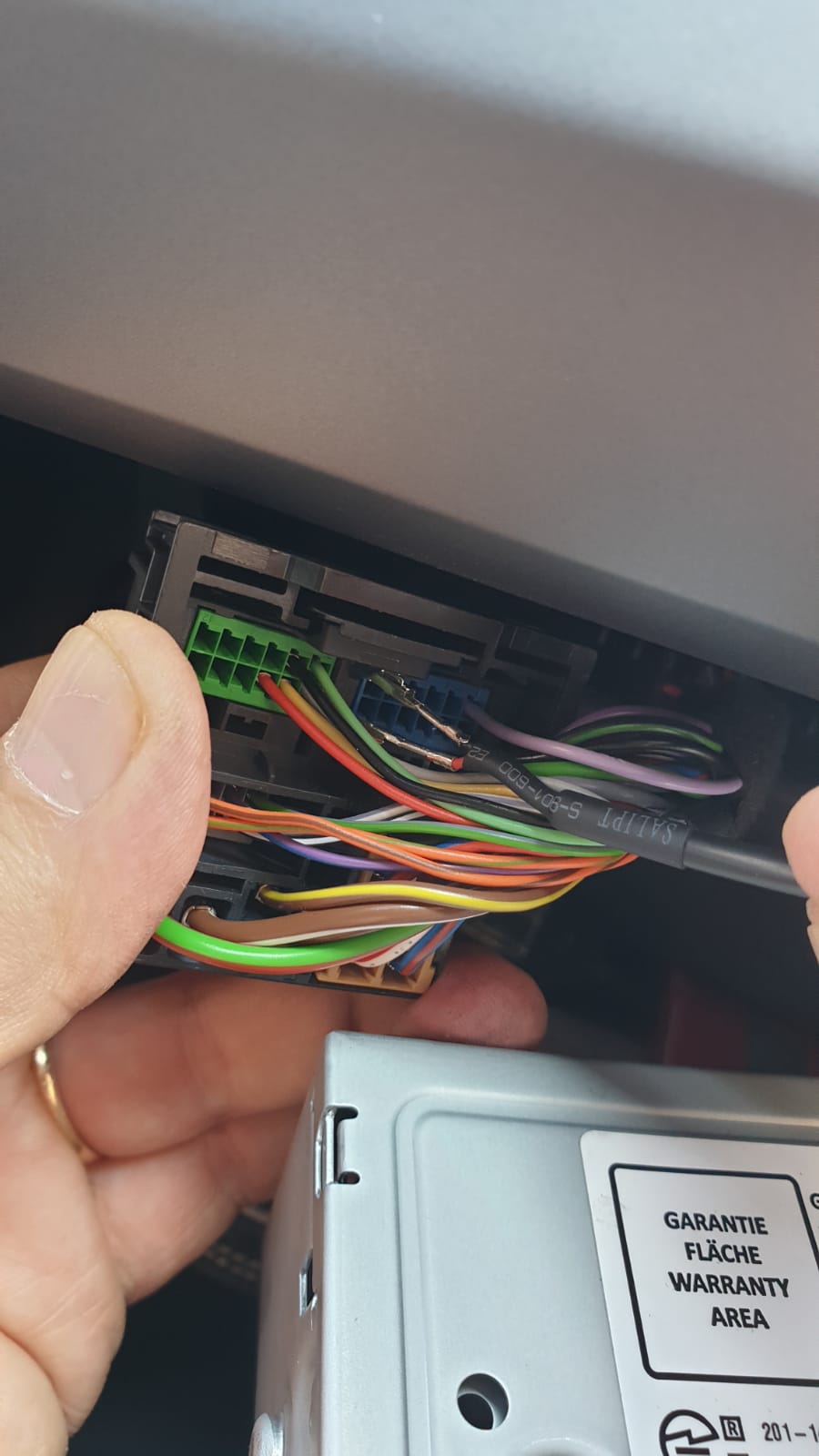

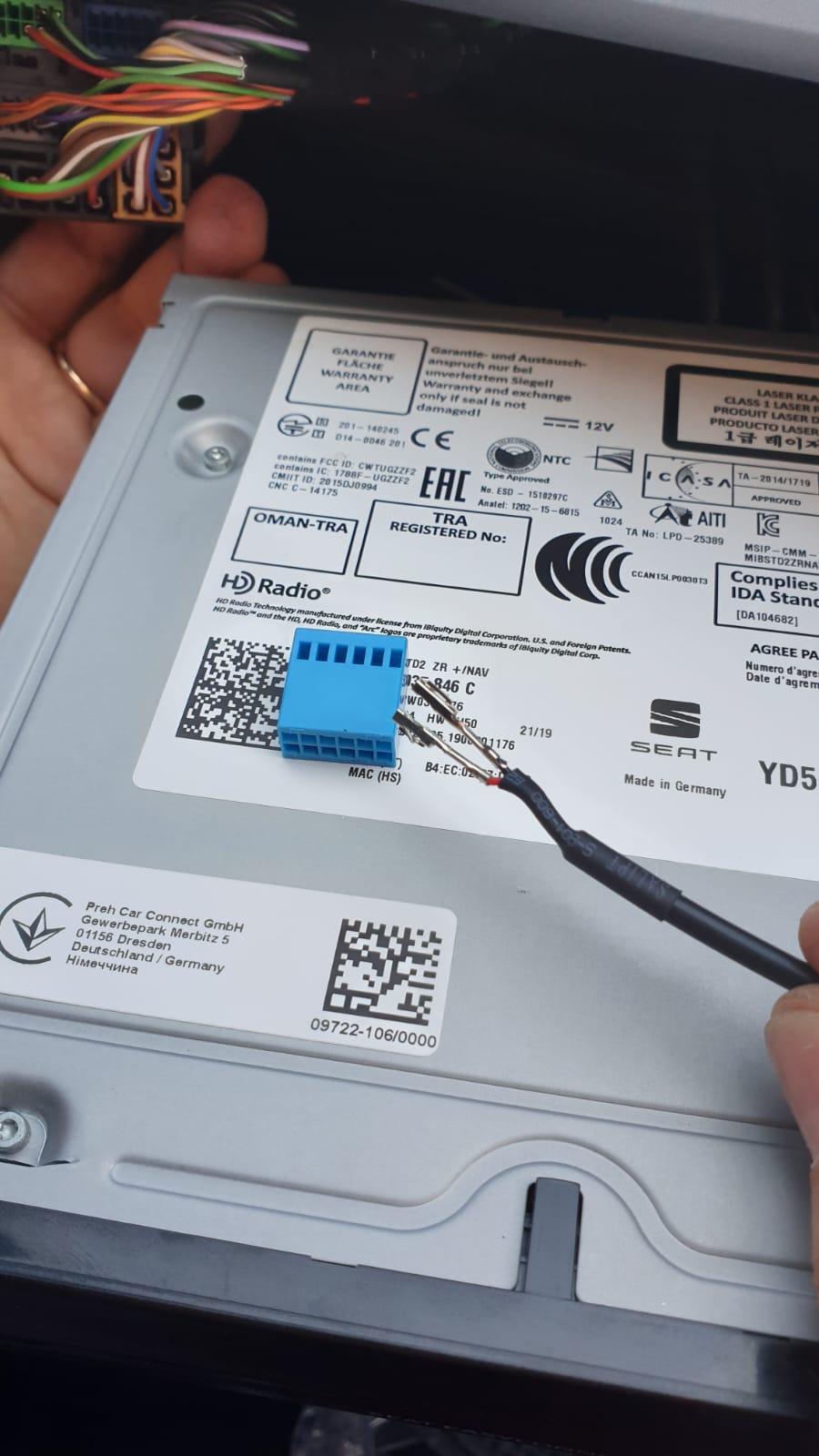

3)

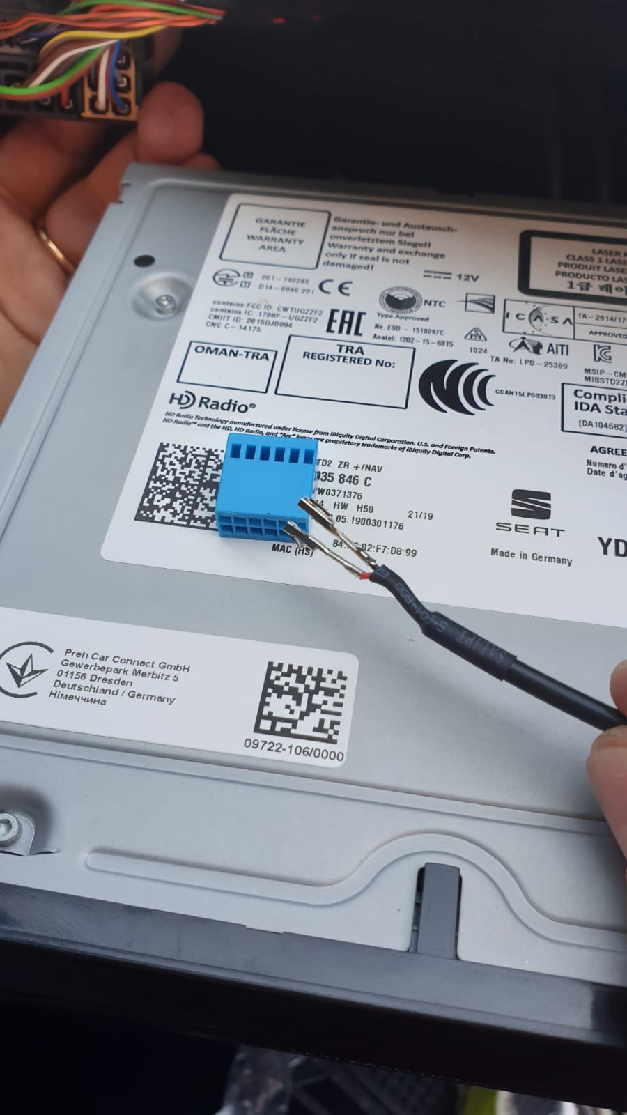

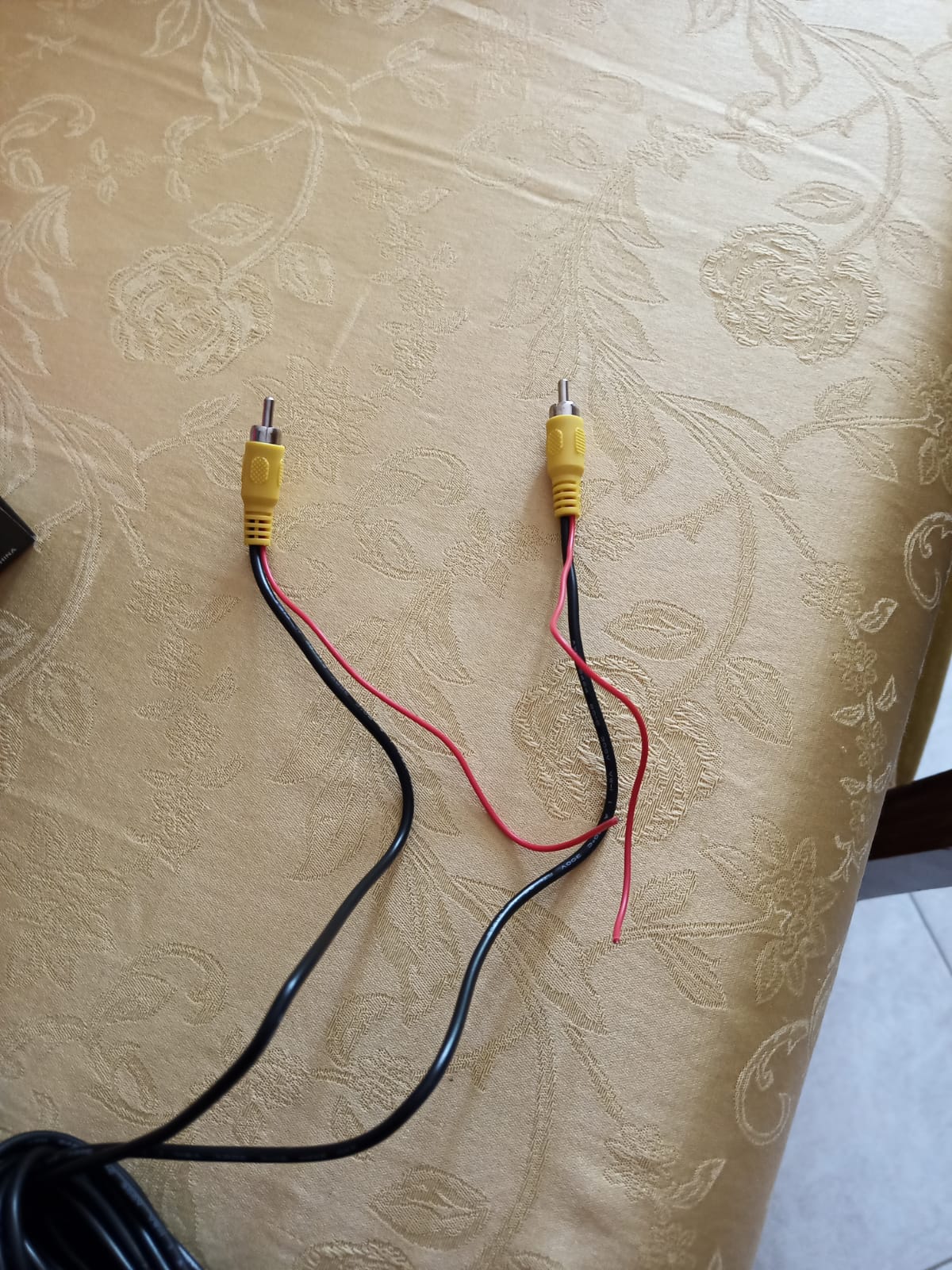

This connectors, one for the rear camera one for the radio connector but the two red wires?
i leave it to your selves?

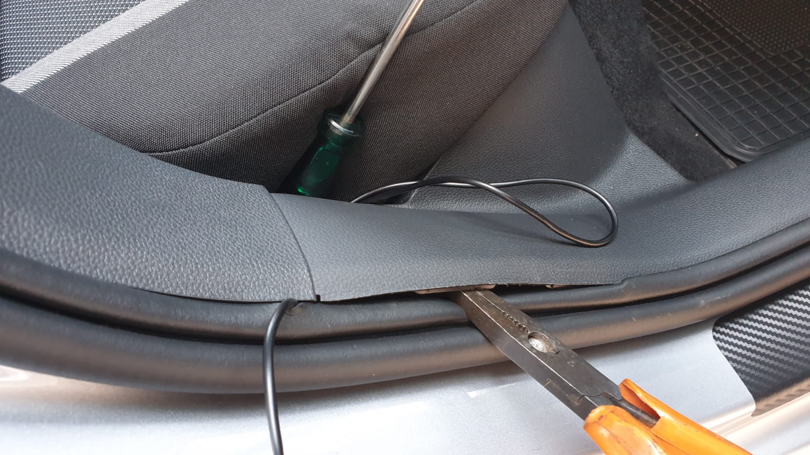

Ok the modding rear camera is been made!
No filter need!
