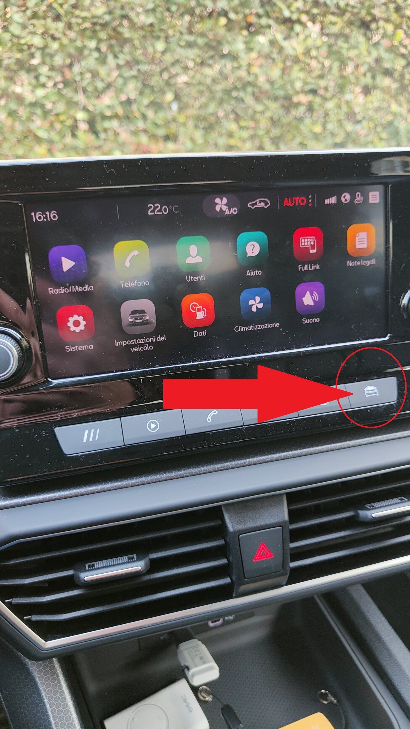

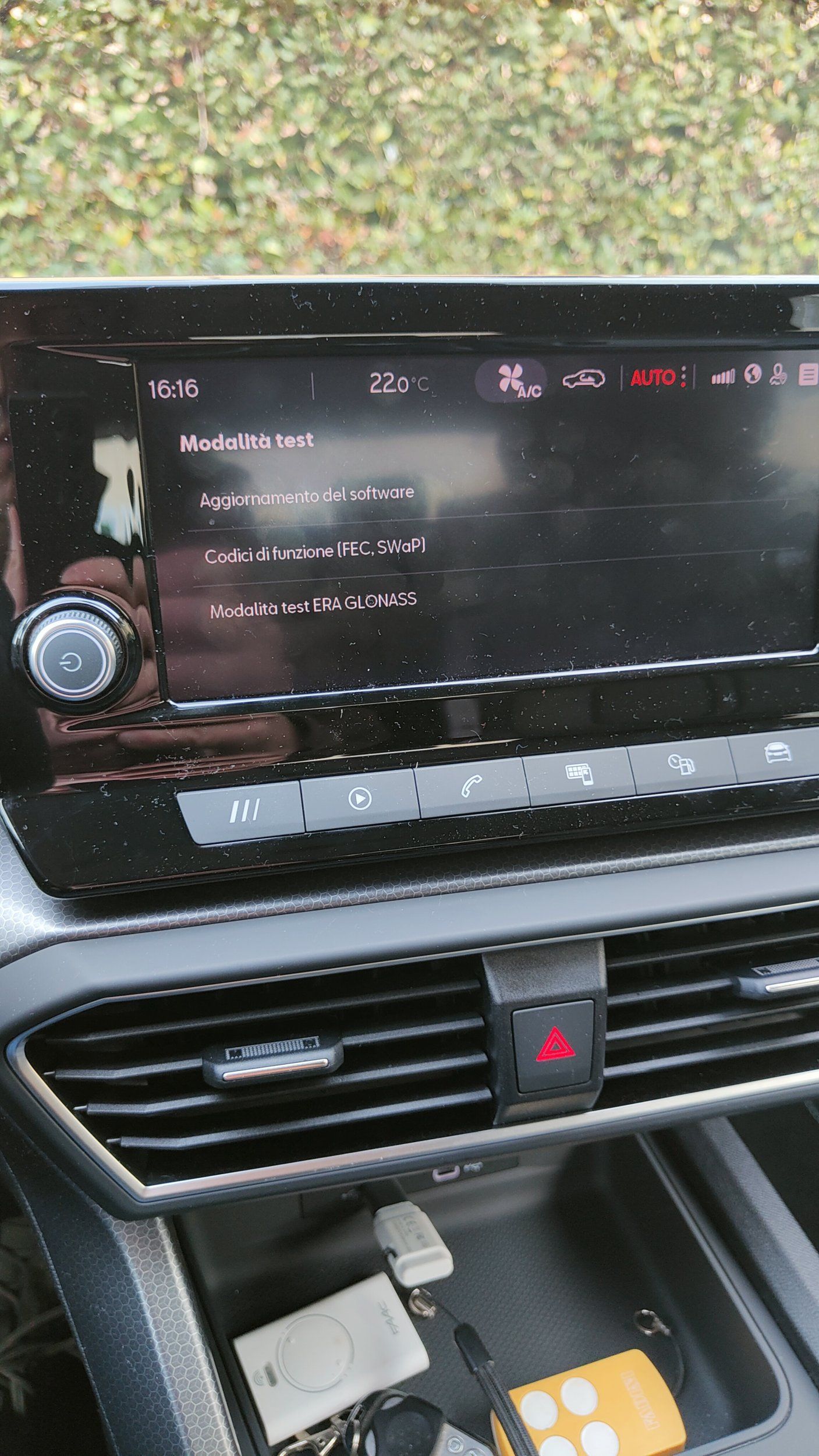

These are pics from my system. The button for have access to service mode is not the "menu button", but the "vehicle status" where the arrow indicates.

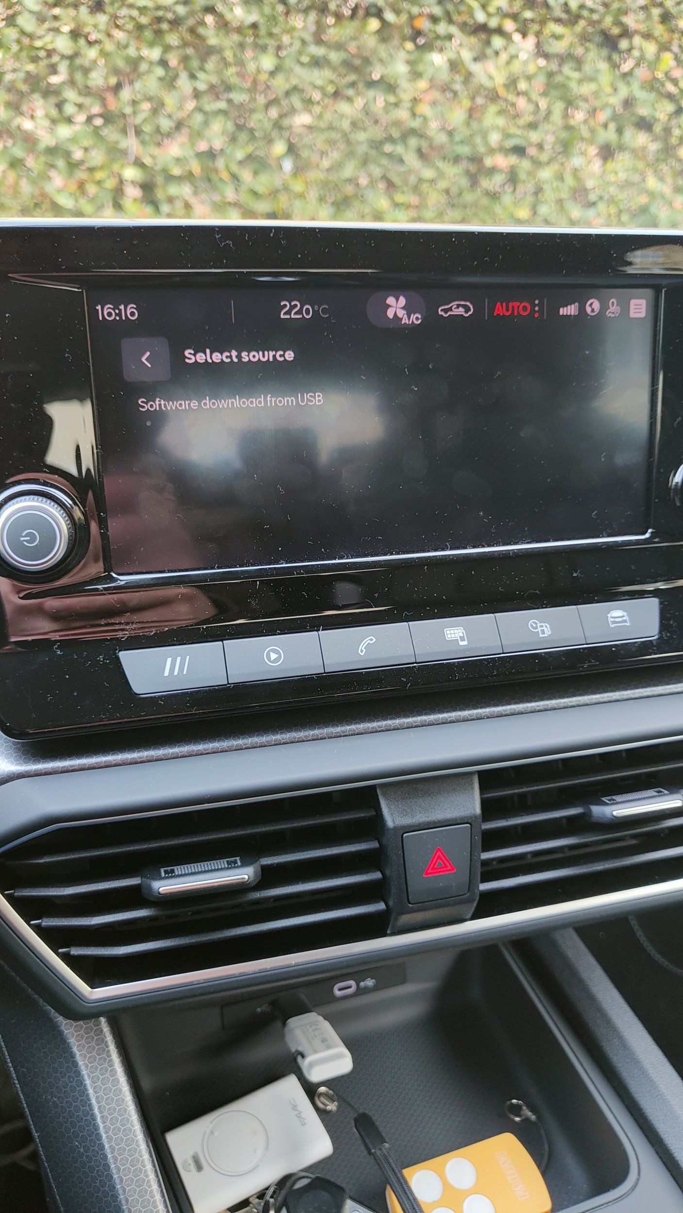

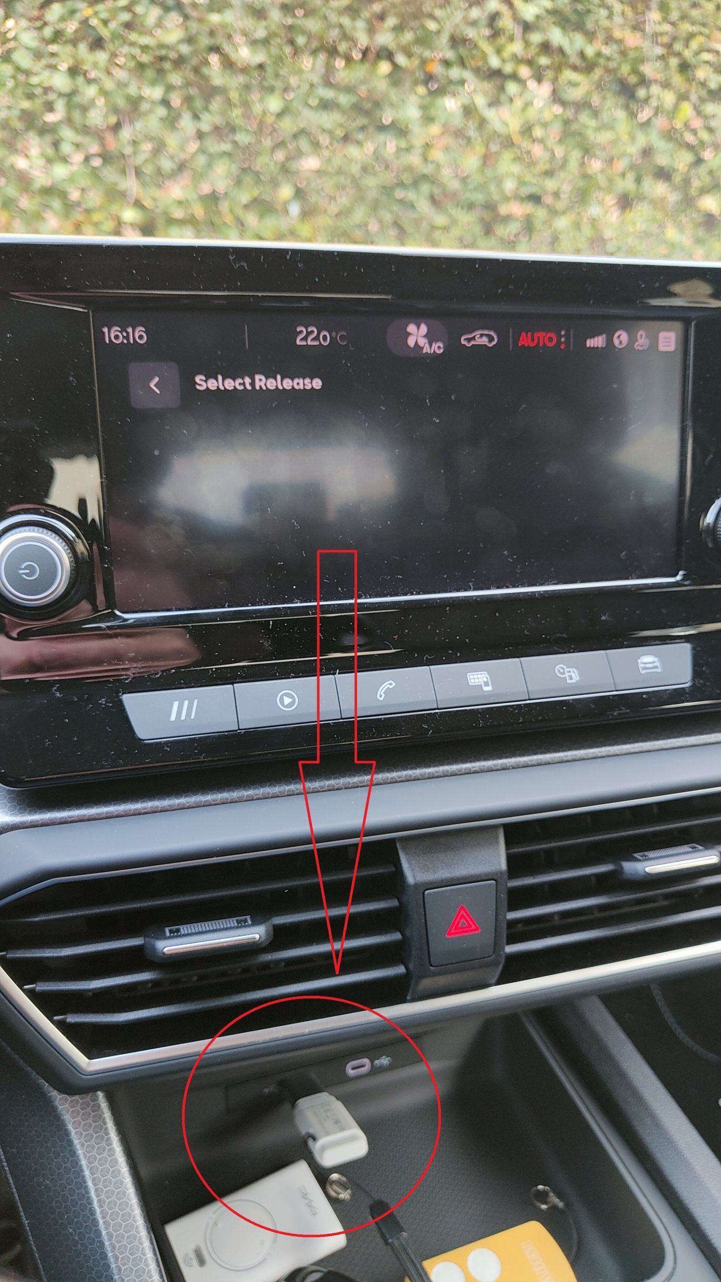

But as I enter in the update module, it doesn't find any files in my USB (already formatted in fat32 and containing MIB 1899 version for an upgrade from the actual 1776).

You have a different infotainment system in your car, I would not advise trying to update it with this file unless you have evidence it will work.

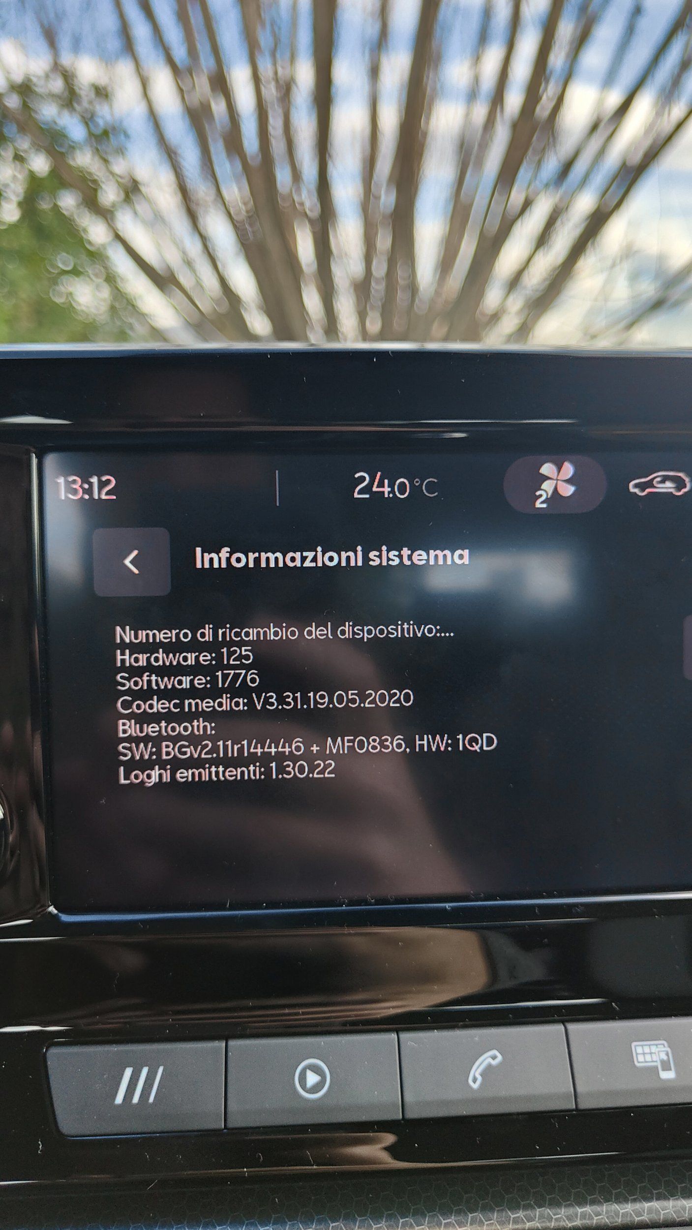

Show software version. Your system not compatible for 17xx 18xx 19xx firmware.
You need 8xx firmware i think so show it please

Thank for your interest! This is my software version 1776, it seems similar to Navi System!
