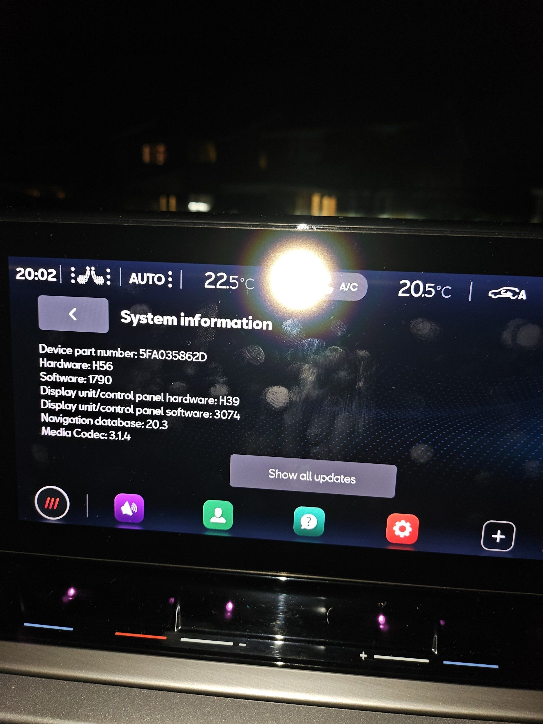

So I have this update got it onto a USB c stick all fine and well. I plug it into the car and nothing?
I've checked the stick it has both files on it. I followed the instructions but nothing is loading up.
This is the right screen?
Is it this screen?
