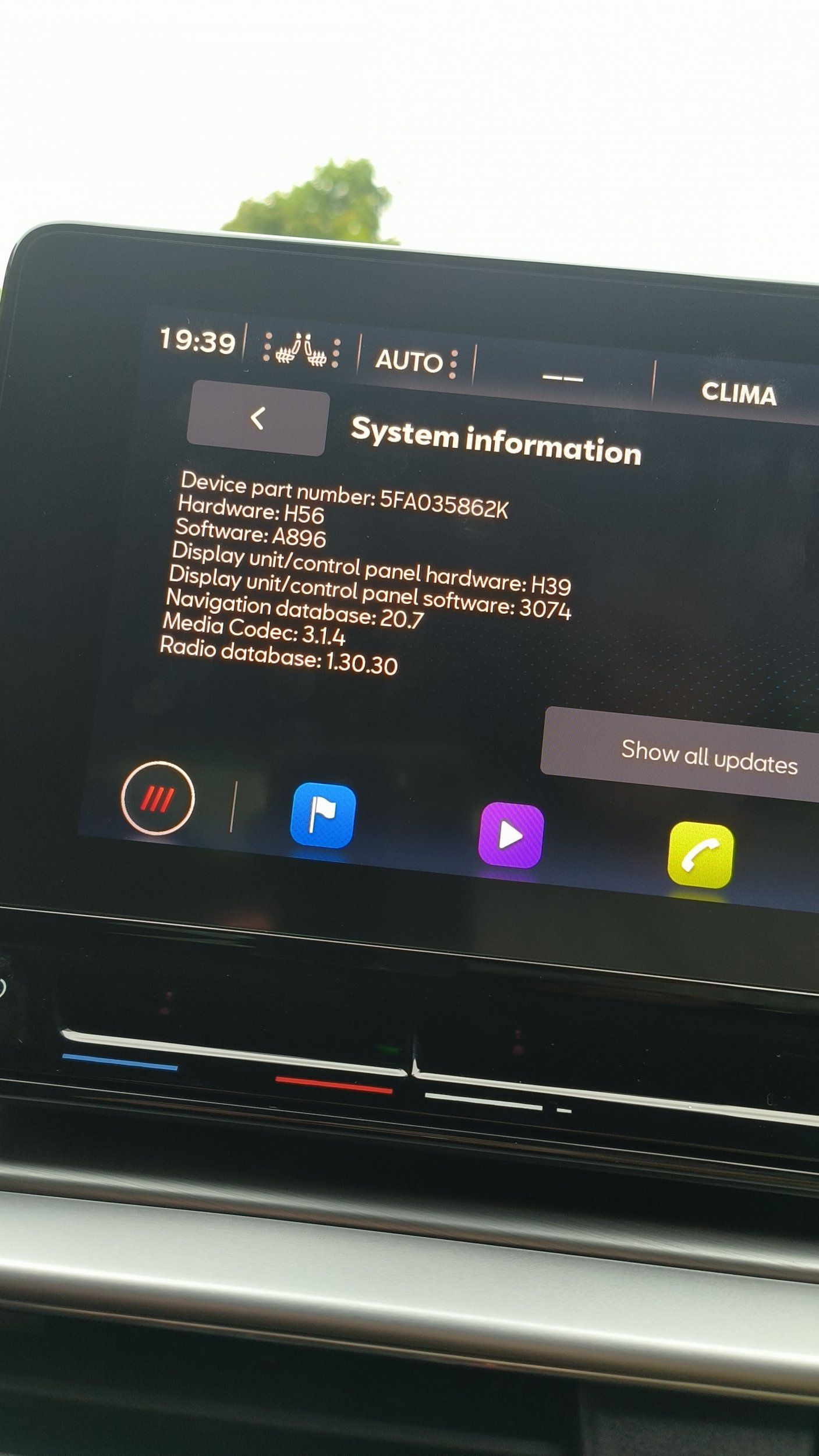

Hi all. Had a 71 plate FR sport 1.5 ETSI dsg delivered today. Sadly I couldn't see the car in person as no Sports near me in Leeds. So came from Wales.
Dealer (Seat) promised me the software would be updated to the latest. Seems they didn't do it....(That and some minor paint issues on the back bumper)
This is what I have. Any easy way of getting it updated (car was Seat approved so has 2 years warranty, but assume unless I have issues, they won't update it at my local garage?)

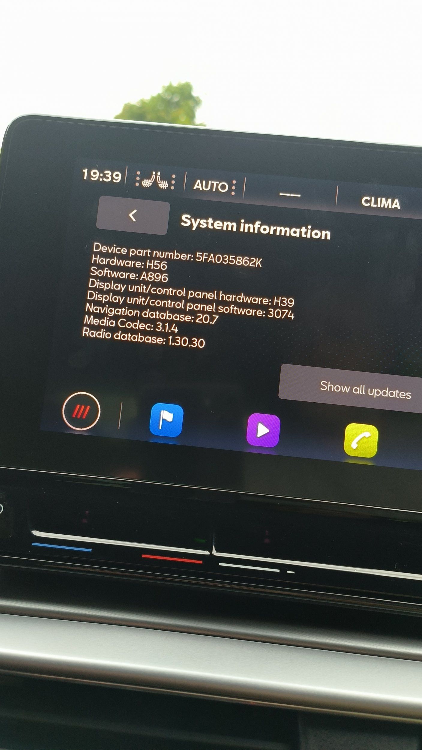

This is what I have. Any easy way of getting it updated (car was Seat approved so has 2 years warranty, but assume unless I have issues, they won't update it at my local garage?)View attachment 43249
I think your system is so out of date that it won't progress any further with OTA updates. It needs to be done at a dealer. Ring them and ask them, they should do it. Mine was the same. After that it will pick up further updates OTA.
Also, it's perfectly normal to want to smash the car with a sledgehammer and set it on fire before you get those updates. I promise you it's a million times better afterwards. I love my Leon now. ❤️
I bought my Leon with the same software version. I updated it to version 1969 without any issues, but to be sure, I first updated it to 1940 and then to 1969. Everything went smoothly.
Sure if you are confident/competent enough to upgrade yourself but many won't want to take the risk. Even workshops are nervous about doing it. My dealer had one car brick when power went out in the middle of an update. They can't claim from SEAT when this happens.
