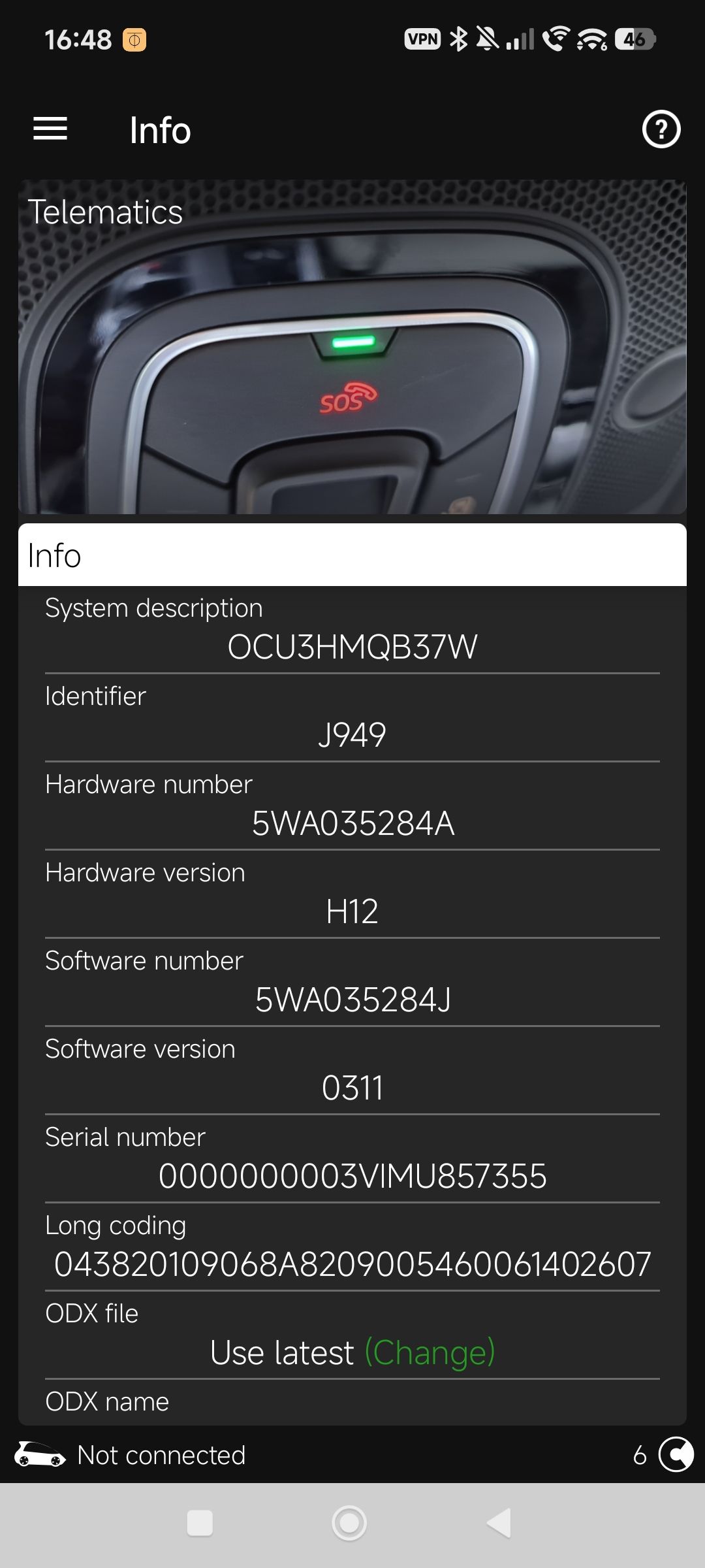

1 month later update... had a software update OUN8 offered to me when I started up the car today, updated it and upon startup the SOS light is now gone!
Yes. The OCU 8 update fixes the SOS error. The software version is now 311 (previously 144). You must log in again after the update. Some users have their ambient settings removed and radio settings.
