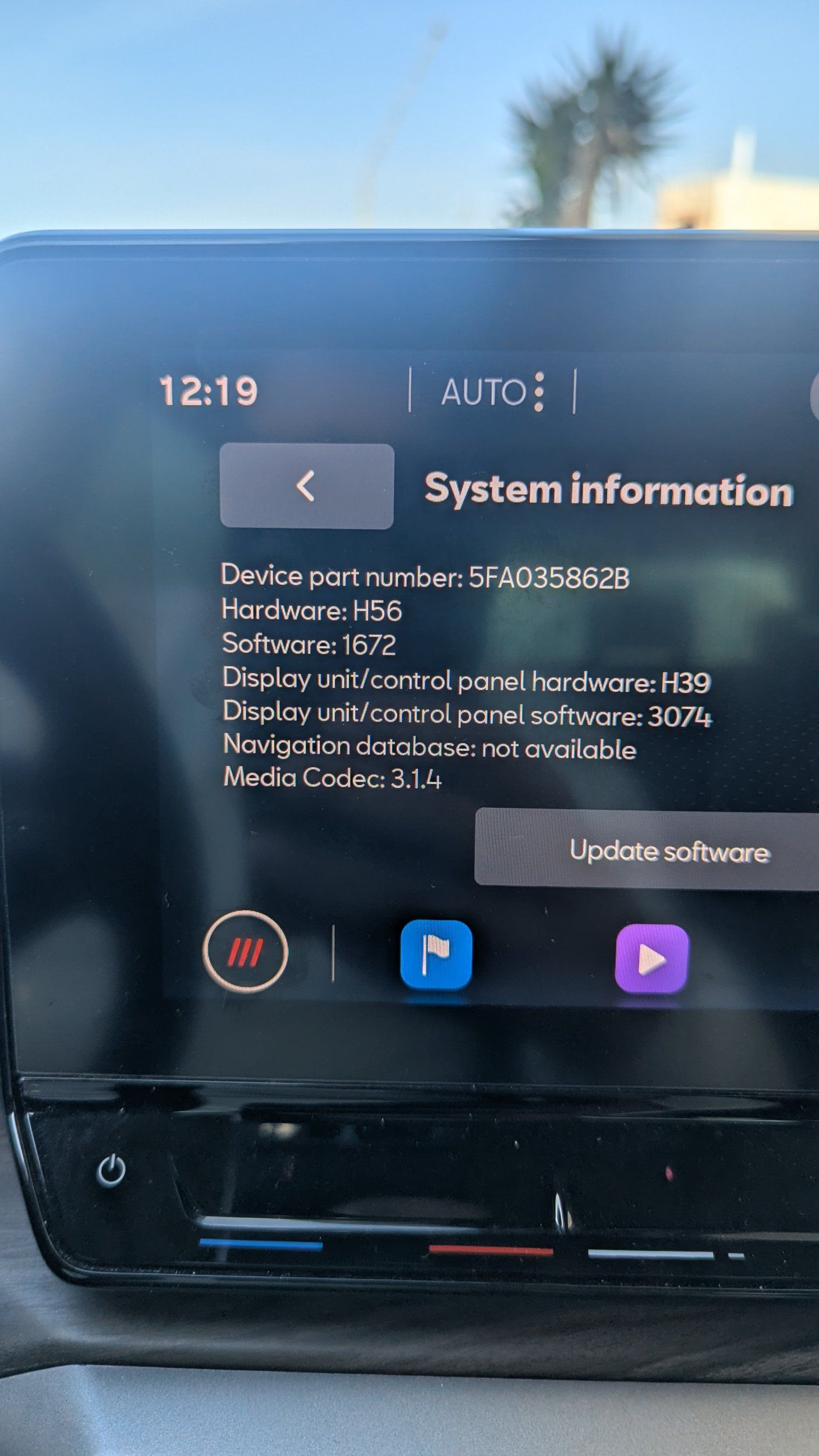

I have seat leon 2020 mk4 with update 1672, please your help to update my software version.

I need firmware work with 1672, i tried 1899, 1940, non of them works.
I think I should upgrade to 17XX first, if you have one.
Nope, when the software is as outdated as yours it will require a professional to carry out an update as even if you could update the infotainment the TCU also requires an update which requires ODIS otherwise you’ll have faults.
