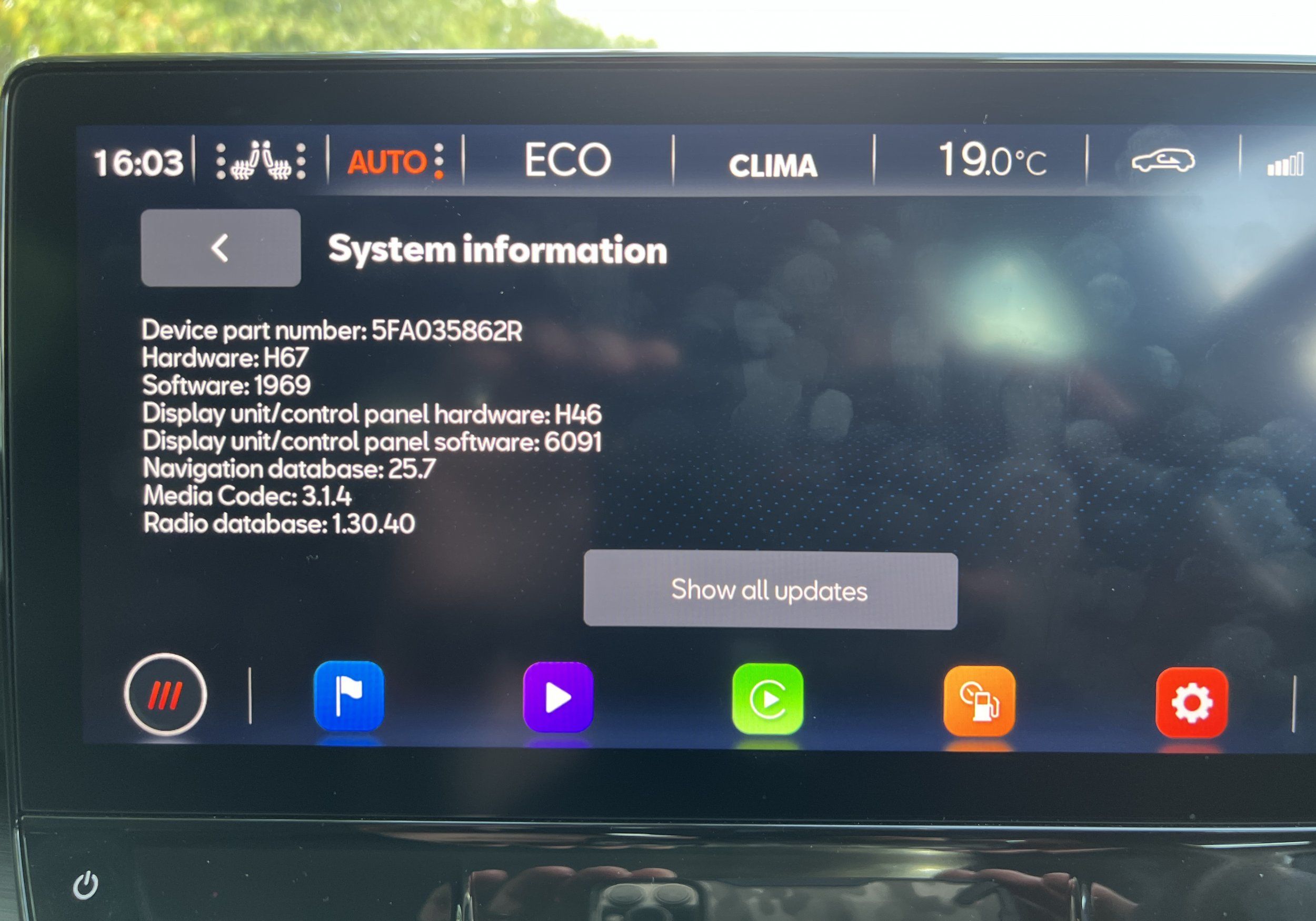

Hi, I‘ve been waiting (im)patiently for the 1988 update to come to my car since it was announced, but so far, nothing!
It’s very frustrating as my screen has an infuriating bug that keeps happening (basically, it resets some - but not all - settings back to factory defaults, and keeps starting the tutorial randomly).
However, I notice that my hardware revision is much later than other posters here (it’s H67) so I don’t know if SEAT are delaying pushing out my update, as I have newer/different hardware. Does anyone know anything about this? Has anyone else with H67 received the 1988 update yet?
It’s one of the last of the pre-facelift Cupra Leon eHybrids. I’m in the UK, and I have an active “My Cupra” online subscription.

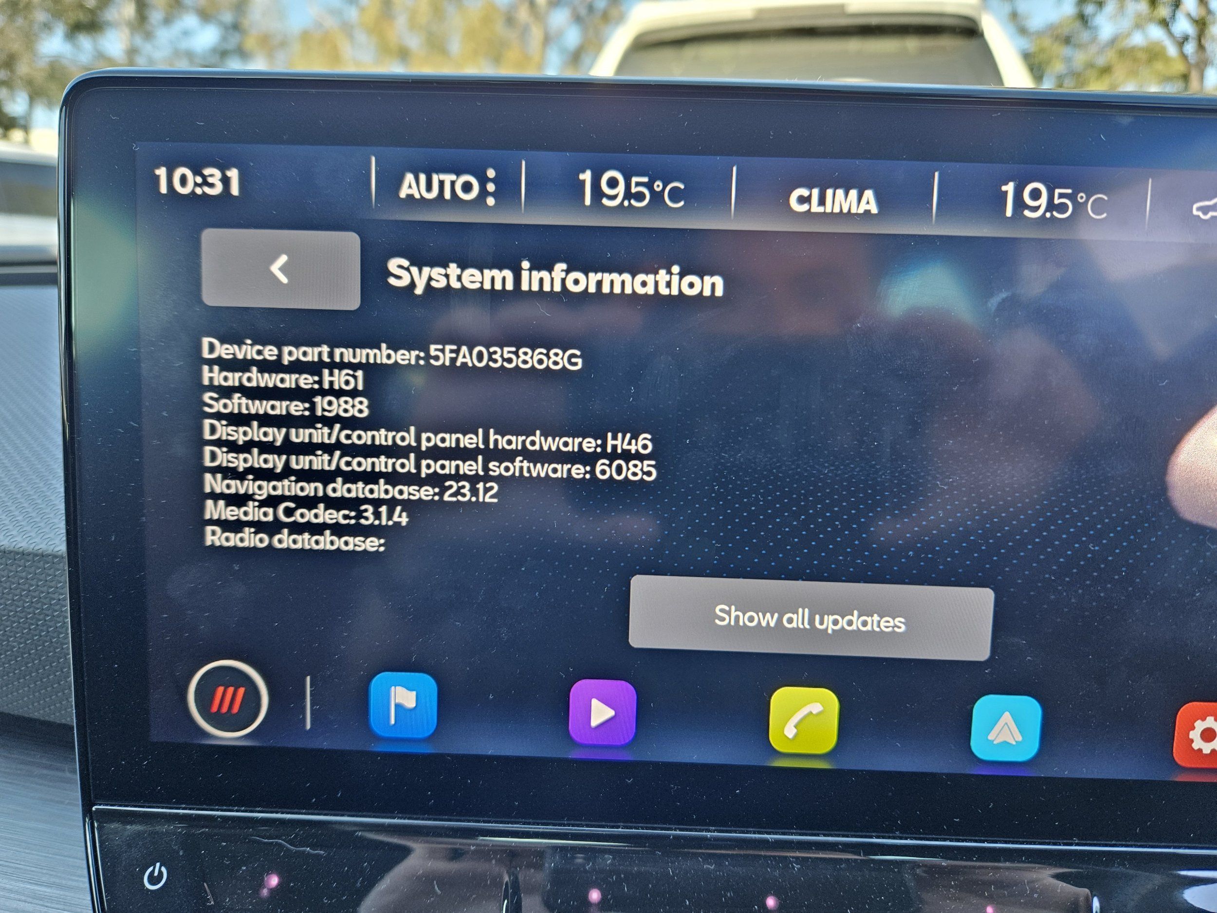

Bonjour à tous,
Je suis nouveau ici. Je possède une Seat Leon de 2020, et j'aimerais mettre à jour mon système. Sauf que dans la catégorie Mise à jour, cela reste figé (voir photo). Quelqu'un peut m'aider ?
Je vous partage également ma version actuelle...
