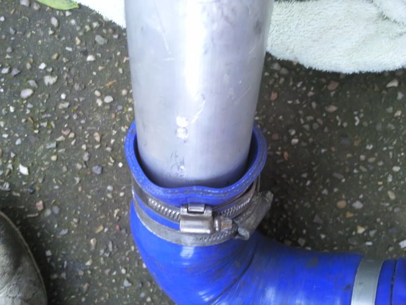

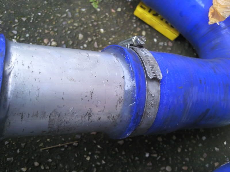

So ive moved on to the FMIC side of things as it has to be that...So luckly i can just undo it at each end and Pop it through so i have one complete Pipe...Tbh i wasnt happy with it as the pictures will show.
When i fitted the Fmic many moons ago i tighten up the Jubliee By had Eg a Flat head screw Driver.so ive got my self a small rachet to do them up super tight and i couldnt belive how loose they were..
Also a mate of mine also told me to use low Module Clear silicone around the joins to help it abit...He works for chorley street garage which builds cosworths ect
Here are the Before pictures..but ive know moved the Jubliee clips abit closer to the end of the pipe and done it up super tight so they all sit snug around the pipes ect not like before.....Am just waiting for the sealant to dry then il fit them and see if its worked...
The Join in question
Sealant Joins all are like this now if it matters or not
hows they are now all done up supper F***ing tight:

that hose is just too big.
filling the gap with silicon is... well... a bodge.. (cosworth would'nt dream of this fella, just some blokes working on cossy engines does'nt make that a good thing to do)
why cant you get the right size of hose or pipe?
