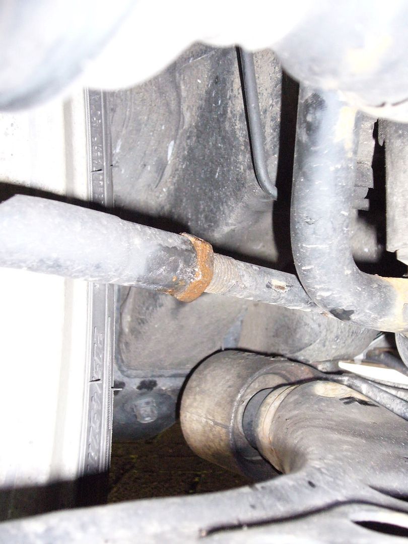

Yup, 35mm H&R springs, pretty sure that's the reason it'll start rubbing, and probably get even worse if you completely slam it to the ground. Doubt there's much we can do except maybe fit some cushions, or limit the full lock. Anyone got any idea if you can change the full lock positions?
I have just fitted some heater hose around the track rod for now, not ideal but better than metal on metal
