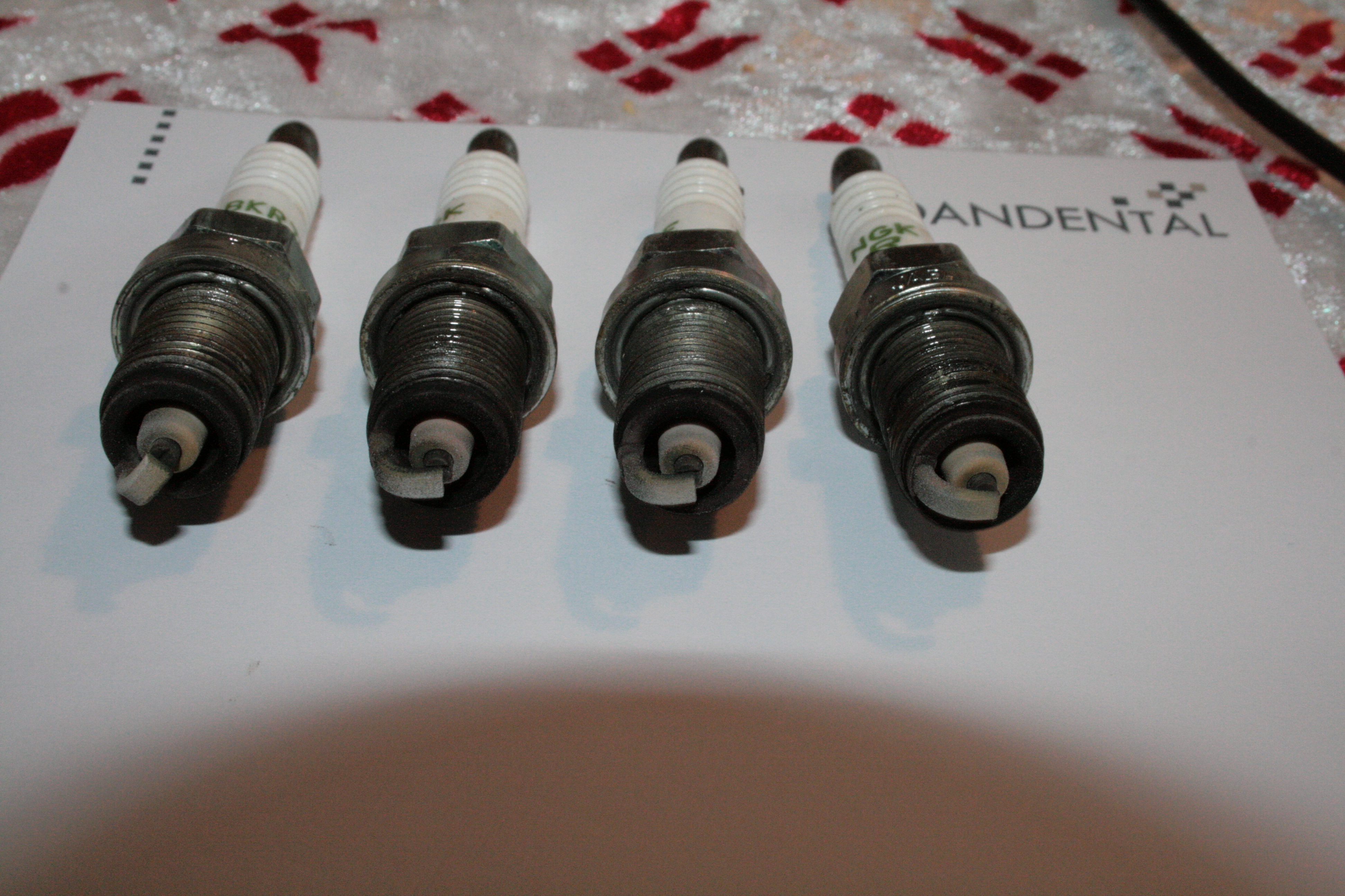

Yup I guess it could. But I just have to think back... But it could also be a faulty 02 sensor, but my sparks plugs I changed 2000km ago didnt lie.See link
Btw. No fault codes at all.

the data obtained form vagcom is more detailed than a colour check on a plug. More importantly the plug colour is the result of fueling across all driving conditions not specifically under full load which is what we are discussing here.
