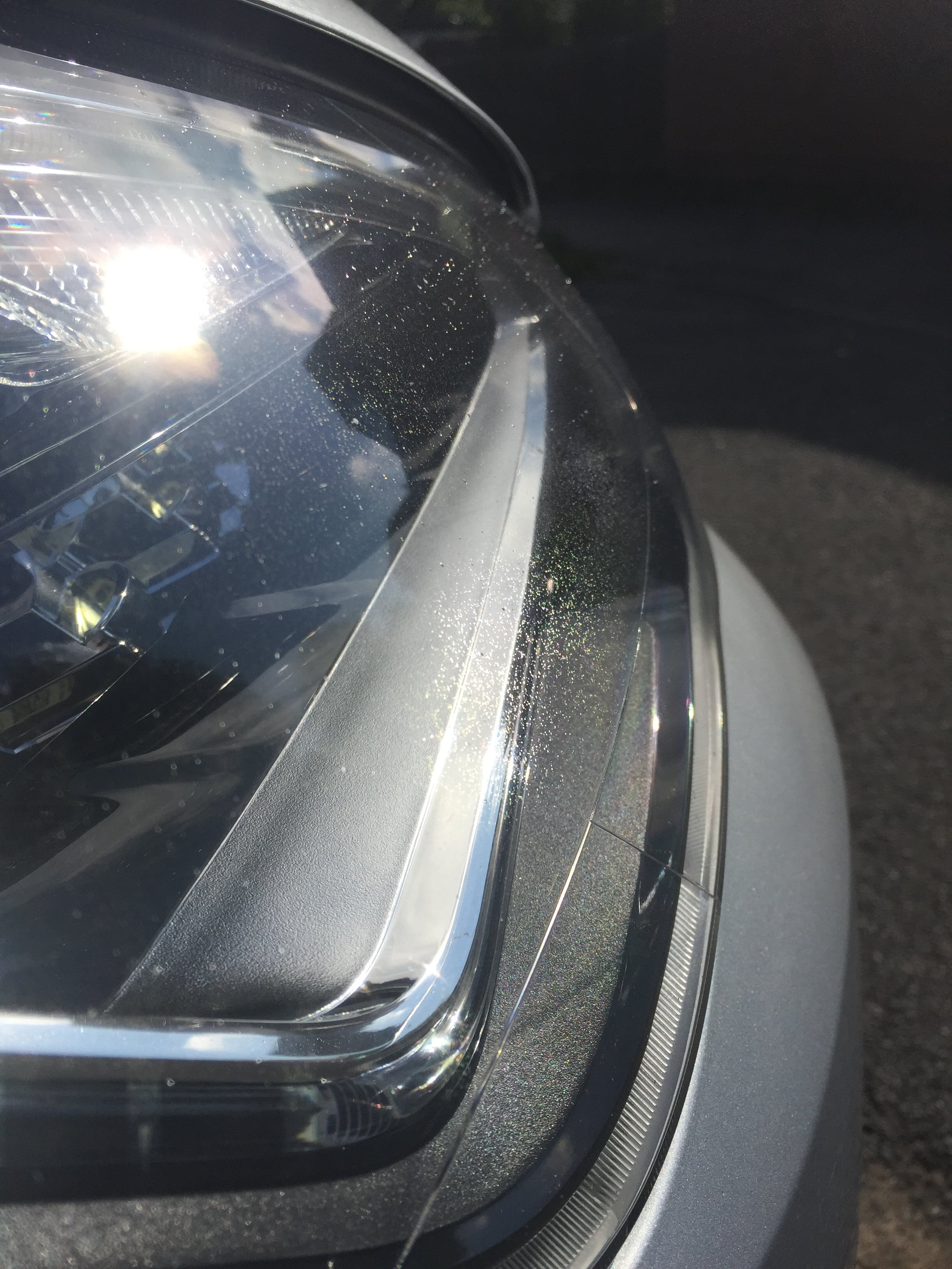

Little bit difficult to see in daylight, but the dusty effect in the lenses you can just about see is inside the unit itself. They are the sealed LED units with all tamper seals in tact for the rear access pannels.
Yep that’s not dust I have the same issue. Will take some pics tonight. I wonder how long until mine will fail it’s MOT. Looking head on they’re ok but from the side it looks awful, shame because I really like those lights.

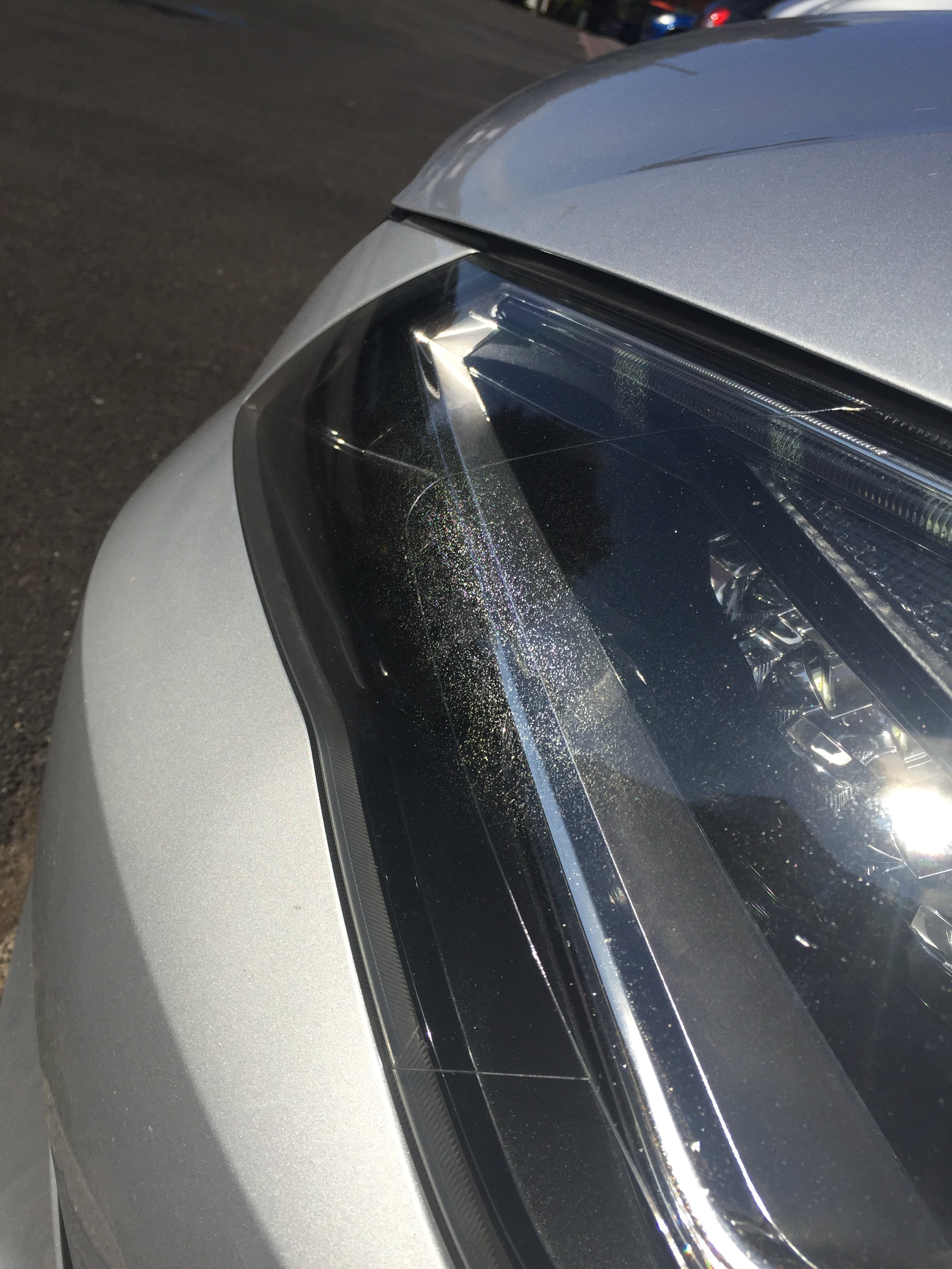

Here it is. It’s terrible, definitely got worse over summer. Perhaps I will enquiry with seat but it’s a MY13 car.
ZK_FR150
Apr 16, 2016
220
32
That doesn't look great at all, mines a 2013 and I'm on 118k - 90 miles commute to work everyday for the past 3 years and they don't have any dust in them.
I don't understand how that much dust can get in them as there isn't even a way for it to get inside from looking at the back of the lights due to it being sealed.
Seat should really honor warranty on this as the manual states they don't need any maintenance for the lifetime of the car, yet they told ryzie they are a serviceable item :s

I wish it was that straight forward. It’s in fact crazing of the clear acrylic. The cracks are not on the surface or inside but within the acrylic. I’ve had a close inspection, my rear caps have a tamper stickers but they’re peeling off but no point in me opening them. Interesting to find where the vent could be. I have no condensation issues maybe on cold mornings but this clears up rapidly.
