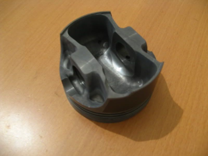

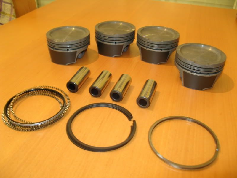

Mahle motorsport 83mm,92.8mm stroker pistons

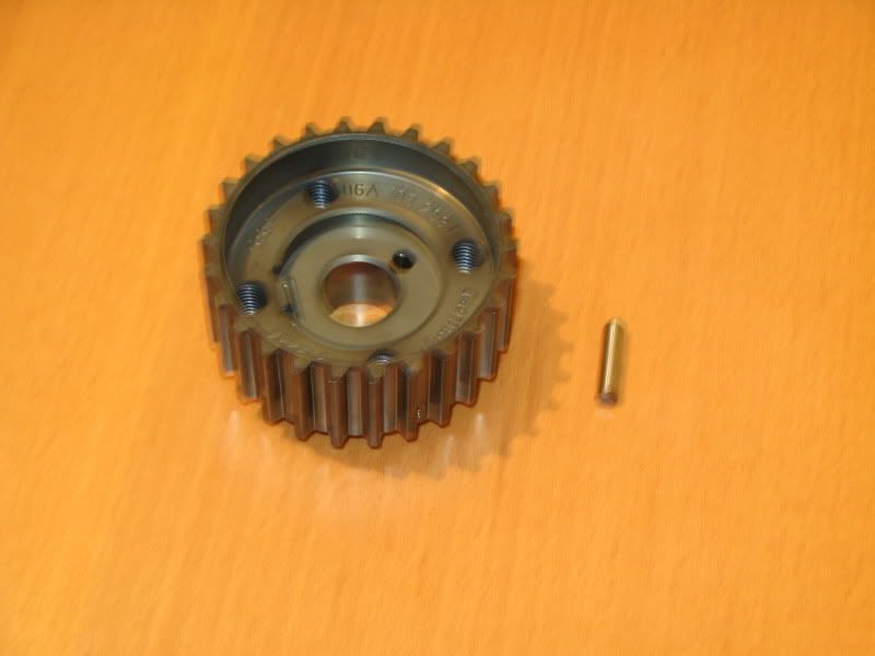

I drilled the timing gear for a dowel pin (need to take the crank in to my shop to get it drilled as well)

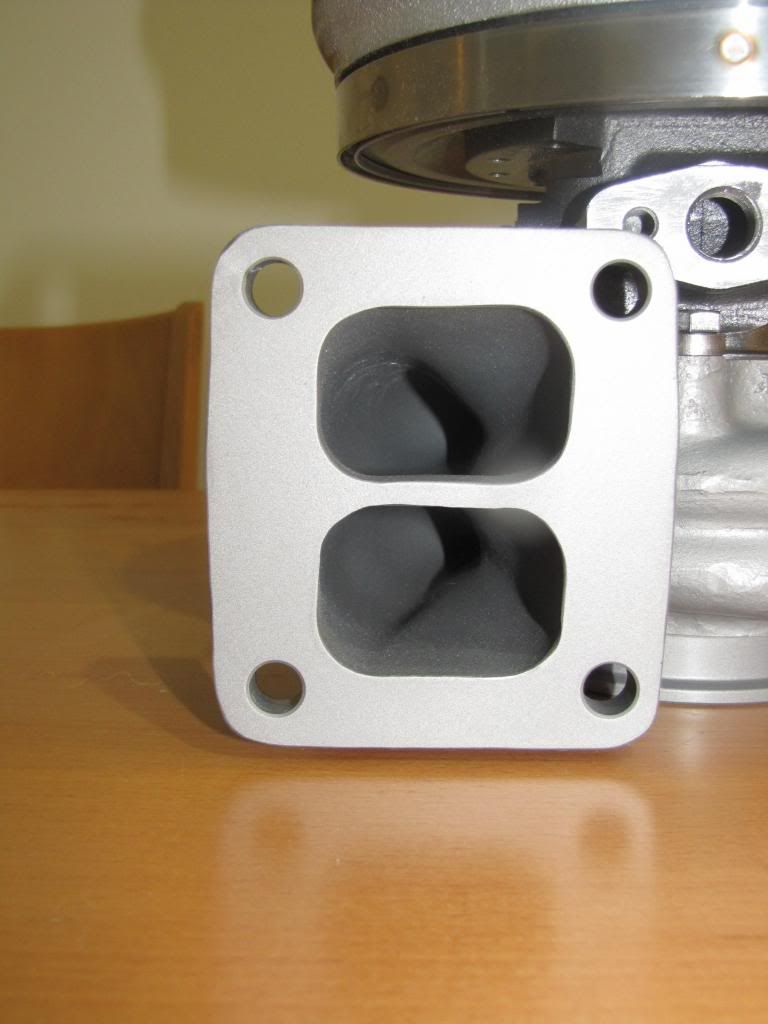

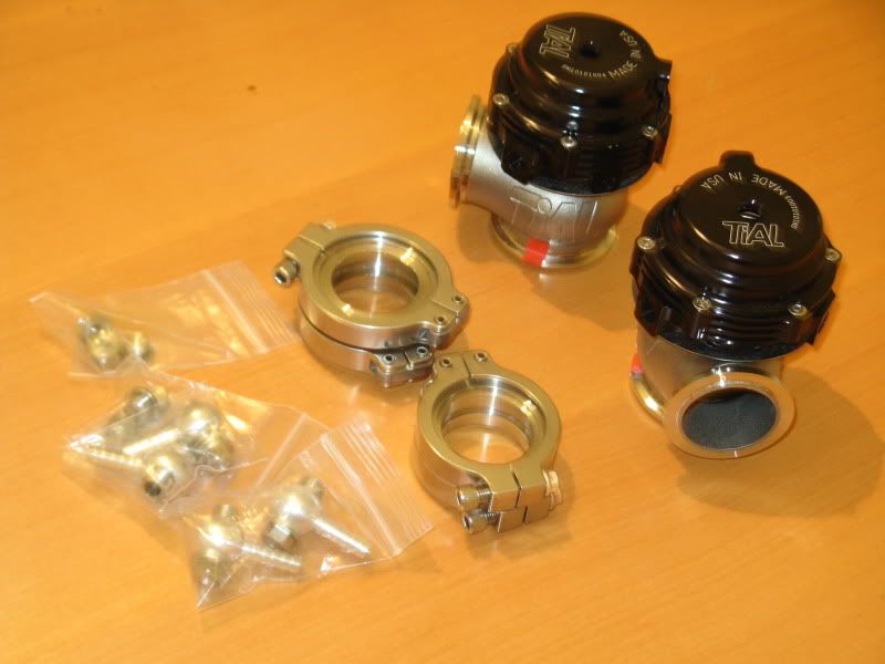

finally a pair of Tial 38mm MVS WG's why two? because maybe one day my phantom turbo will show up. we are talking about a BW 8374 EFR turbocharger backordered already 9 months [:@]

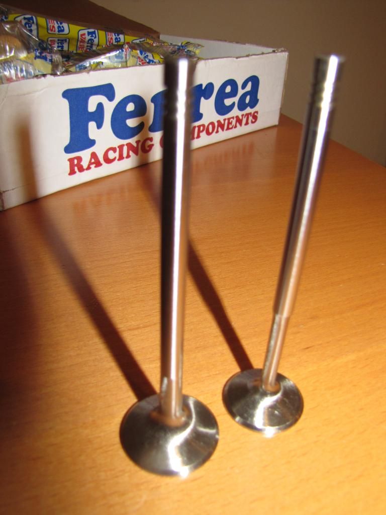

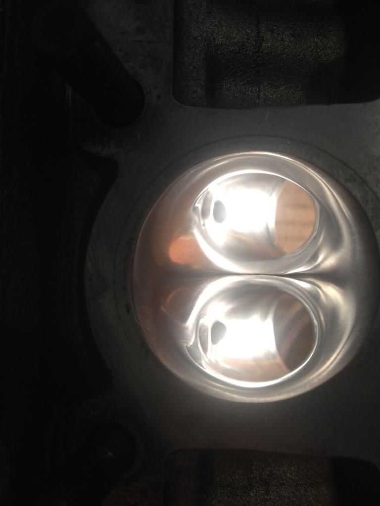

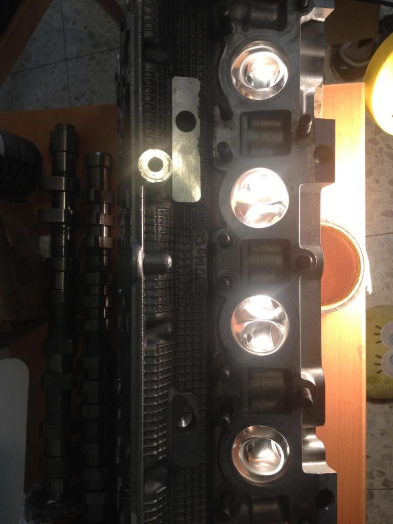

starting to finish the work on the cylinder head, I got a set of Ferrea valves for intake and exhaust also I did some extra port work to smooth out the exhaust port's and combustion chamber all that is left is to Install new guides and upgraded valve seats

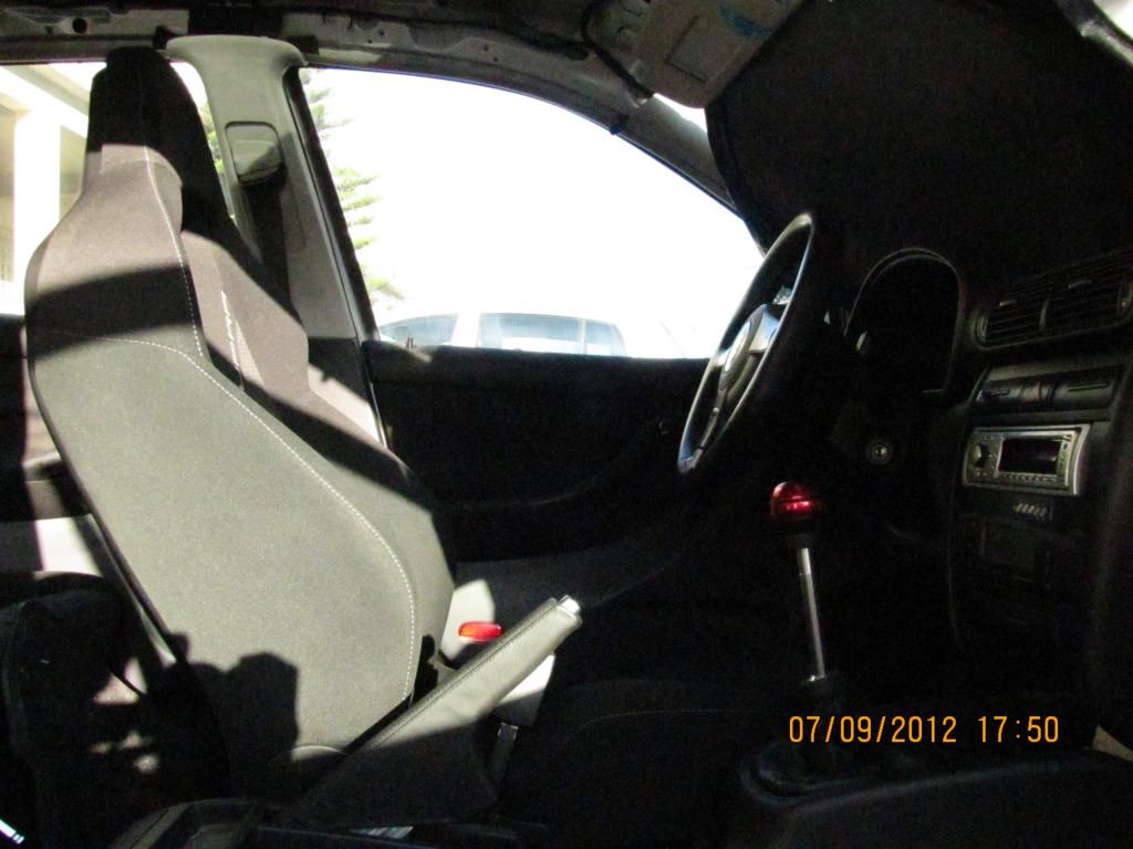

I also finally attended to install my SQS sequential shifter which is awesome and makes shifting much smoother and easer, love the fact I can't miss shift any more
i also got a new shorter shift leaver for it and got it moded to fit the O2M

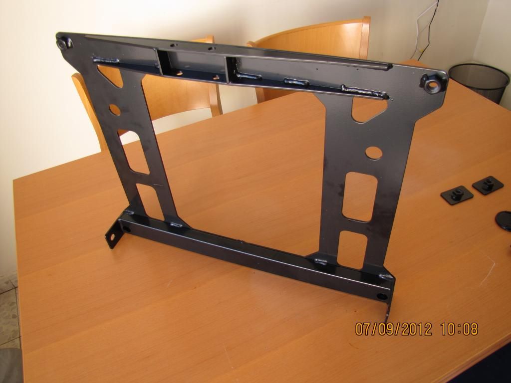

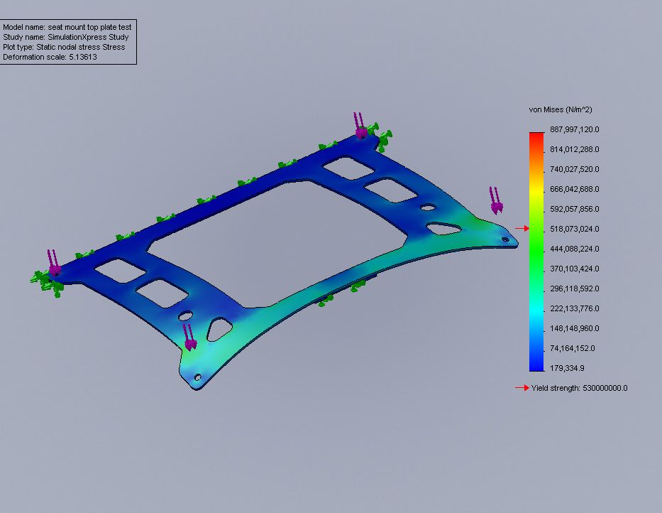

also managed to my hand on a pair of 2011 Seat Cupra recliner seats I had to custom make the mounts myself because I didn't like anything I found in the market and there actually aren't any mounts which are specific for the swap the most common problem is that the seats need a real low mounting position no available with other mounts, so I decided to make a quality mount for an mk5 seat swap into mk4, got the mounts laser cut welded and powder coated, also did some analysis to make sure they will be safe and withstand a collision, watch out for these mounts to be released for sale by a vender I work with

This build is the best thing on this whole site. I'm glad you're keeping it updated and can't wait to see where it goes.
Would be good to see some more general pics of the car as it stands now. ;)
Thanks for the update :clap:
What an incredible Leon! Brilliant work Tal, well done. :)
Would love to see more and more updates on this thread. Epic and when done will be one of the best Leon's if not the best one on the site.
Really loving the sequential shift you've got in place and love the fact you've adapted it for the 02M box. I am a big fan of sequential changes, would love to do that in my car.... Proper touring car style :)
Keep up the good work and the updates!

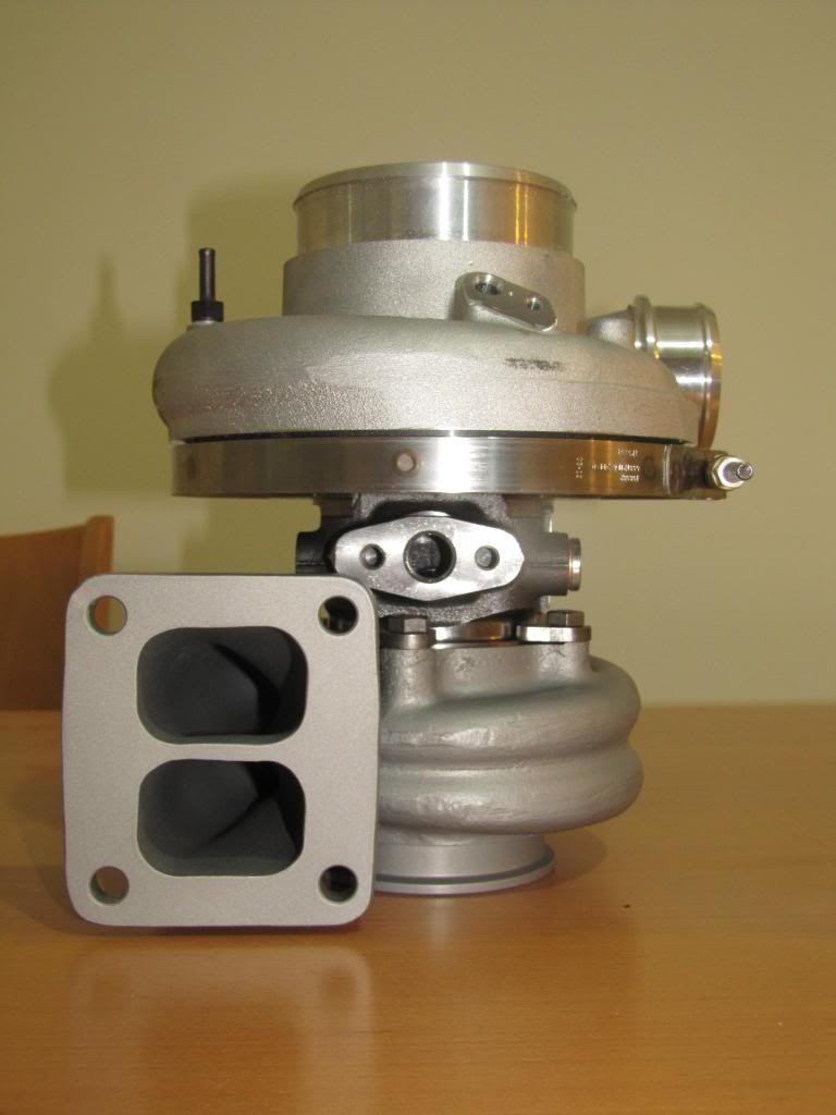

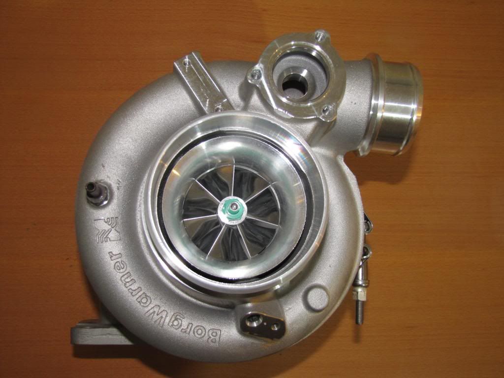

yes I will be installing BW 8374 EFR turbo 1.05 AR EW

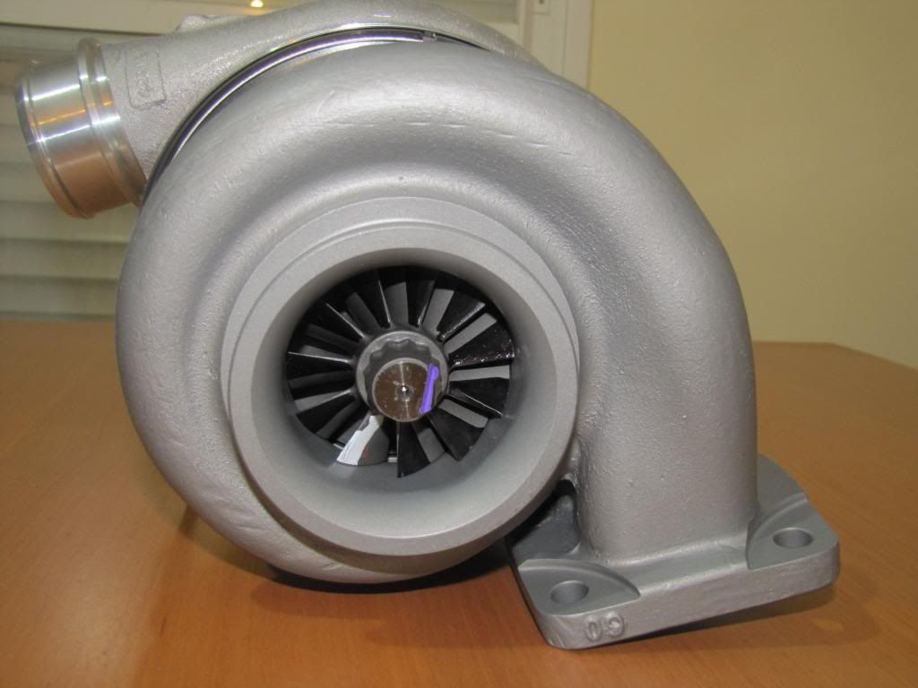

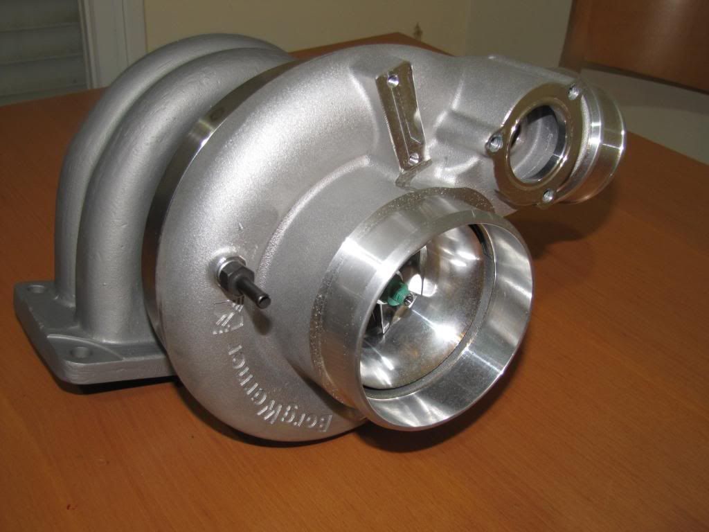

Turbo has finally arrived after two years of waiting for it, what can I say, I am not disappointed at all it looks awesome and the finish of the parts defiantly looks better that anything I have seen on any other turbo
And a picture of TOYO ...she is realy impressed with the Turbo ass well

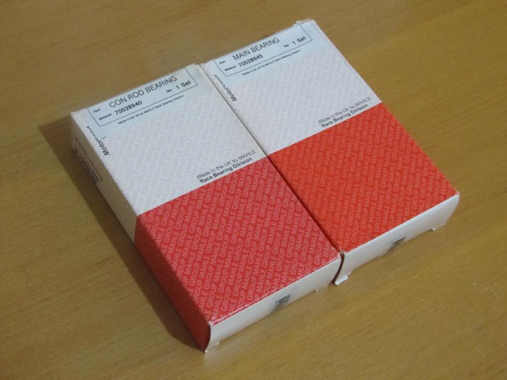

Vandervell Mahle motorsport racing bearings these are true tri metal bearings not the alleged ACL stuff

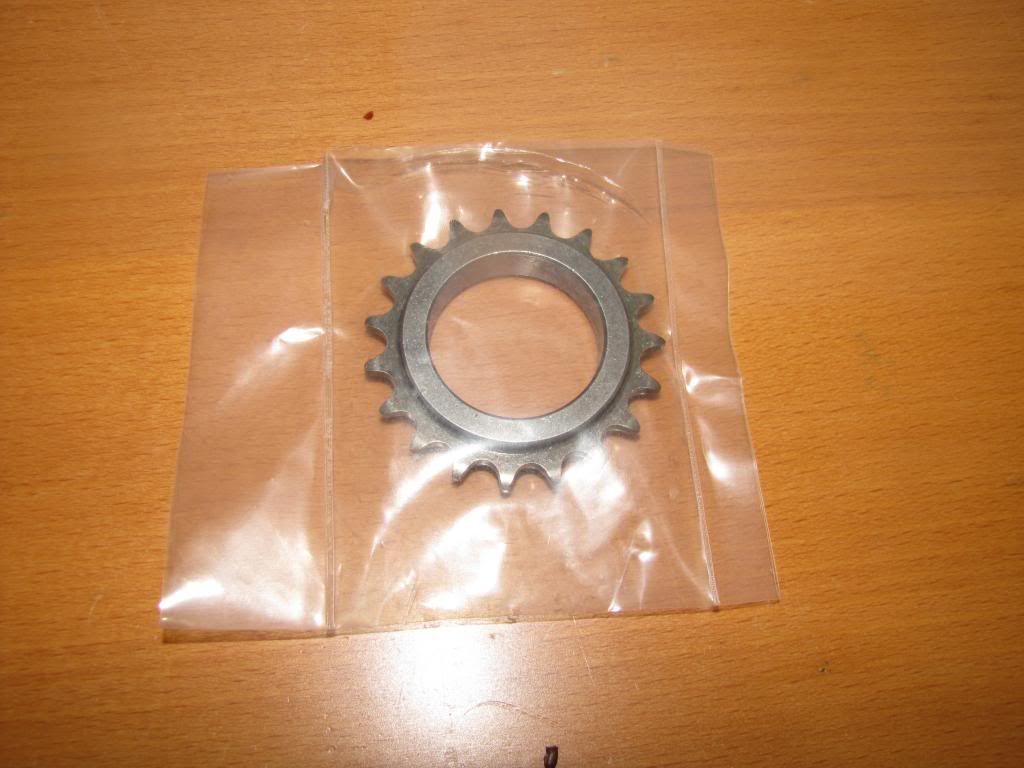

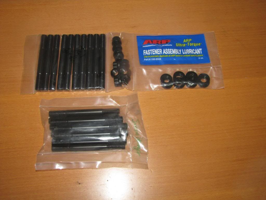

also got the crank gear and two sets of ARP extra long studs for the Engine girdle only thing left is to get two new pairs of oil pomp chains and add two links from one to the other to make it longer and that's it , except for a gasket set and all the oil return rings, I will start blueprinting the motor as soon as I have some spar time and hopefully in 3 months time in spring brake I will put the motor together
