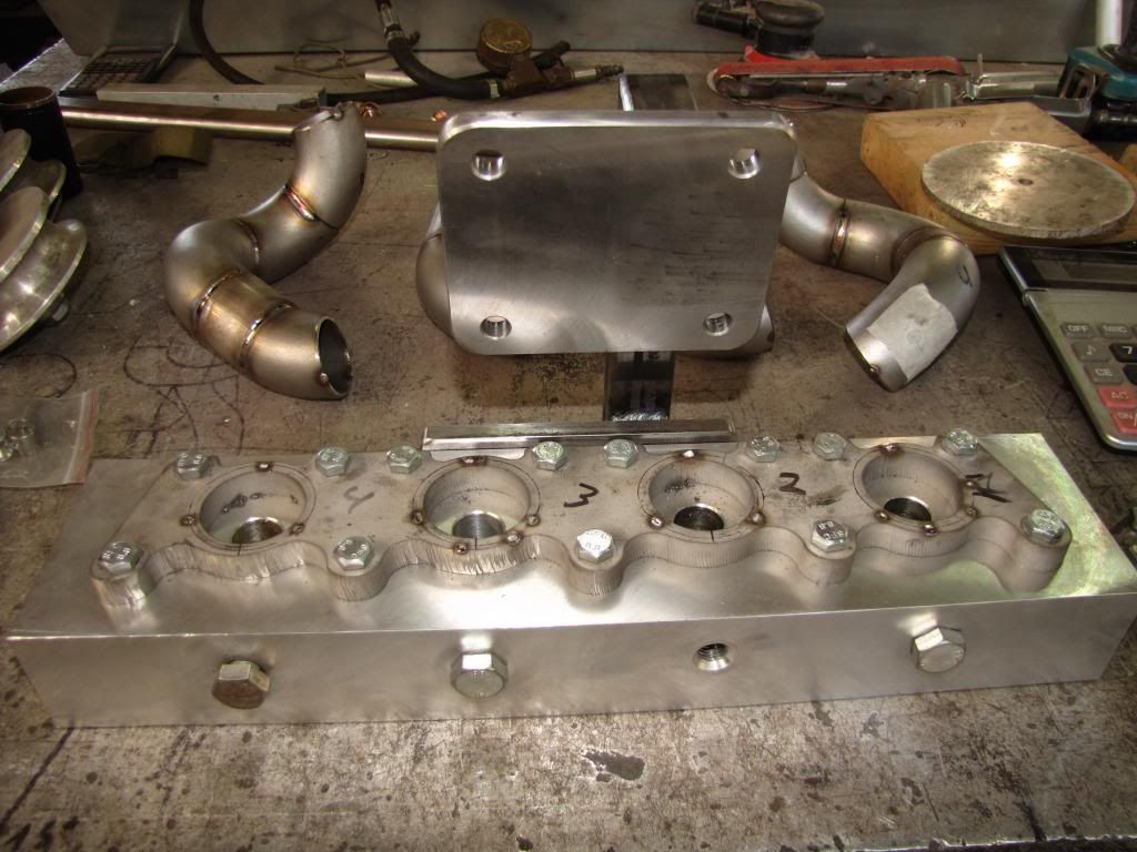

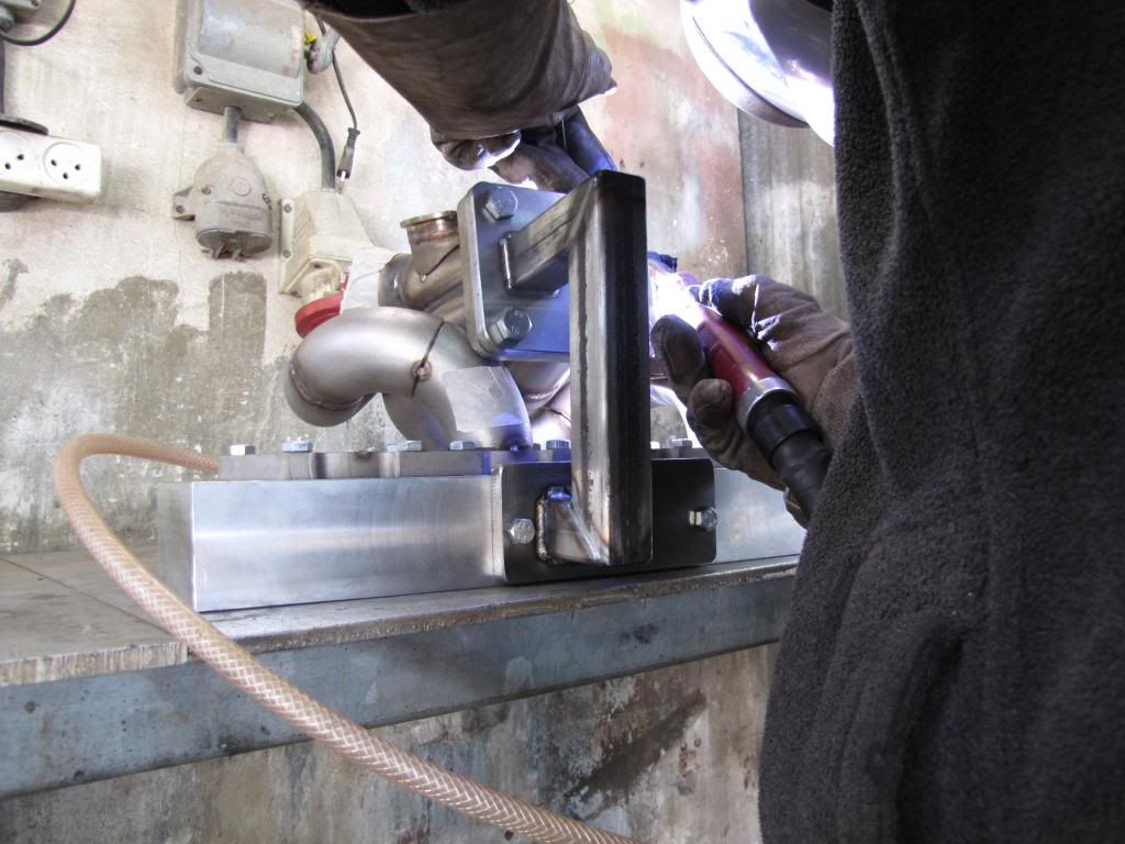

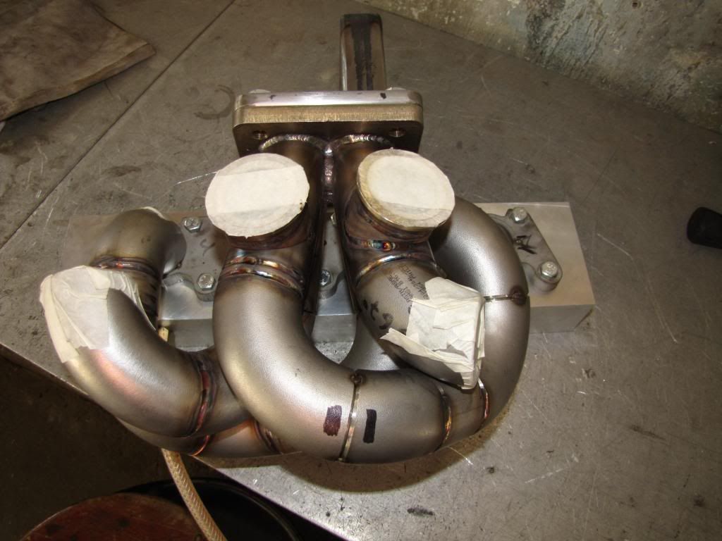

finished working on the "welding jig" today, we made provisions to insert the back purge argon into each runner individually. at the end of the day we almost finished all of the first run of welds but ran out of Argon gas in one of the balloons so more gas was ordered for tomorrow morning ,we should finish welding up the rest of the runners tomorrow and completely finish welding the whole manifold. distortion to the runners was eliminated by letting the welds cool before continuing to the next so there was no torque and all the runners fit back into their place after dismantling them this is also why we build the second jig in order to hold everything in place while removing the runners to be welded two at a time.
Thanks mates for all the compliments!!!

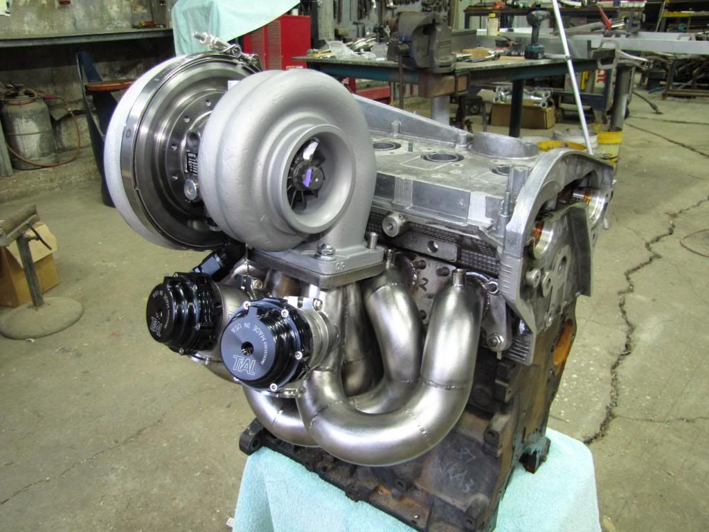

I had to make the Manifold as compact as possible in order to clear the transfer case that sits directly beneath the manifold and make sufficient room to possibly root a 4" DP, at least up to the driveshaft...I am almost sure that further than that it won't be possible unless I modify the tunnel and firewall a bit.
By the way if anyone is interested I will be mass producing the manifold for anyone looking to run a Twin-scroll Turbo

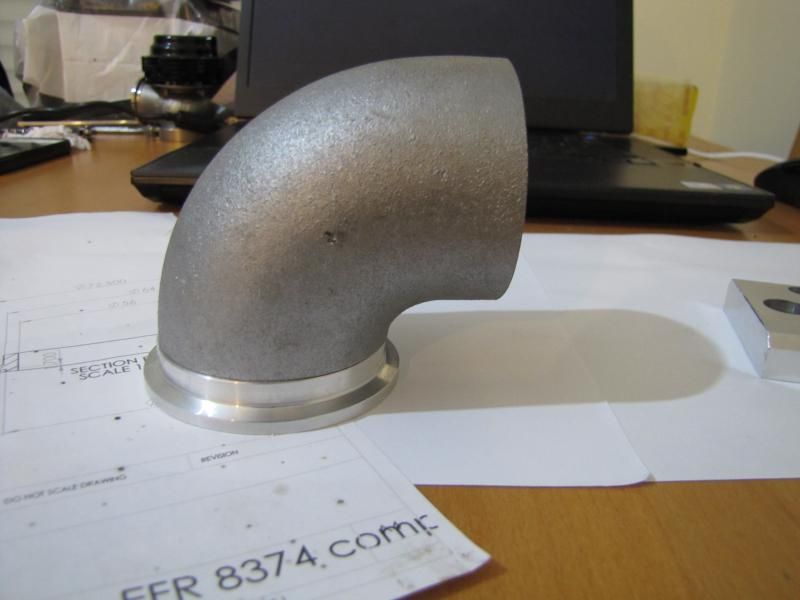

next thing on my list was the hot side charge pipe I sketched up the correct V-band flange and sent it to my milling shop to get CNC'd this has special dimensions as acquired for the EFR compressor housing. got the nipple shaved off of the compressor housing (sounds painful LOL) but couldn't finish of the surface because the drill bit wasn't long enough so a longer one will arrive next week.
you can see I am using a hard bend off of the turbo that will be welded to the V-band flange and the bend got cut back as much as possible to insure a low profile for the pipe and to clear the AN 12 breather hose fitting on the valve cover

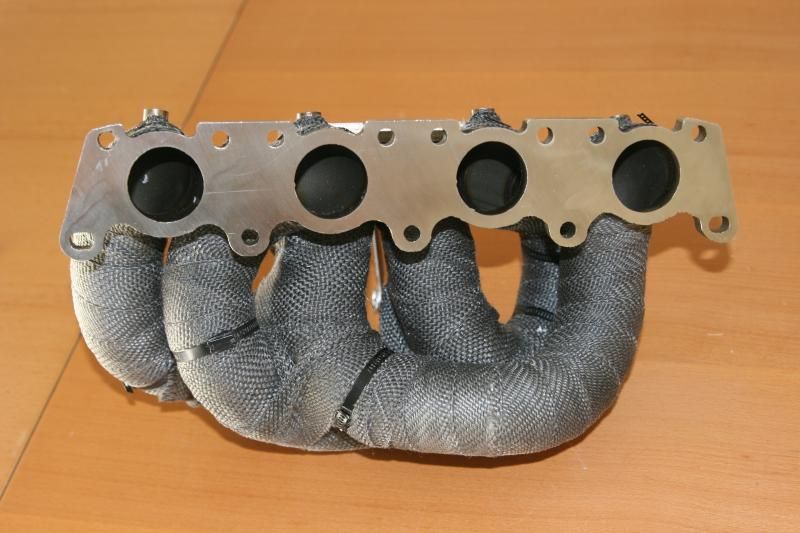

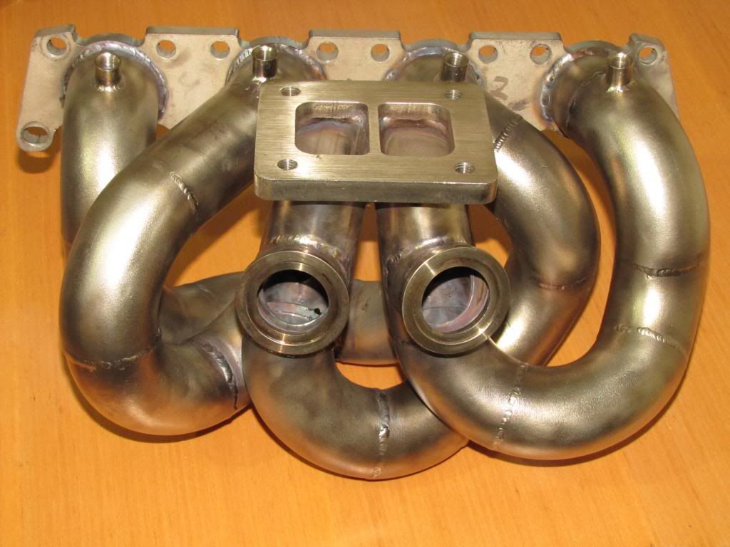

finished working on the turbo manifold ,got it back from the shop after having the head flange surfaced flat for optimal metal gasket sealing ,also got it wrapped up in the cool-it header wrap to hold in as much heat as possible

Top work with the manifold mate, looks proper! :)
