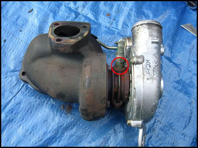

in laymans terms, what is the advantage of the oil restrictor in place (to restrict oil yes) but why?
To reduce the oil pressure entering the turbo, Most turbos only need around 30psi to lubricate the bearings, 1.8T sees over 60psi so pressure must be reduced to stop the bearings and seals from blowing. Big mistake IMO for ATP to sell these turbos without a restrictor.

easy to fit? guess its just a case of unscrew the oil line and screw the restrictor in?

Yes, undo the oil feed line on top of the turbo, undo the elbow going into the turbo, screw in the restrictor (the restrictor may well replace the union that is under the elbow, not as well as) then fit the elbow to the restrictor, refit oil line. Pic below shows where it should go:
http://i312.photobucket.com/albums/ll330/SonicBlueLeon/turbo02res.jpg
Oil pressure is different to boost pressure. I wouldn't hammer the turbo until the restrictor is fitted no, I am convinced that's what eventually blew my turbo. The only reason it didn't go sooner is due to being a non-daily driver and very low miles.
thanks Rob. I will leave it at 1.1 bar then till i get the restrictor fitted then.
