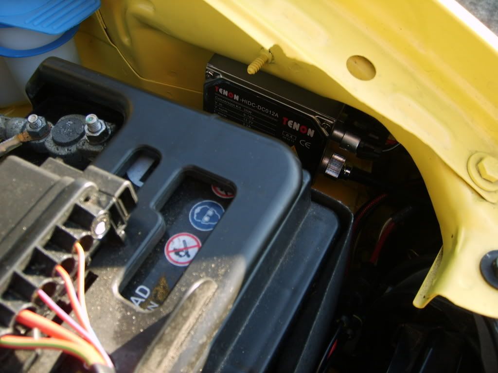

Joonspoon, Where have you put your ballasts?
Any pictures? :)
Probably a bit late now. :redface: Sorry I've been busy the last few days!
This shows the location of the passenger side ballast.
http://i108.photobucket.com/albums/n25/joonspoon_2006/Various/a0bfad02.jpg

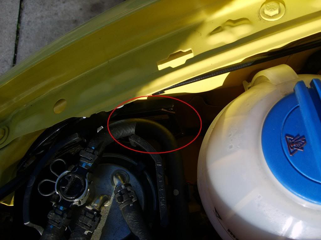

And this is the drivers side.
http://i108.photobucket.com/albums/n25/joonspoon_2006/Various/06a47e76.jpg
Fixed both with heavy duty velcro.
Before sticking the velcro I cleaned the panels with meths to make sure the velcro stuck properly.

joonspoon how did you manage to get the ballast in there on the drivers side, i tried for a good half hour and got really pissed off with it.

Re the ballast on the drivers side, I stuck one part of the velcro to the ballast.
Attached the other part to the velcro on the ballast.
Fed the ballast through.
Used long nosed pliers to remove the backing tape before pushing the ballast into place.
Hope this helps.
Guy.
i emean how did you physically get the ballast there, i tried on mine and there wasnt enough space, did you go round the back of the light in between the case and the fuel pump, take the coolant bottle out of the way? mine is too big to fit throug hthe available gaps
I fed the ballast (with the velcro already stuck on) in from front to back between the pump and the inner wing.
Could be that your ballasts are a different shape or size to mine. :shrug:
Guy.
