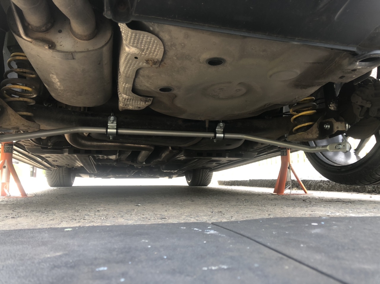

White-line Rear Anti-roll bar added

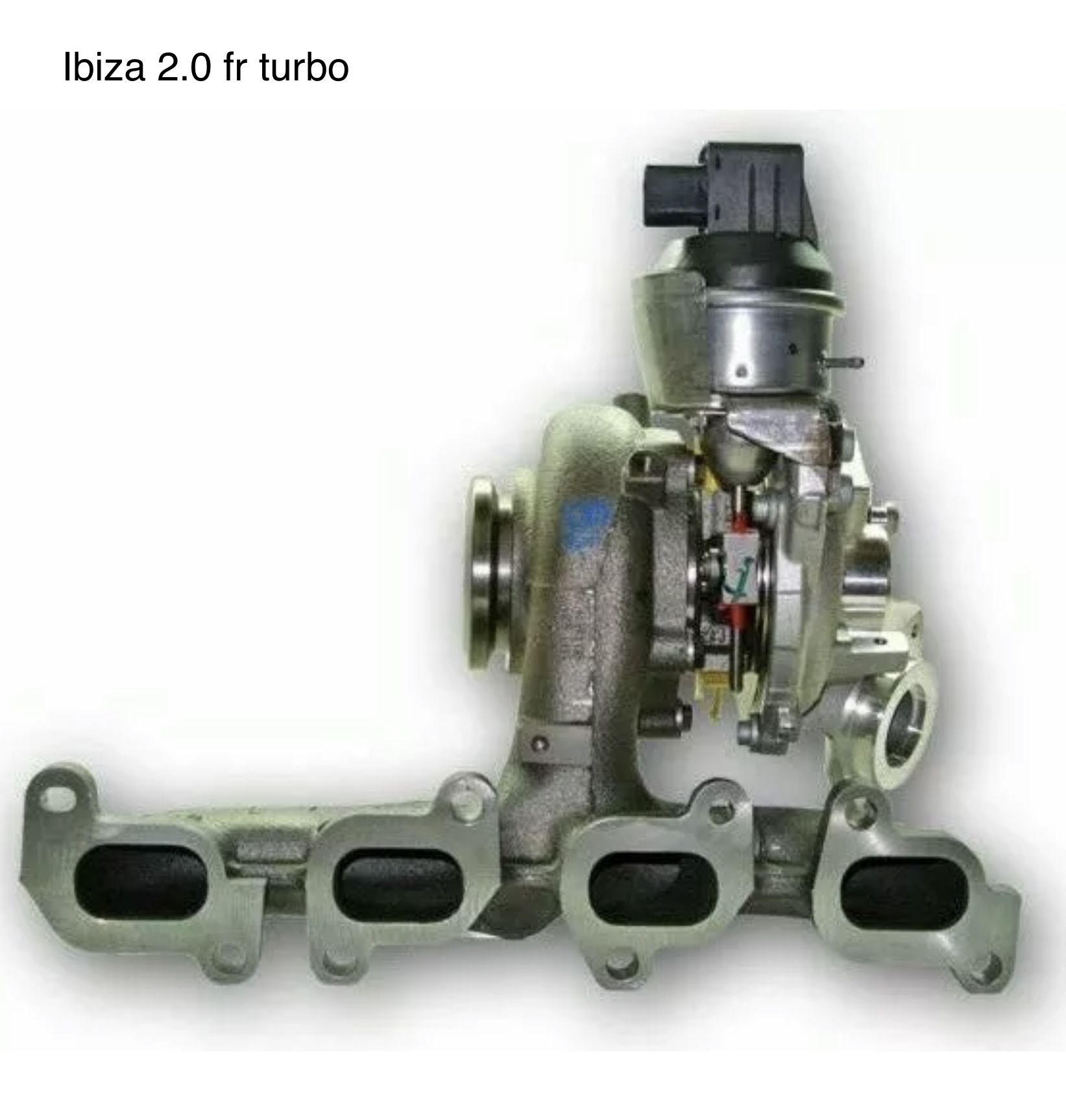

You can try the oem turbo 04L253056M Standard on Passat Tiguan cr190 it is straight swap with few mods on intercooler piping and water cooling pipes. It is capable for 220-230 hp with no loss at low revs and keeping the cost much lower than going hybrid

The turbo is oem on Audi q2 and VW tiguan with 190 hp 400nm and 210-220 hp are Easy to reach but it might be you will need better flywheel and front brakes 312 mm from tt mk1 and intercoller if you drive it hard if you want to have more power a dpf delete and a straight pipe are the solution

I forgot the lag is not to mention since it is oem it is almost the same at low revs because it is the fastest spooling single turbo and pulls much harder up to 4200 rev. I think it is the best value for money turbo. Avoid the 184 from golf a3 q3 it has different behaviour

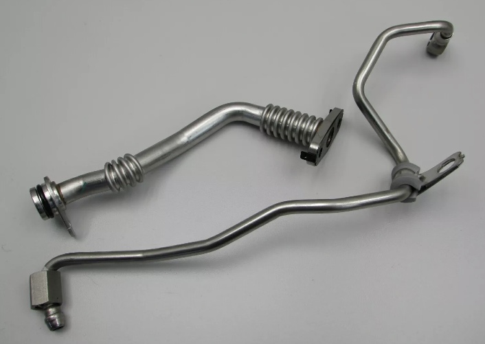

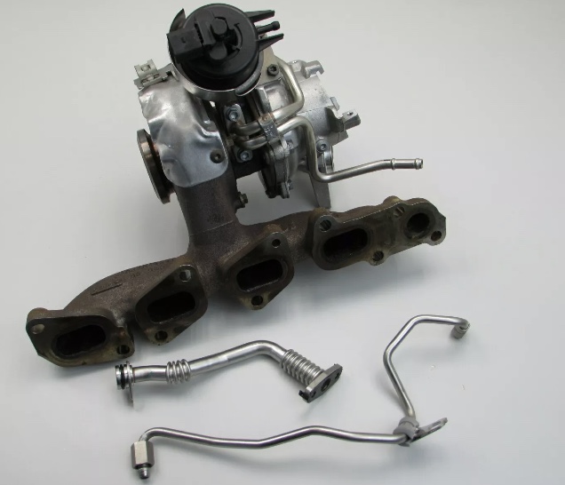

Water pipes need to be adapted because the new one has also watercooling pipes ( can be bought together with the turbo)
Intercooler Pipe just soft mod to fit on the new turbo.

So them pipes just replace the ones currently on the car, to fit the new turbo? No custom fabrication or anything?
Small custom fabrication is required by your mechanic because the turbo you have now on your car does not have any water cooling Pipes, the existing turbo is not water cooled . You need to adapt these 2 pipes on the existing watercooling circuit of your engine.
Yeah, I did wonder that as I knew the oem turbo is not watercooled. Where are the new watercooled lines connected to?

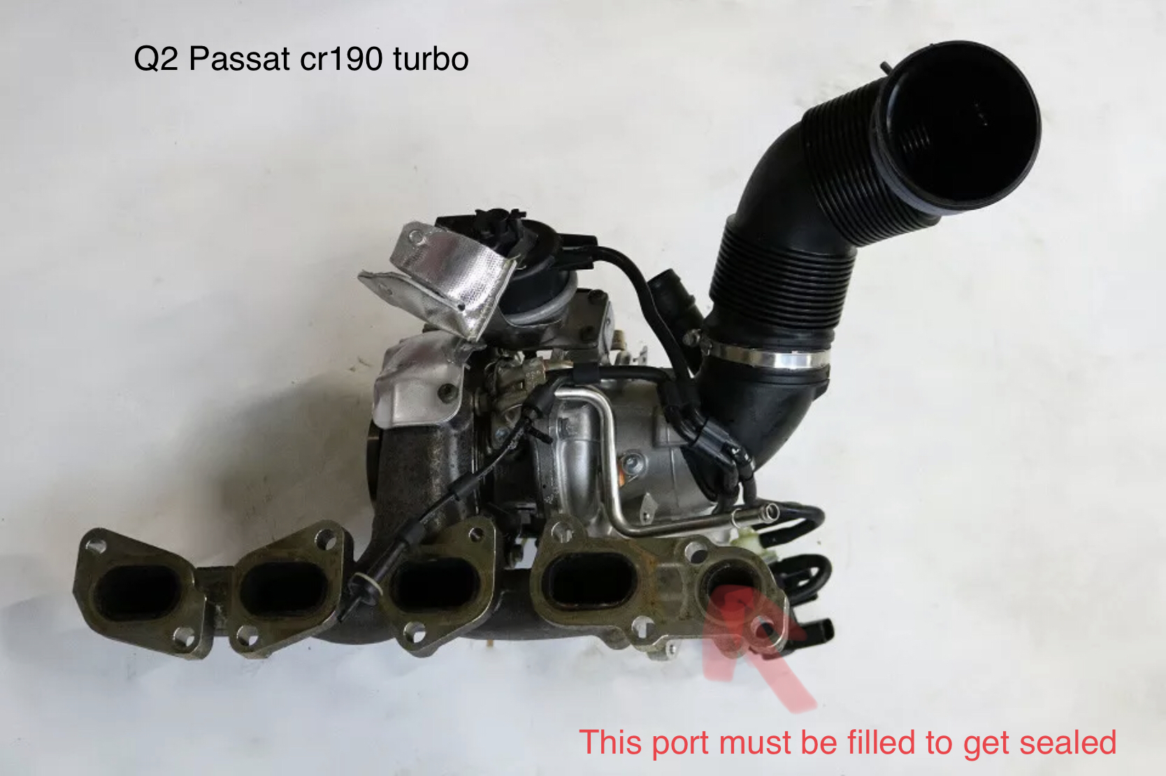

I forgot to mention that on the new turbo is a hole normally for recycling gasses that needs to be sealed.
Air Intake Temperature 4bar MAP Sensor 03K906051 Bosch 0281006059 is also required.

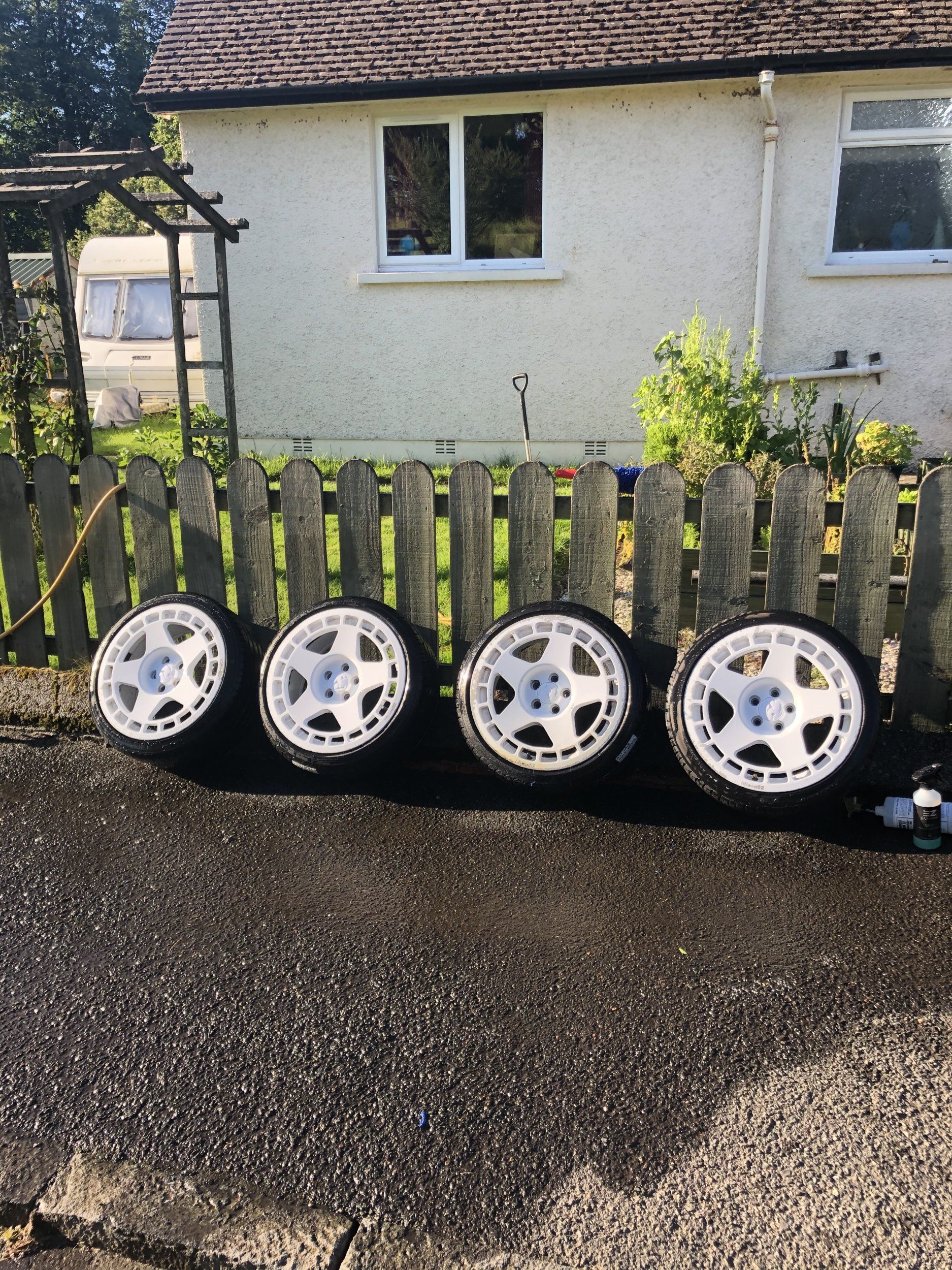

Sooooo it would’ve been rude not to buy the wheels from it then, and that’s just what I’ve done! Fifteen52 Turbomacs
Do need a refurb, and one of the tyres has fire damage but I got them for a good price and can’t wait to see what they will look like on the car. Had someone photoshop them onto the car and shows the look I’ll be going for. Unsure on what colour to do them but here’s a brief look on the idea
