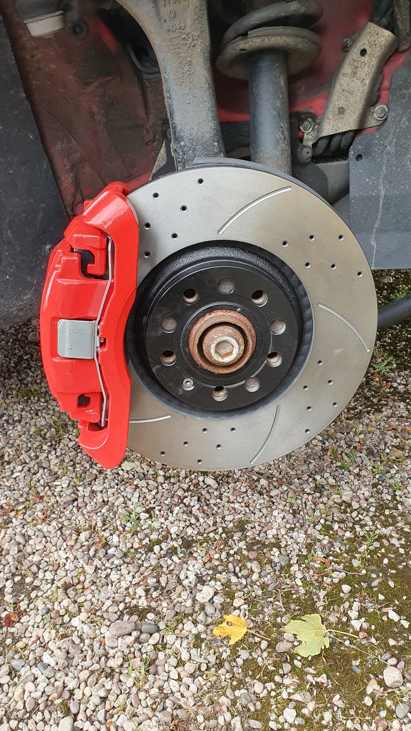

I've just fitted some bigger calipers off an
A4 tfsi rebuilt them and painted them up chuffed with them
