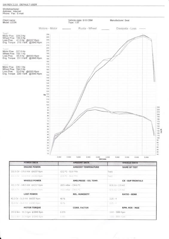

Here was the standard run; this was with the Milltek only so I class as standard..
229bhp, 219lbft

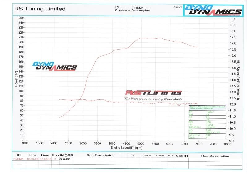

This was with the Milltek, downpipe and decat on a standard map, power loss could have been through not being mapped for it, or for the faulty DV it was later found to have just before the remap.
216bhp, 196lbft

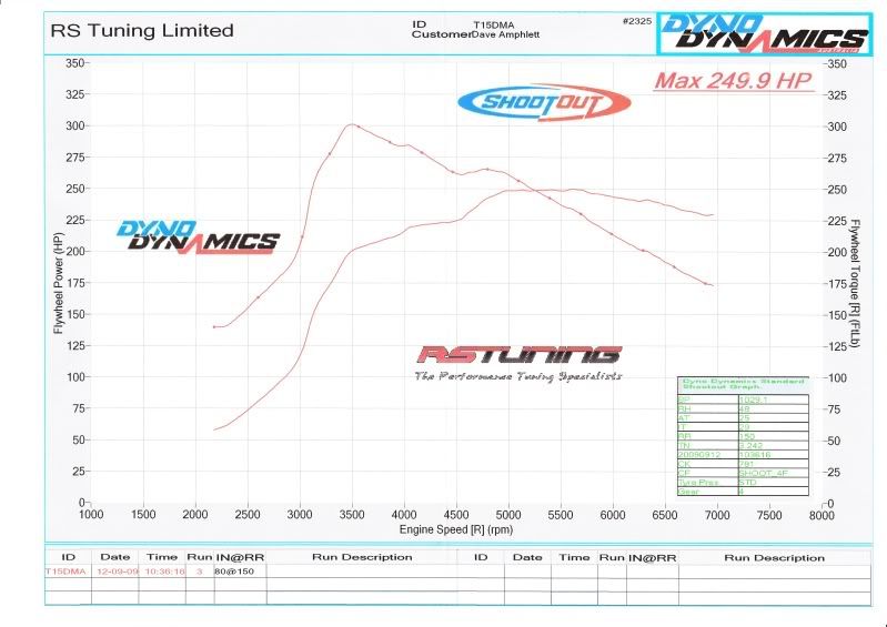

This was after the APR Stage 2 and (we think another) dump valve was faulty which lead to the following results:
249bhp, 300lbft

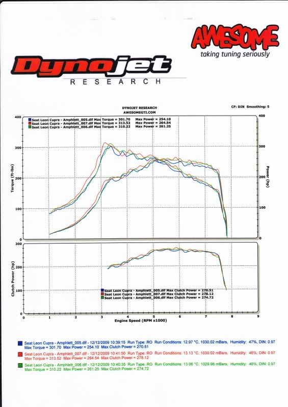

Which leads us to the final graph from Dec 12th which was including the TIP, 007p and Forge FMIC :D
278bhp, 313lbft
Yea much more like it dave same BHP as mine got. just need that torque bit higher, then start pulling caravans about
like a diesel
