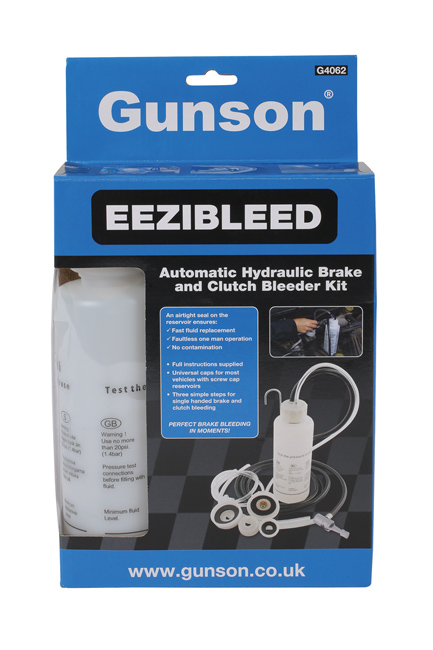

that Gunson Eezibleed setup looks very good, post back your thoughts on this, will have a look at a few reveiw vids i have seen on this as well.
just had the front discs done and pads the brake system was bleed at the front and Paige Brake fluid was used but one of them vacuum bleeders were also used and it did not just take the line fluid out , rears will be done when needed.
