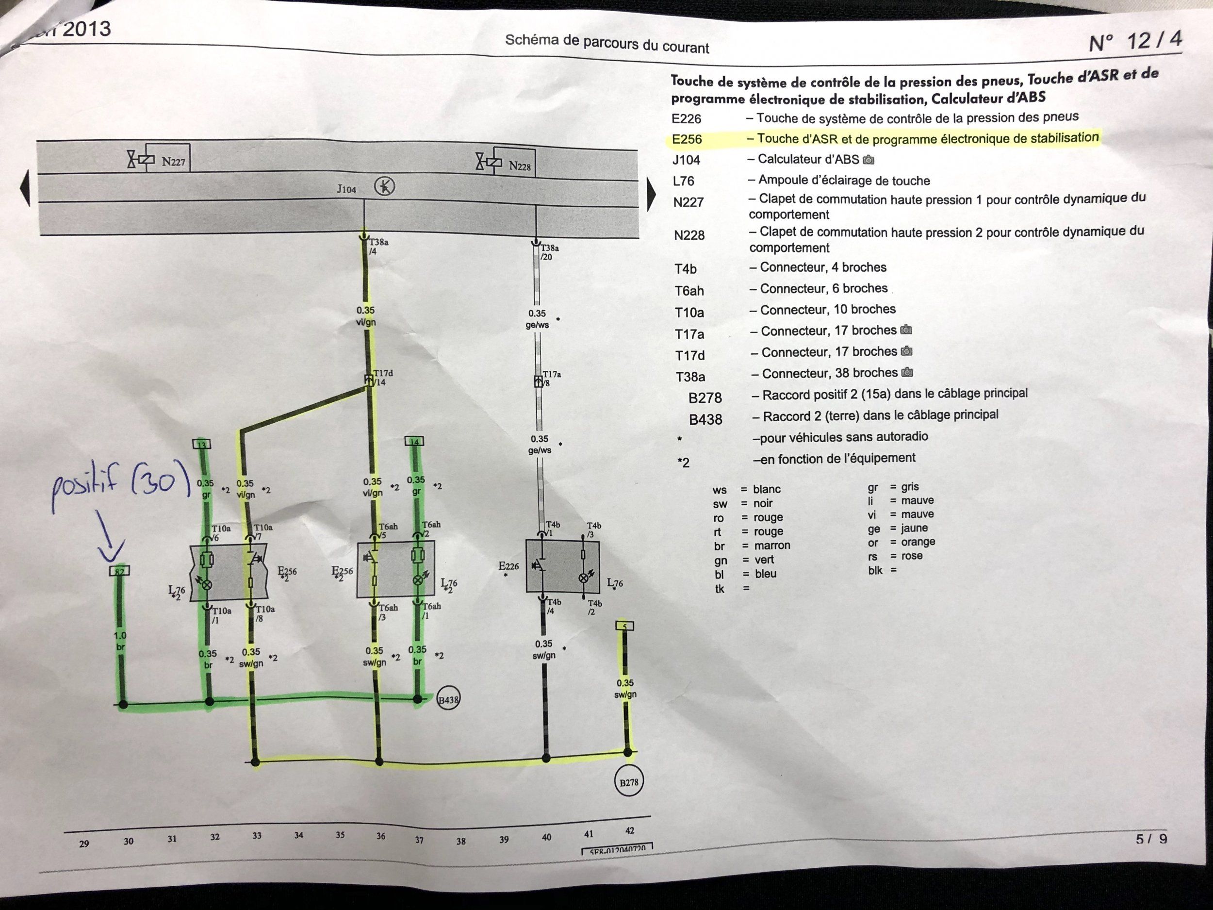

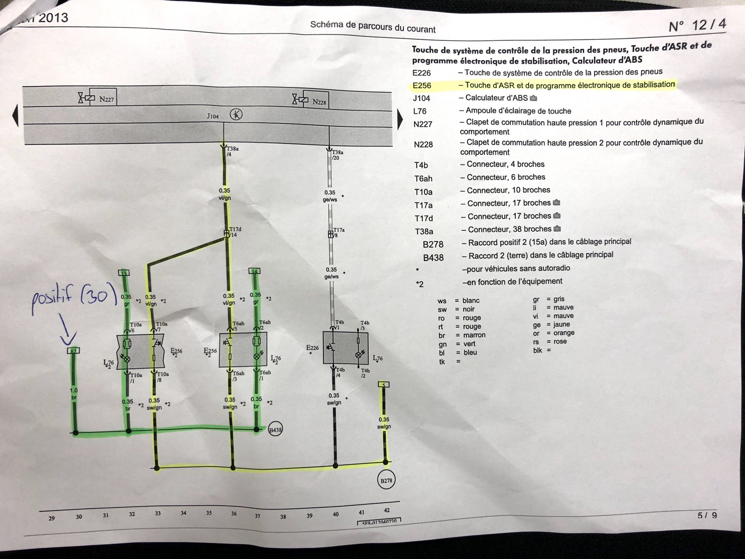

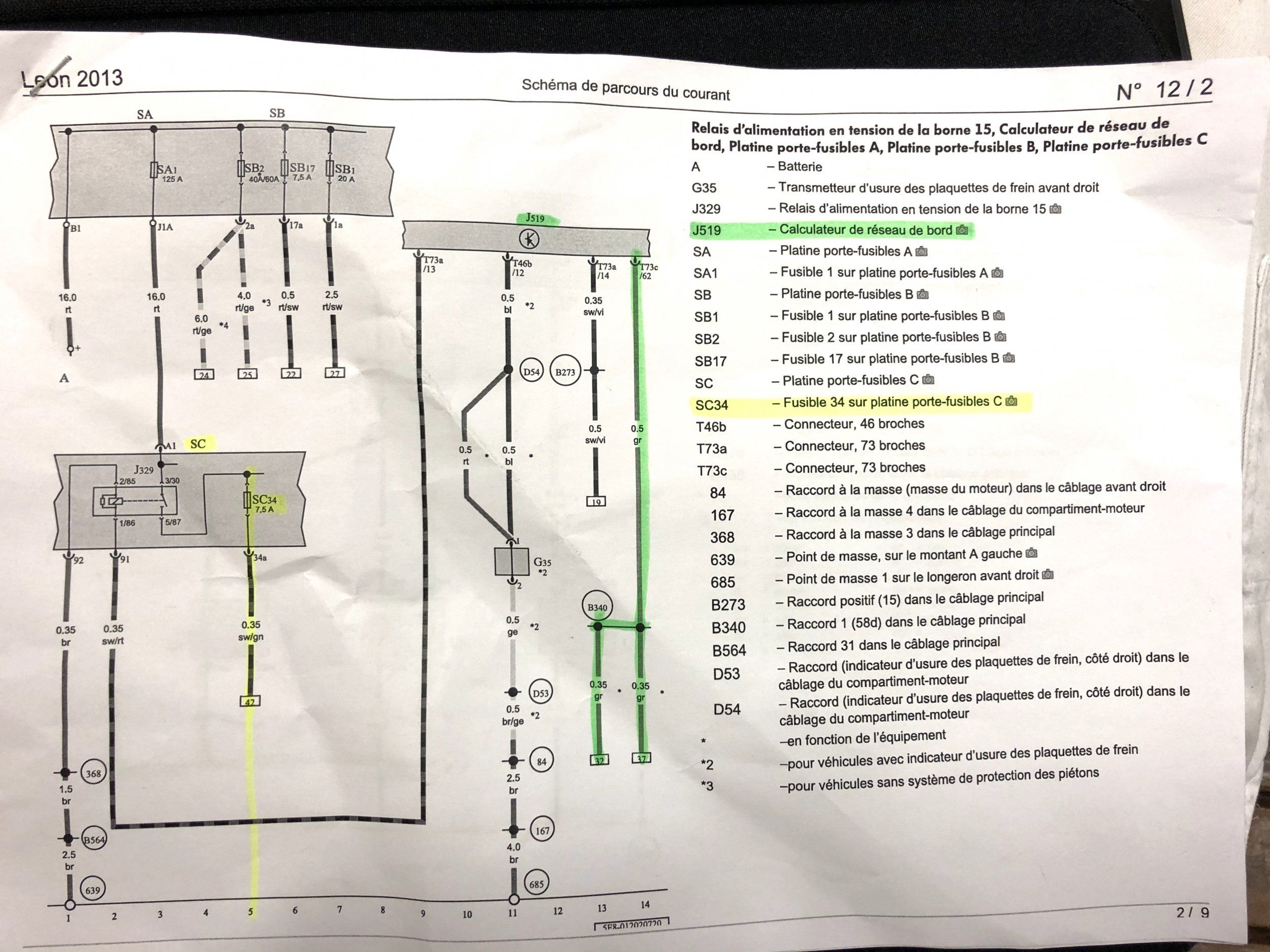

He is a mechanic friend who worked outside of these working hours. Here is the diagram he made and the result activates or deactivates the Start&Stop ... Do you think you can help me? Is it really without the need for coding? Thank you in advance ...
View attachment 24095View attachment 24096

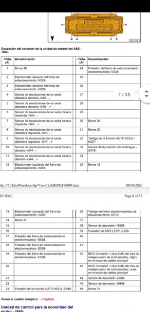

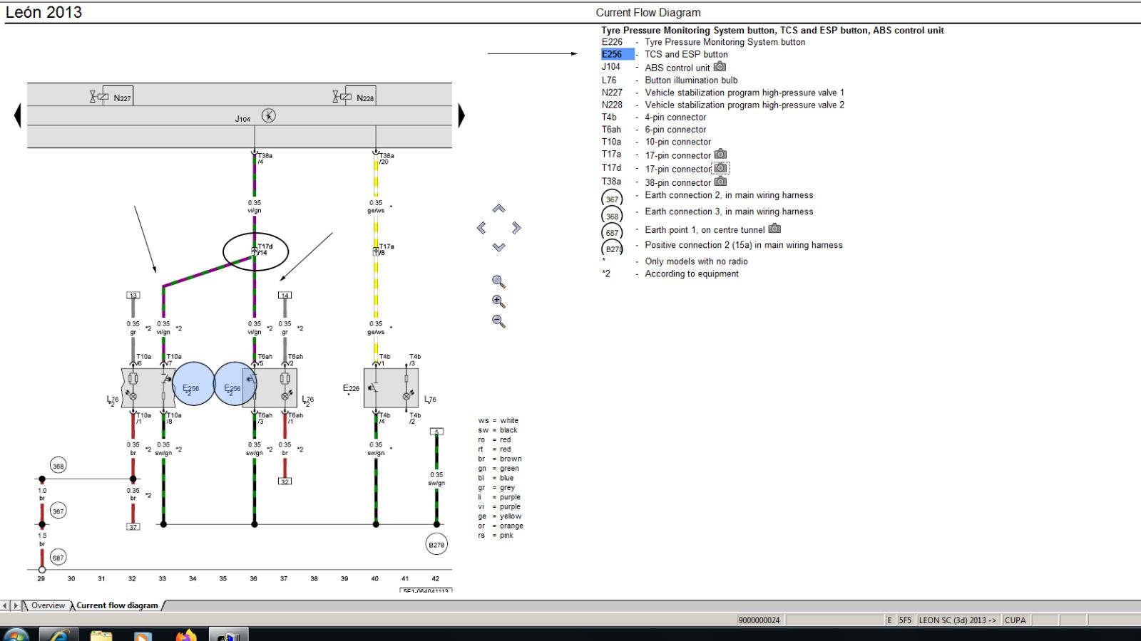

I don’t think that you use the right scheme. As you can see in the earlier post i add the scheme. The button should be connected to abs connector near engine. For leon exist two different connections. You need check your abs in some cars it’s should ve connected to pin 3 and in another to pin 38 as i remember.
the esp button dont have any connection to start stop
We tried again today. We still haven't succeeded. The colors are different, the numbers are different ... There are so many possibilities ... we will do some research. The manufacture is different between each country as well as the years of manufacture ...
in ELSA i saw only two ABS schemes for 38 and for 42 pins which one you have ?
because the connection for this is different
So if i understand correctly, if I have a purple/green wire going to the pin 5 of the T17d then it's ok? If so, maybe i can try sending a 12v signal to it to see if it turns the ASR off. What could go wrong? :ROFLMAO:
Edit:
if there is not any cable, i just have to pull a cable to the ABS controller pin 39.

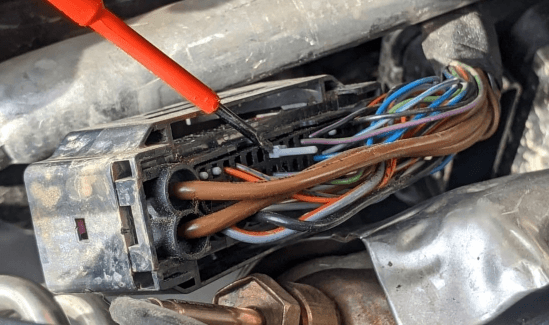

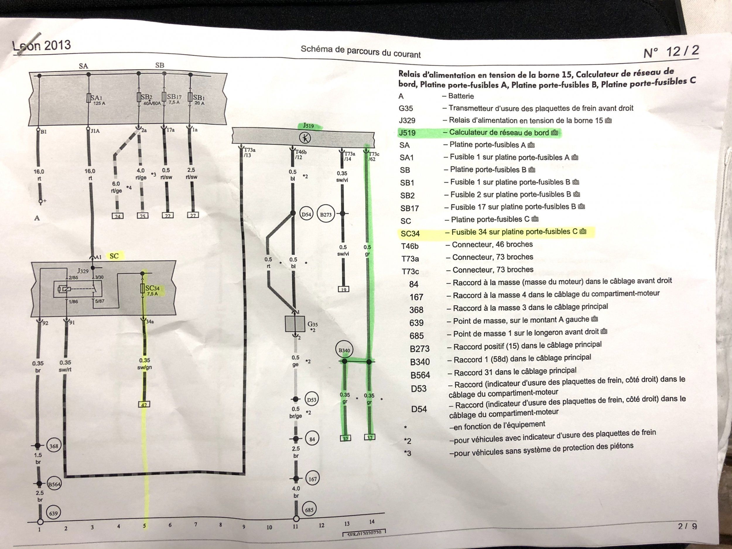

Just connected mine. And it's working. I will make a tutorial but for now. You buy the switch, 4pins (2 cables) for the switch and one for the abs cable. Then for my 2017 model I connected:
Pin1 of esc button (red connector) to pin 1 of start/stop (black connector)
Pin6 (red connector) to pin 2 (black connector)
Pin7 (red connector) to pin 39 of the abs connector (if you have different connector from the picture from my above post, it's probably the 38pin connector and you have to use pin 4)
And pin 8 (red connector) to fuse 34.
Oh yeeeess, finally the button works. I dropped off my vehicle at an automotive electronics professional and it works. The colors of the cables and the plans are completely different between countries. My car is Swiss, made in Spain. Nothing matches. I don't know how he managed to finish the hookup but it works. Thank you for your comments and your help :)
