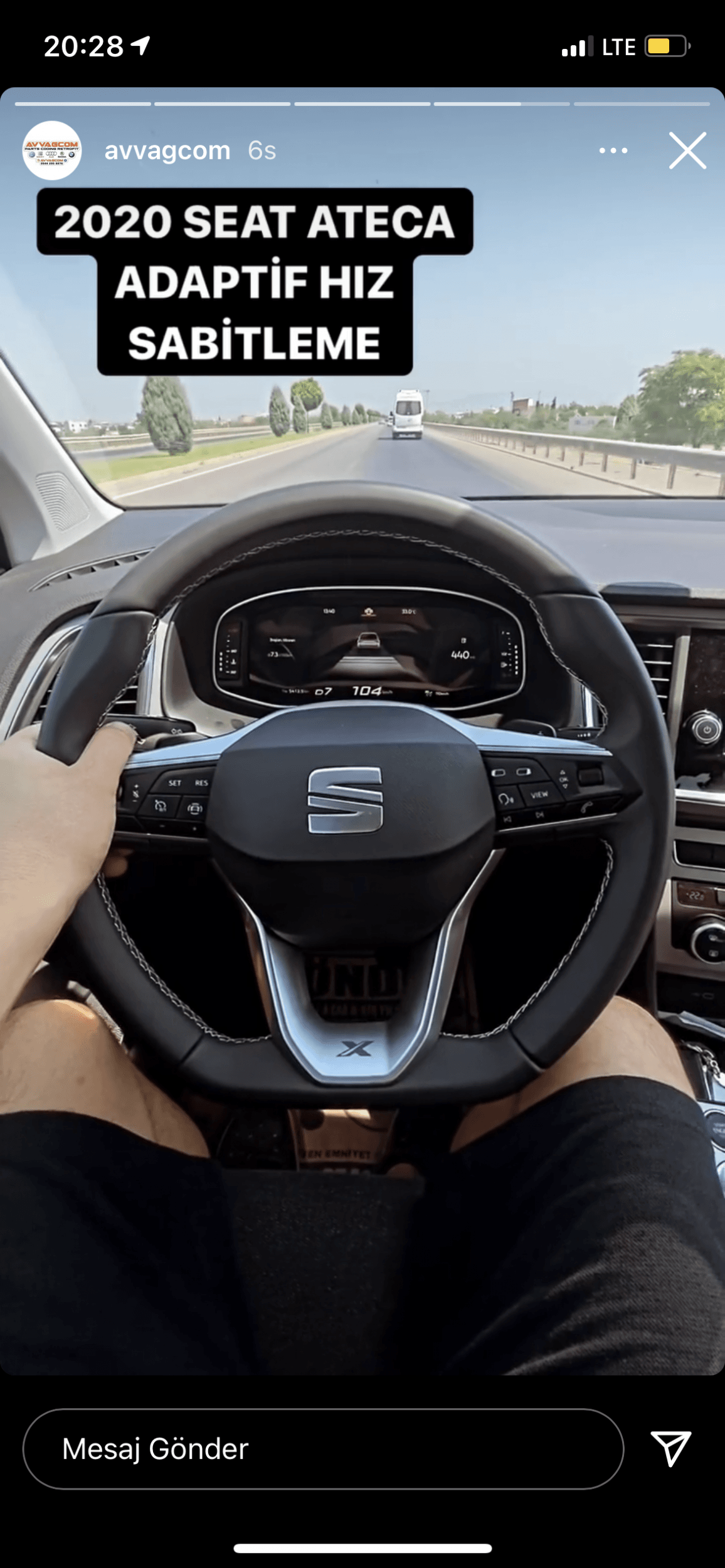

Most accessory shops in Turkey activate this feature, has anyone tried it for Leon without changing the steering wheel?
Well, so far the main thing is to be able to remove the warning to take over the steering wheel and no one found how.
but you can activate adaptive lane guidance which is pretty much like travel assist
It could be the lane assist I saw, I'm posting pictures of it. Turns on feature as adaptive cruise control
