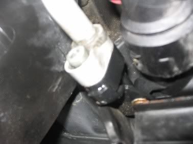

Hi Folks,
MY 02 Cupra had developed an oil leak on the passenger side just in under the front bumper. I have taken the plastic plate thingy off to have a look & it seems to be coming from a metal pipe going into what look like a second radiator. As you can tell I'm not all that technical when it comes to cars. any ideas what it is & how much I'm going to have to fork out. Or is it something I could do myself. I have included a photgraph to help out with the diagnostics !!

Thats an air con pipe mate. There is a rubber 'O' ring in the connection. You would have to get the A/C discharged of gas to split the connector and check the 'O' ring. If its leaking oil through there then the gas will be leaking also i would have thought. How cold is the A/C when its on?

Yeah, there is an O ring on the connection in the pic above. They would have to de-gas the A/C system and undo the bolt securing that connection. Once the connector is off there is a little O ring on the connector. It wouldnt surprise me if you had to buy the whole pipe just to get the O ring! Not a big job at all mate. Maybe an hour tops to check the O ring.
Why do they think its the compressor thats leaking? That pipe in the pic is no-where near the compressor?
